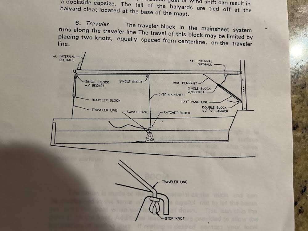

The traveller block obviously connects to the traveller line above the tiller. The block can move right to the edge of both sides of boat. Is there some mod to restrict that traveller block going that far to the side. Or am I just being a bit anal in my over thinking for my rec sailing? Thanks

This boat does not have a track for the traveler. The mainsheet block runs on a piece of line, and the apparatus cannot be controlled in the same way as a track style traveler. So the only purpose the traveler has is to give the boom some stability. Angle of attack (the primary function of the traveler) is thus controlled by the vang and mainsheet. In this set up, limiting the range of the traveler is necessary to give the operator precise control of the mainsail and boom position.
I sailed a Laser in my younger days... you know, 40's and 50's (heh, heh,) and our "travelers" were set up like that... just a line with a stopper... eliminating the track is necessary because it would interfere with the tiller.
To answer Oldschoolguy's question, In the image of the owner's manual he posted, item #6 recommended tying stopper knots in the traveler line to restrict the movement of the mainsheet block.

Ha, Ha...... YES. Remember, you asked. The owner manual page you posted suggested tying in stopper knots, Go check out REI or some other outdoor sports stores for some inspiration.

. I am going to try moving the 2 knots closer to the center line 3” or so. That should help with a tack closer to the wind correct?
Yes that's one way. In fact, isn't that what the owner's manual you posted suggested? What might be even better is to simply add a control line to each side and install cleats for them near the traveler line's anchor points. You could even add a small block to turn the line forward towards the helm making it easier to adjust. No purchase necessary. What you end up with is movable stoppers controlled by the cleated line, rather than tying knots in another line.

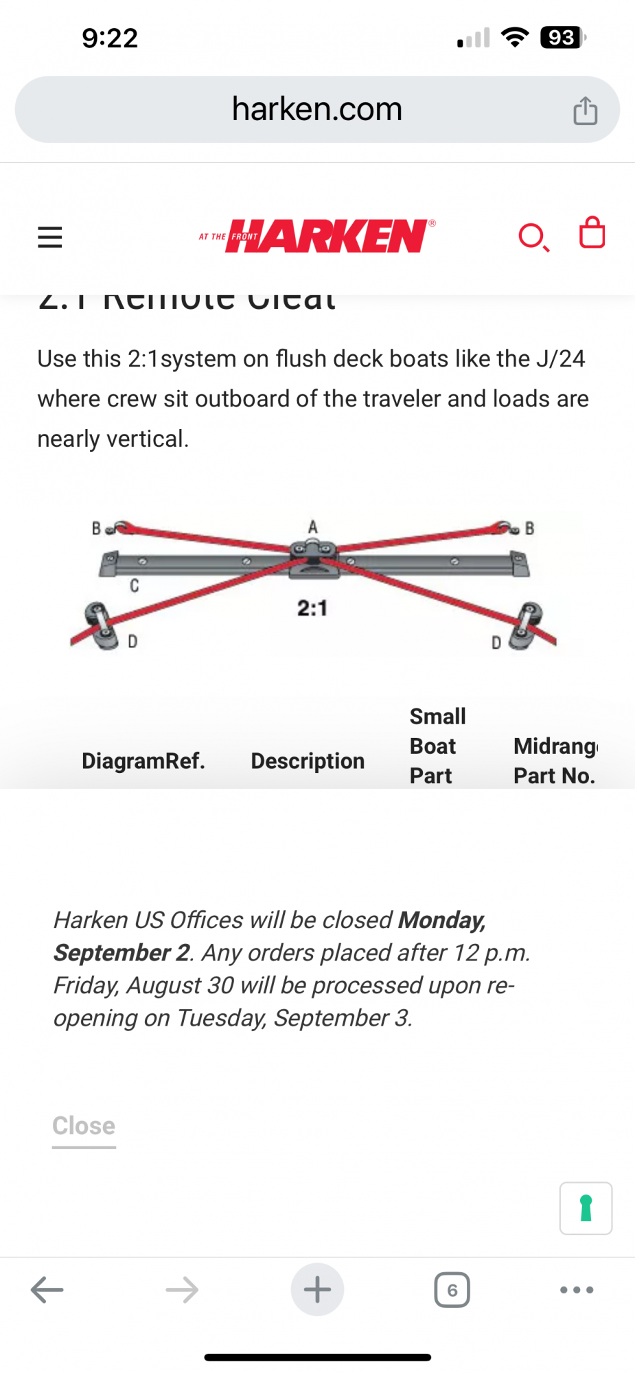

Maybe a setup with the same principals as this without the aluminum slide. ?
Joe
Jun 1, 2004
8,357
That will work, of course, but I was thinking of it being even simpler. Just one line per side, no purchase. You can put a small block or a plastic fairlead near the traveler's anchor point to guide the line forward to a more convenient cleat location Time to be creative.
