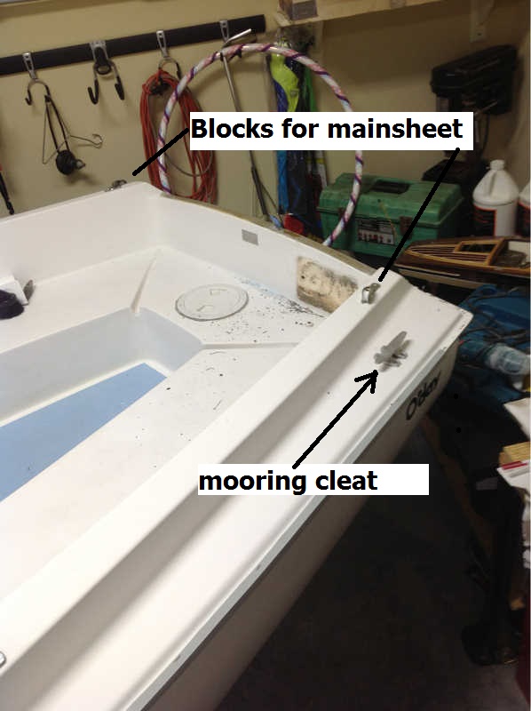

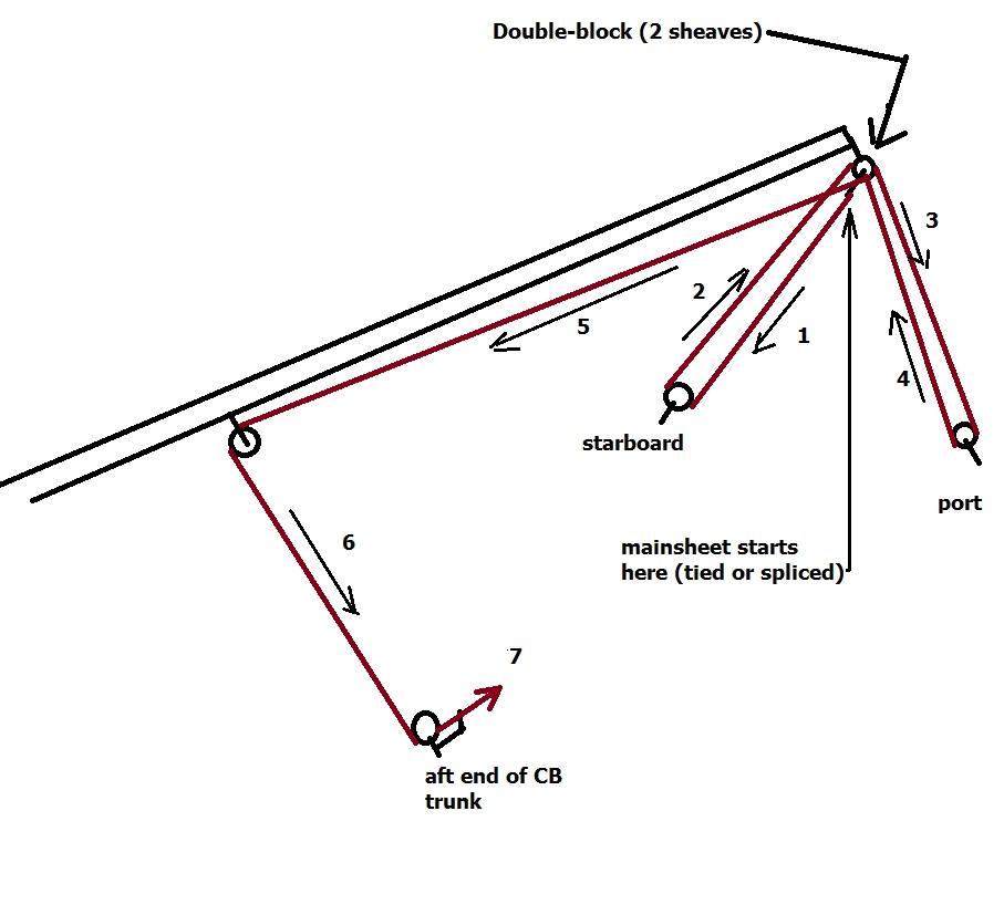

The MARINER did not have a traveler! Those blocks are for the mainsheet and the cleats are the aft mooring cleats. I don't know if I have a picture of the Mariner mainsheet. I am assuming that your boat is1973 or older? If newer, those block may be for a Spinnaker? I sketched up a drawing of the mainsheet rigging, any MARINER owners that want to chime in with a correction, go ahead. The newer ones (1974-79) had mid-boom sheeting, but then most likely would not have those blocks near the stern on top of the cockpit coamings.

Thank you schart (and everyone else) that Oday manual matches mine exactly and, I actually had it rigged correctly.
