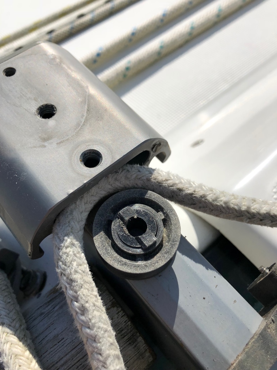

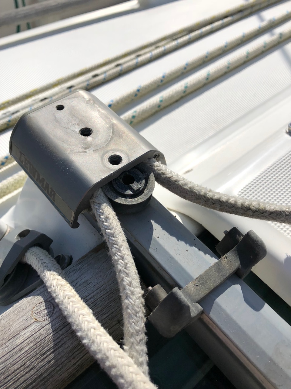

As with anything, trying to take a quick picture of this turned into a more lengthy process. Yesterday was pouring buckets, but I did get things apart today and here are some pics.
The center car part in mine moves smoothly by hand, but when under any sort of load, those end bits do nothing at all. I'd love to just find a replacement piece for the end, but I'm OK replacing the car assembly as well. I don't want to remove the whole traveler track if I can avoid it.
The short answer is that there is a sheave inside the end. Pics below.

Steve,
Those are great pictures and thanks for doing all that work. Do you think there is any good way to upgrade the blocks/sheaves to double blocks on top of the car and the ends, or is a replacement for everything except the track the only feasible option? I also notice the standard line looks really tight in the end blocks.
I'm not 100% sure, but the thru-screws that hold the sheave in question could probably just be lengthened and another sheave or something similar added on top. The traveler would be a bit more difficult since it already has stacked sheaves on it, but I am sure someone makes something that might work.
When I'm back tomorrow morning at the boat, I will see if I can get some measurements for the track and figure out if there are kits from Garhauer or even Lewmar that are still made and what the options are. The track has sort of a beveled edge to it, which is different than other tracks I've seen.
For sure, this rope needs to be replaced with something a bit smaller and not so old! I had thought I did that but I was thinking of the vane and mainsheet. I'm not going to jump on that until I see if we can upgrade the whole thing for more power...

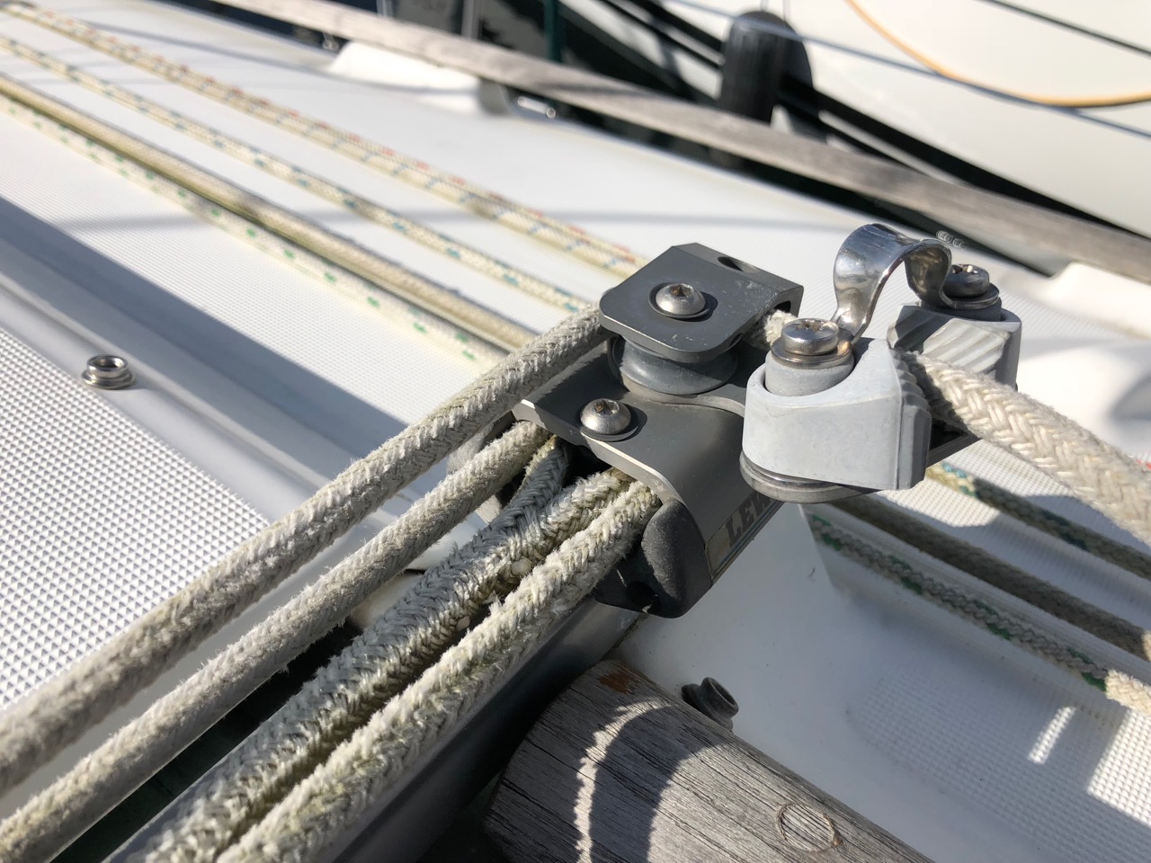

Looking at your second photo, I can’t understand why that eye splice is there. I would have thought that splice would be shackled to the car. There is so much line in that end that it apppears to be binding causind even more friction. You already mentioned that you know the line is too big for the sheaves as well.
Yeah I have never understood that way of running the lines either. It is not helping when you have the car near one end or the other - everything gets very tight and grumpy.

Looking at your second photo, I can’t understand why that eye splice is there. I would have thought that splice would be shackled to the car. There is so much line in that end that it appears to be binding causing even more friction. You already mentioned that you know the line is too big for the sheaves as well.

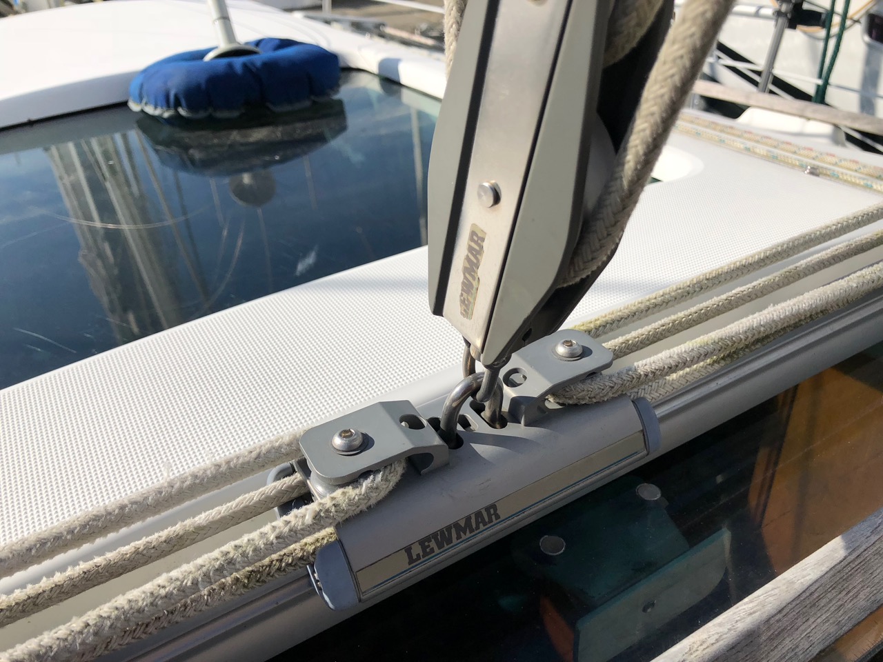

Doug, the eye splice is at the traveler end rather than the car end to enable the purchase to be 4:1. If that length of line is taken out, then only one sheave at the car end would have a line around it the purchase would be 3:1. But I agree that everything is very tight and is probably binding inside the traveler end. I wonder how well it worked when it was new in 2000?
If the snow and sleet will ever quit I'll run out to the boat and take it apart and try a much smaller line just to see what the resistance and drag is. It might get above 40 this weekend, but they've been saying that for a couple weeks. Puxatawney Phil was right this year.

The Lewmar traveler does not need that large size line on a 31’ boat, go down a size and keep fresh, unworn line in the system. You should be using a two-hand technique for adjusting the traveler to prevent rope jams.
I'm sure it would work better with new rope, which it had at one point, but it still is woefully undersized purchase for such a gigantic mainsail. Two hands won't really solve the issue. I suspect that is why a similar sail-planned boat, the 323, has a better purchase system.

I found a link to a Lewmar catalog that shows older traveler hardware in exploded parts diagrams. The end stops and its internal sheave can be clearly seen on pages 14-15. There is no clear diagram for the the traveler car, but there is a Size 2 genoa car on pages 12-13 that appears to have the same base. The size of the sheaves and the center hole are not listed, although parts numbers are listed. (I searched on the Lewmar site for the sheave part number but nothing came up.)
https://www.lewmar.com/sites/default/files/Ocean Spares Data.pdf
I
also found new Lewmar double sheaves and cam cleats that look like they would mount onto the end stops, SKU LW29172014, $132 each at APS, but for that money I might as well get the upgrade kit for $500, if I can move the cam cleats to the ends.
The sheaves on the Lewmar end stops use the mounting screws for an axle, with roller bearings (bushings, really) that fits around the screw and inside the sheave. Finding a replacement sheave/block with a bearing insert that will will be difficult.
On the other hand, I can see from the parts diagram and the pictures sent by stevemitchell that a tear down, cleaning in solvent, adding light grease (as with a winch bearing), and using smaller diameter line might do a great deal of good.
