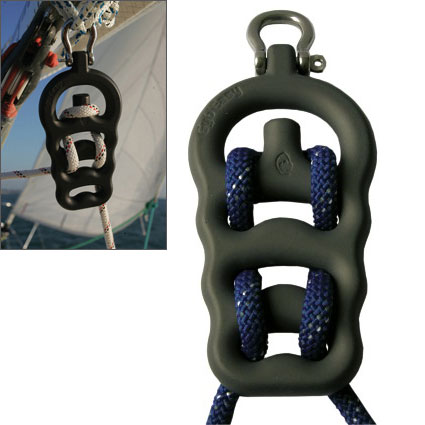

B. My preference ---- Use a boom brake but have the boom brake connection to the boom closer to the mast than normal, the connection of the brake to the boom should be nearly directly over the cap rail when the boom is fully outboard. When needing more downforce on the boom, simply apply more force into the boom brake. Use a cabin top winch to apply sufficient force to the boom brake to apply the needed 'downforce' to the boom. I use a Wichard Gyb'Easy boom brake (just a fancy mountain climbing friction carabiner) and do use it to 'assist' the (mid-boom) traveller in F8+ wind conditions on my Tayana boat. If the boom is well outboard and does go underwater when mightily heeled over, the brake will 'slip' and the boom wont break (I hope). Problem with a boom brake is more 'crap' to possibly trip over and get tangled in when going forward when its dark and stormy; and, you may not have sufficient tension in the boom-brake friction control line to prevent or slow down an accidental gybe.
