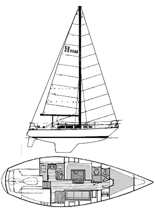

I have a new-to-me S2 11A. The traveler is located right at the entrance to the cabin, and is a problem if the traveler is right in the center. If I were to move it the top of cabin, what effect would that have on handling? I saw a picture somewhere on an 11A. I don't know what trove of calculations it would take, and I don't have the time to go back to school to learn. There are any number of companies that make that type of mount.

If it were my boat, I'd keep the traveler right where it is.. Moving it forward by 3 or 4 feet will change the dynamics on the boom and possibly lead to failure..
So, I'd have the traveler on an adjustable car with sheets. As long as it moves easily and freely you should be able to keep it to the lee side of the hatchway..

It can be done, but as others have mentioned, the cure might be worse than the disease. Moving the traveler forward will mean moving the attachement points on the boom forward as well. Three things happen because of this. First, because the sheet is attached closer to the pivot point of the gooseneck, you need more power to trim in the sail. If the sheet was attached 12 feet from the gooseneck and you move it to six feet from the gooseneck, to get it forward of the main hatch, you will need twice as many runs of tackle to trim the sail than before. If it was 4:1, it will now need 8:1. All those pullies result in added friction, so you may need a bigger winch to trim the sail. You will also now have twice as much mainsheet spaghetti in the cockpit than before. Second, moving the sheet on the boom can create point loading on the boom - you have doubled the pressure on it by moving it closer to the gooseneck - so the blocks on the boom need to be spread out to avoid this. This increases the length of line needed for the sheet, by the way. Third, the traveler that you have moved to the cabin top is also being pulled up by the sail with twice the force that was in its original place. Your cabin top may need reinforcing to keep it from ripping off, or from pulling the entire cabin off the deck. People do move their travelers off the bridge deck and onto the cabin top, but they take these issues into account when they do.

As for moving it forward, look at just how far forward it needs to move. Probably a bridge over the slider turtle. Double the bending moment on the boom. It just does not add up on this boat. You could try twin mainsheets; some people like them and the conversion is much simpler (I would located it further back on the S2).

As part of this query, an option would be to move the sheet attachment point out to a swivel bolt on the end of the boom. That would drop the sheet straight down and put a traveler on a bridge across to the two cockpit seat edges. That would put it right in front of the pedestal guard and then controllable at the helm. My understanding is that if the sheet is at the end of the boom, you can eliminate the need for the vang.
