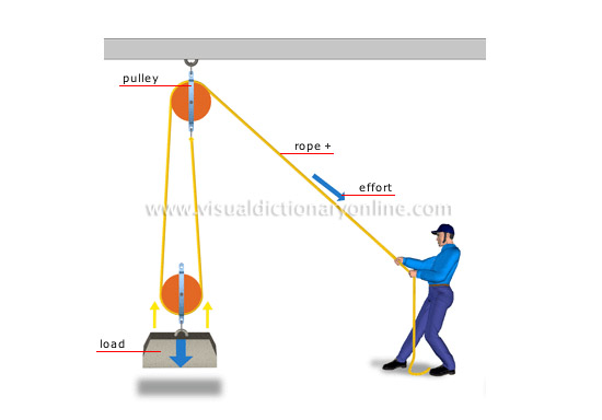

Pictures for Joe
Finally, and don't take this the wrong way... but it's a bit unusual for a racing sailor to use the term "pulley" when referring to a "block".
Not sure how else to take it. :evil: I do think by adding a pulley to the port side and a cam cleat over there I can get the same thing. But thanks for the purity lesson in terminology ...
23,530
Chill, your pulley photo was taken on land!:):):)

Sorry friend, I was hoping you might not want to seem too lubberly when you went down to the chandlery (that's a marine supply store) to purchase your parts. But since you're going to make your modification your way, anyway, why bother ask our opinions. FWIW this is what I had in mind.
