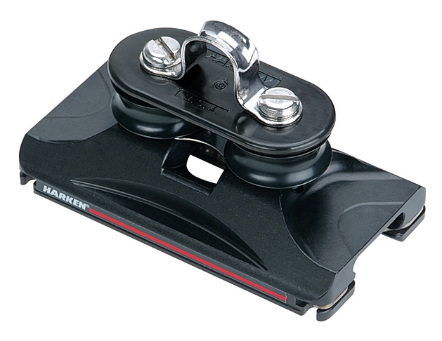

I love the 2002 Beneteau Oceanis 331 I recently bought! But her traveler line is shot.
The length is about 340". The diameter is about 1/4", but before I buy a new one I'd like to know the exact diameter. It's not in the BENETEAU 331 Jan. 10, 2003 OWNER’S MANUAL. I'd greatly appreciate this information if you have it.
Thanks
Arthur
24,759
Hi Arthur. Welcome to SBO.
The diameter and length of the traveler line are not specific numbers. It is based on two things.
  1. Diameter is limited by the size of the sheaves in the traveler. The line must fit in the sheave groove and not bind. It may be smaller than the sheave groove but not larger. 1654432849465.png
  2. The second consideration is feel the line needs to feel comfortable in your hand. This can be an issue as the sheave grooves are not large. It is typical of boats. You find the happy medium and compromise
  3. What you did not ask about is what type of line. You want a low stretch line. Dyneema is low stretch but hard on the hands. Nylon is easier on the hands but too stretchy. I like a polyester/Dacron double braid. There are others, but it gives me most of the properties at a reasonable price point
Good luck with your project.

Everyone, I've learned from Lewmar that the traveler ends on the 2002 Beneteau 331 are "Size 1 End Stops" which take 5/16" line. They say that the eye splice can be done before the line is installed. Then remove the allen bolt (metric) from the top which also hold the control line sheave (part numbers 7 and 11 on page 11 of the attached Ocean Hardware Spares Manual, Issue 7), put the scheave inside the eye, and reattach the scheave with the bolt.
Lewmar also cautions us to be careful, as no Ocean hardware spares are being made.
