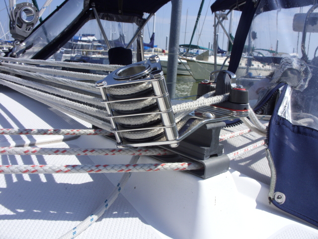

In order to avoid PaulJ stating that ...:pix:eek:r this post is just :lame:, here is a picture of the traveler mod. In the shipping notice there is not part number except for MT-2 which is they type of traveler we have. As with all things Garhauer it is nice solid beefy hardware. The dual cam cleat now that I see it is pretty interesting. Can't wait to install this on the boat and try it out. Will post pictures when I do.
The other gear to the side are the cam blocks for my line adjustable jib cars.

Happy with the Traveler Mod
It was pretty much an unscrew the old port side off, bolt the new side on and re-string the lines. For the starboard side I undid all the line and started from the center car to the top sheave going aft to front. This allowed when it was all lined/cabled (?) up to come off of the front of the bottom sheave where it fit nicely under the car and feed over to the bottom sheave on the new unit and out to the outer cam on the double cam cleat. For the port side I again started at the top so it came out on the 2nd from the bottom sheave where it went to the inboard cam on the double cam cleat. It is fairly easy to work and more importantly the admiral likes it and thinks it will help when racing.
Typical Garhauer fit, finish and construction and for $105.00 a nice upgrade. I still need to take a picture. To make PaulJ happy ...
:pix:
