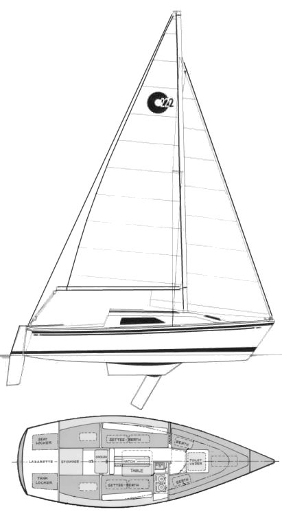

From the diagram it looks to me pretty straight forward. Can you expand on your dilemma? What type of problem are you having? Pictures are always helpful.
Some of us have played with more than one boat. We understand the basic of rigging. While we might not be fully versed on the rigging of a 3 masted square rigger, the end mast to transom system employed by your sloop is typical of many boats that size.

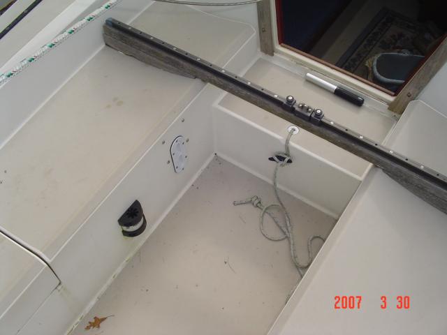

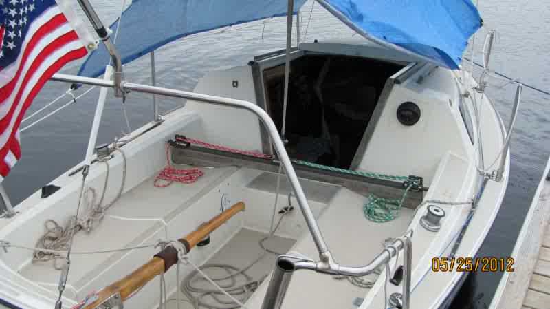

Mid-cockpit location seems most common on the 222, that avoids getting in the way of the tiller best. Otherwise Traveler would need to be on risers at transom corners to clear tiller, can be done that way, but seems easier to go mid-cockpit. Here was how my Late ,great friend Joe Alves (TRINKA) had his 222 rigged.

Very helpful. They are very cumbersome mid cockpit and make it very inconvenient to move around. I am going to forgo the performance for my type of sailIng.
