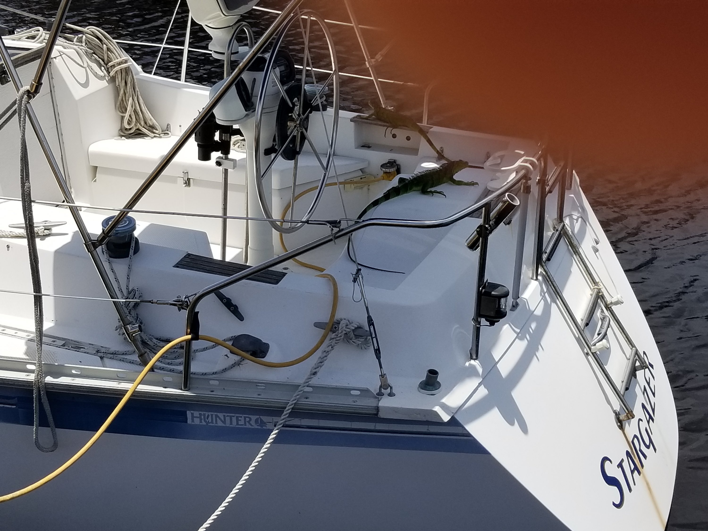

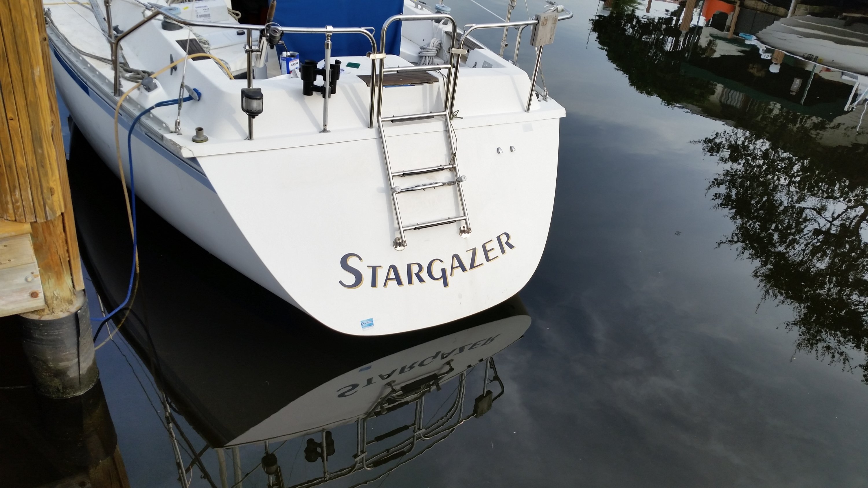

While not quite as bad as yours, the Stargazer had some dock rash as well when we got her. The port stern corner of the deck/hull joint had a sizable chunk broken off of it.
I was able to fill the gaps in with white Marinetex, and sand it all flush.It still has some minor imperfections, but I will fill those in the next time I break out the Marinetex.
Pay no attention to the large Iquana, and thumb in the top right of the picture LOL
Can you get matching molding/rub rail to the pieces that are missing/dammaged on her?

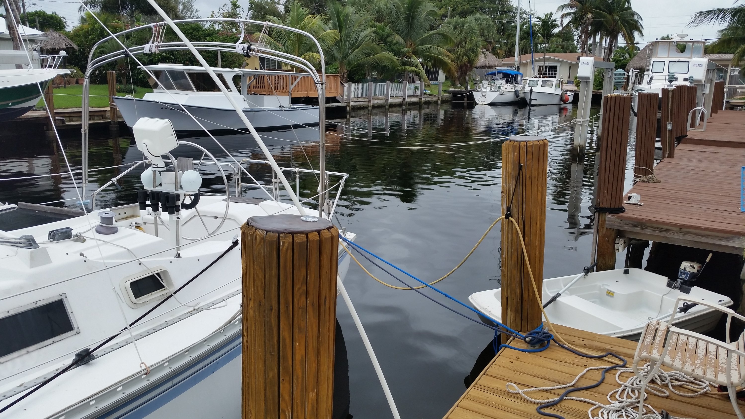

I already have the shore power cord suspended in the air via a bungee and saddle from the stern dock piling.
