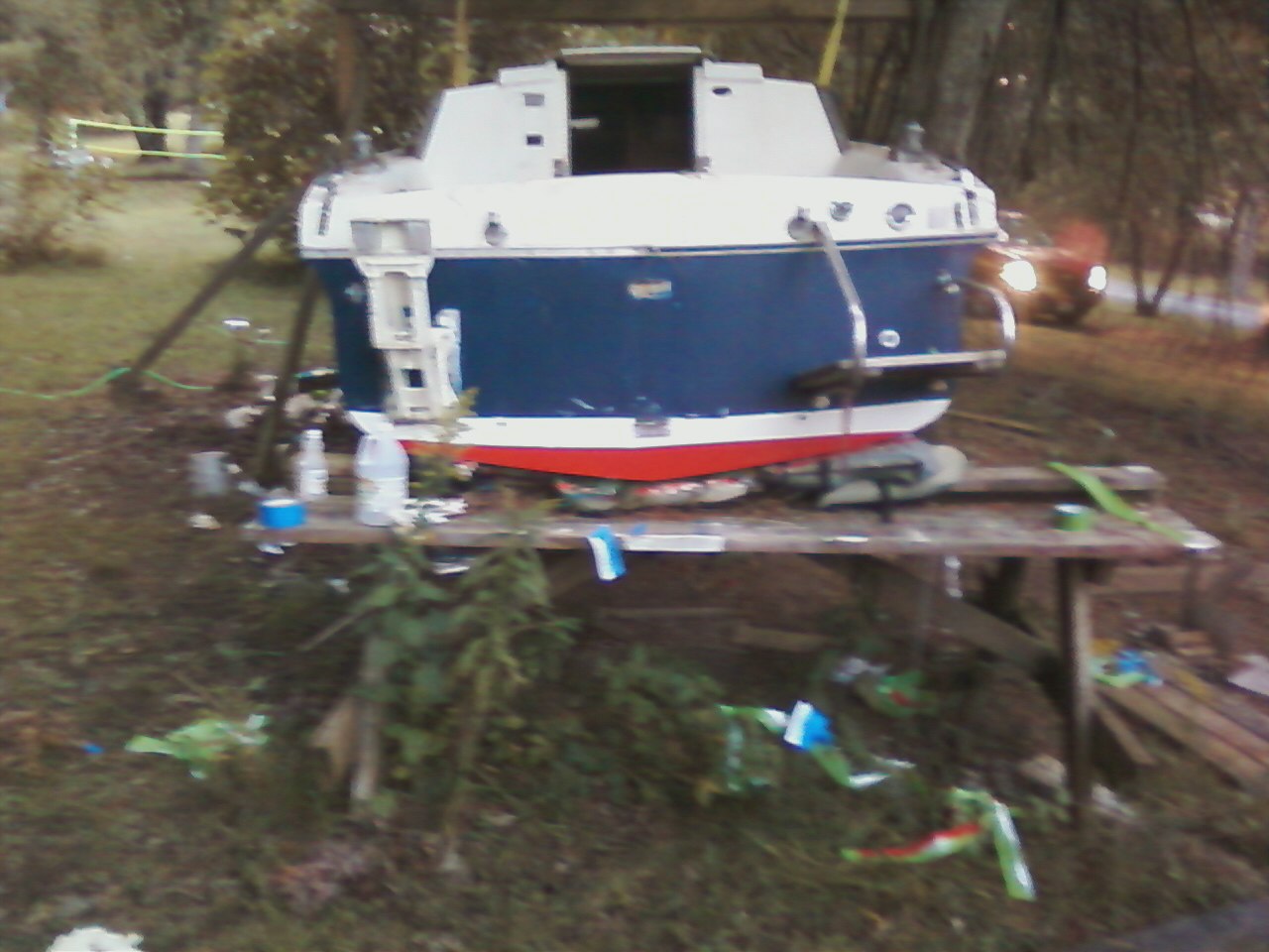

I've been slowly restoring this Rhodes 22... and it came with this very nice miniture swim platform. I chartered a Rhodes like this and fell in love... so when I saw a good deal on a sunk Rhodes... I nabbed it. Part of my plan is to add a small folding ladder to the platform. Getting in and out should be very easy.
