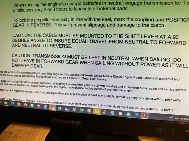

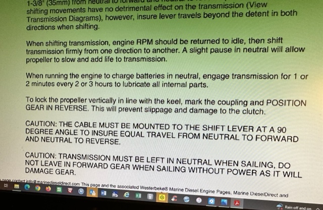

I own a 1983 O'Day with a Universal 5416 engine and a Hurth gearbox. I put my transmission in reverse while sailing. Attached are copies of the pages from two versions of their Owner's manual. One version says you must leave the transmission in neutral while sailing and do not leave in forward while sailing without power as it will damage gear. The other version says do not leave gear in forward when sailing. Gea must be in neutral for free wheeling or shifted into reverse to lock propeller while sailing.
