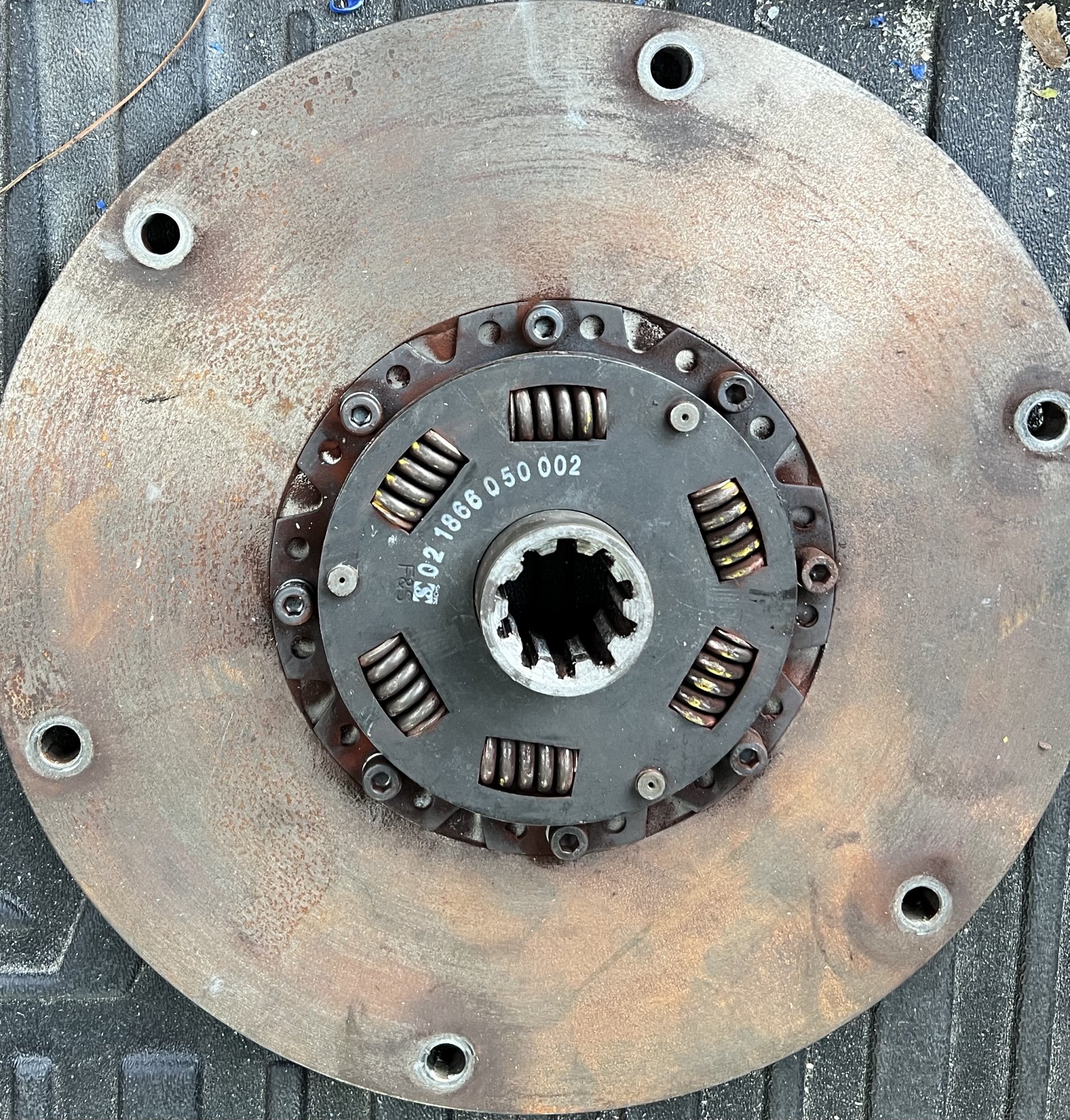

The damper plate looked very young. Only a few spots of surface rust on the springs. It obviously had been recently changed. No need for a new one.

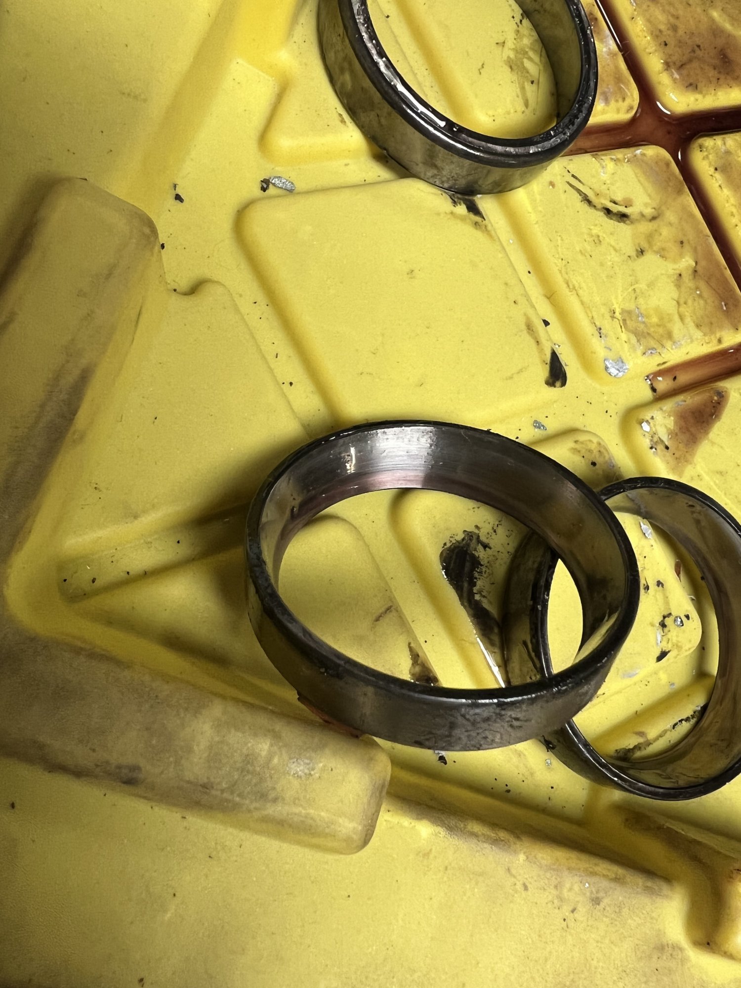

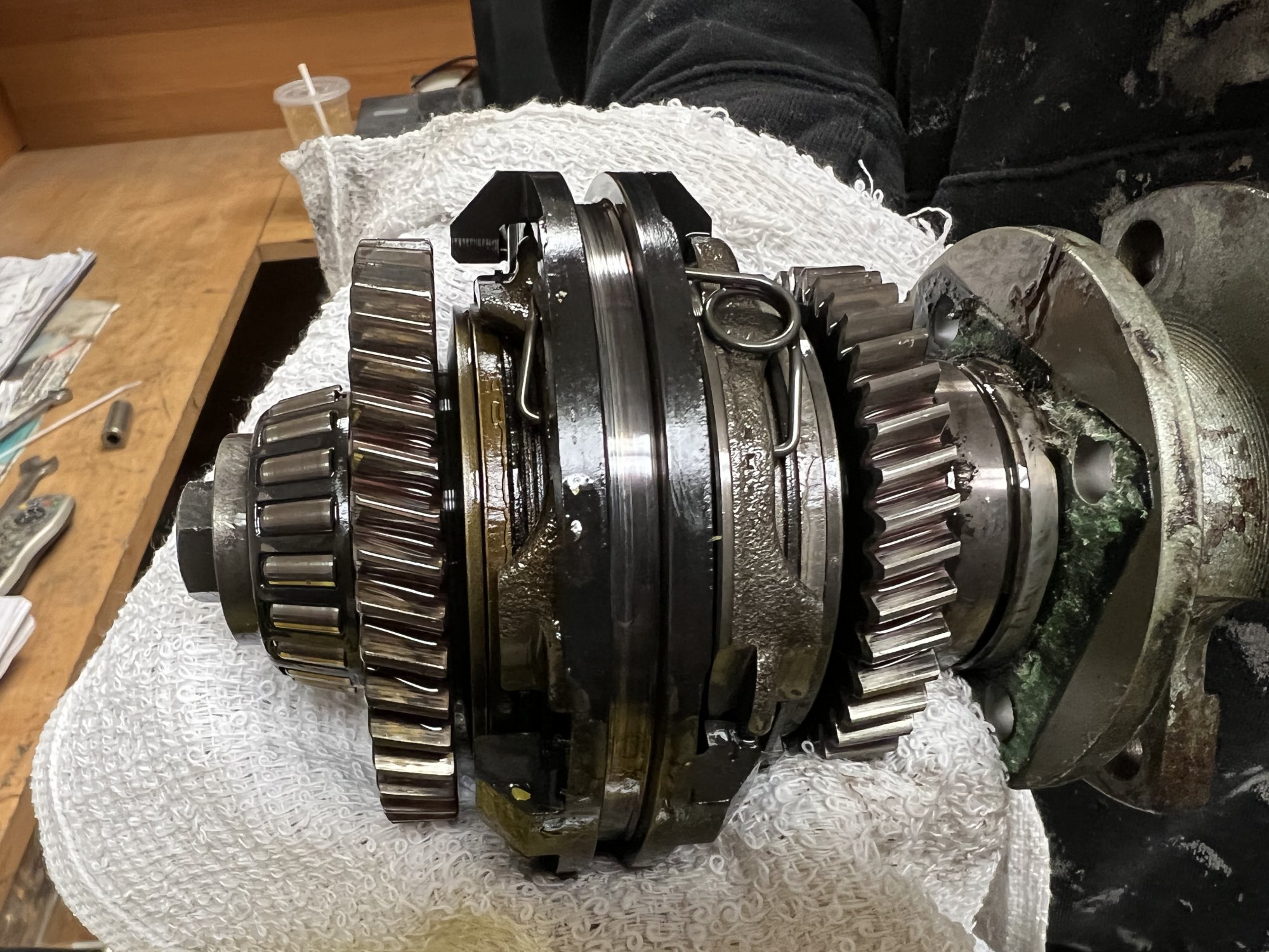

The first observation was the discoloration of the bearings, gear and clutch assembly (left side in the photo) from severe overheating compared to the reverse gear side.
The disc carrier actually had some blue discoloration from the heat. During my ownership the tranny oil was always at the proper level. Rick felt there was another reason that allowed the clutches to start slipping badly, then it overheated.
When Rick went to press off the shaft components most slipped right off, another sign of high heat.

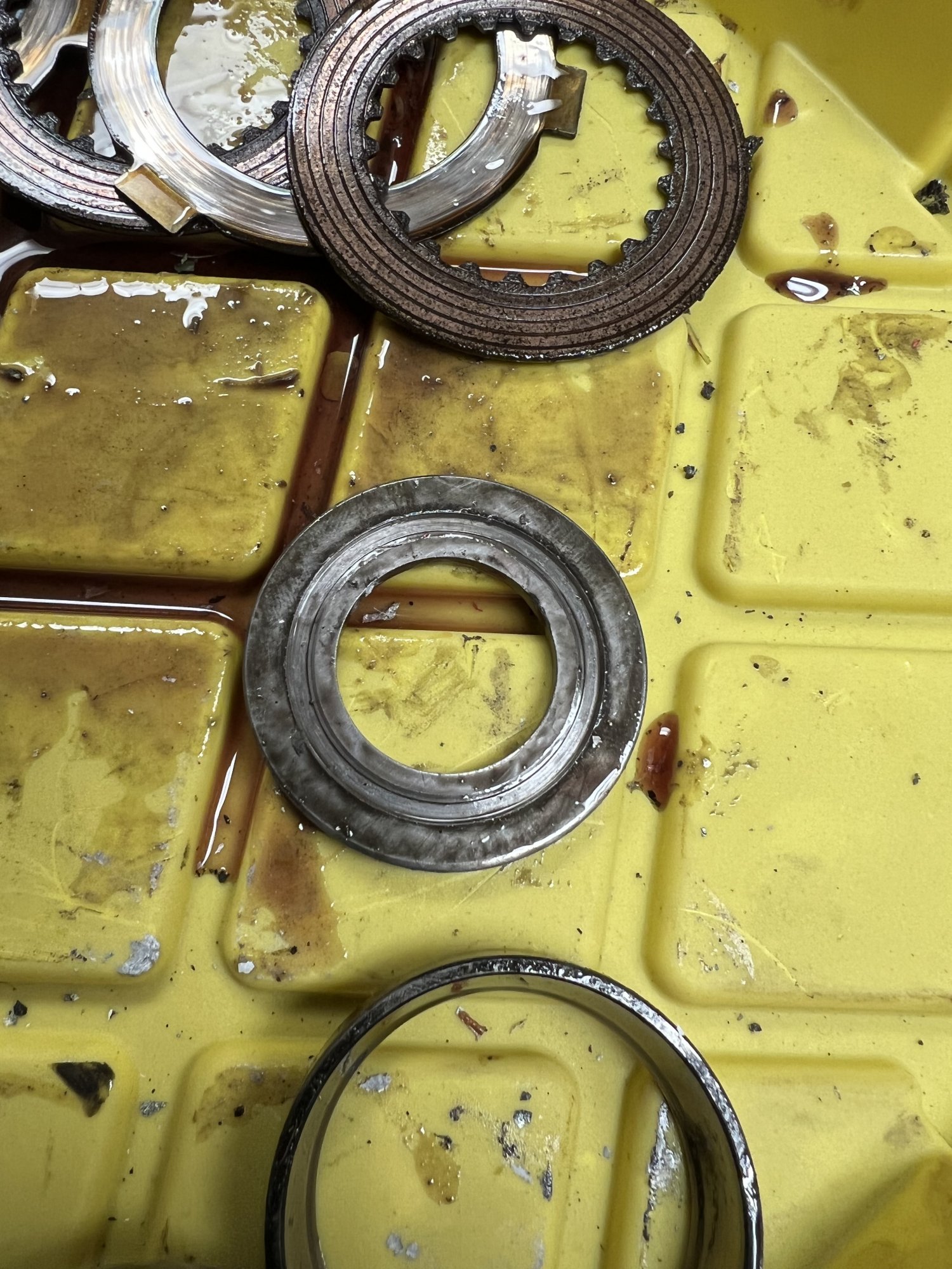

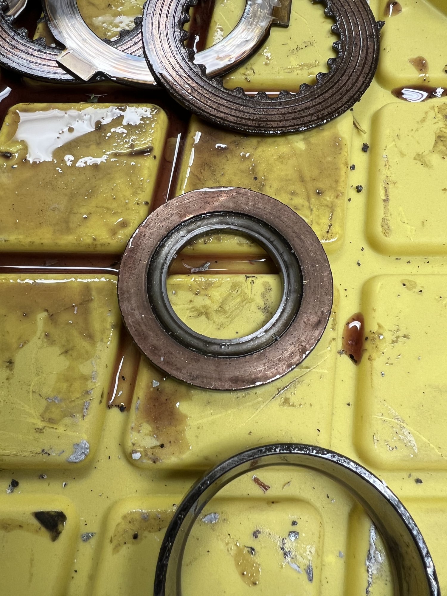

Then he found the probable cause of the failure. The thrust washer appeared to have been installed backwards. When new one side of the thrust washer has a bronze wear coating on it because it slips on a gear, the other side does not have the wear coating as it sits against a bearing . On this one the bronze side had almost no wear (1st photo below) and the non bronze side was deeply grooved.(2nd photo below) That excessive wear allowed slop in the clutch plates so they slipped badly.
Rick took about 45 minutes with Stu and I, discussing what we found and possible causes for the failure. He even noted high wear on the shifting yoke and felt this tranny had been abused in it's earlier years.
