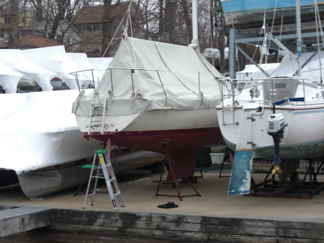

Photo of prop ...
It is a little far away but this seems to indicate that the clockwise rotation as you are looking from this position is forward, which is the way Mack says it should be (I believe).
