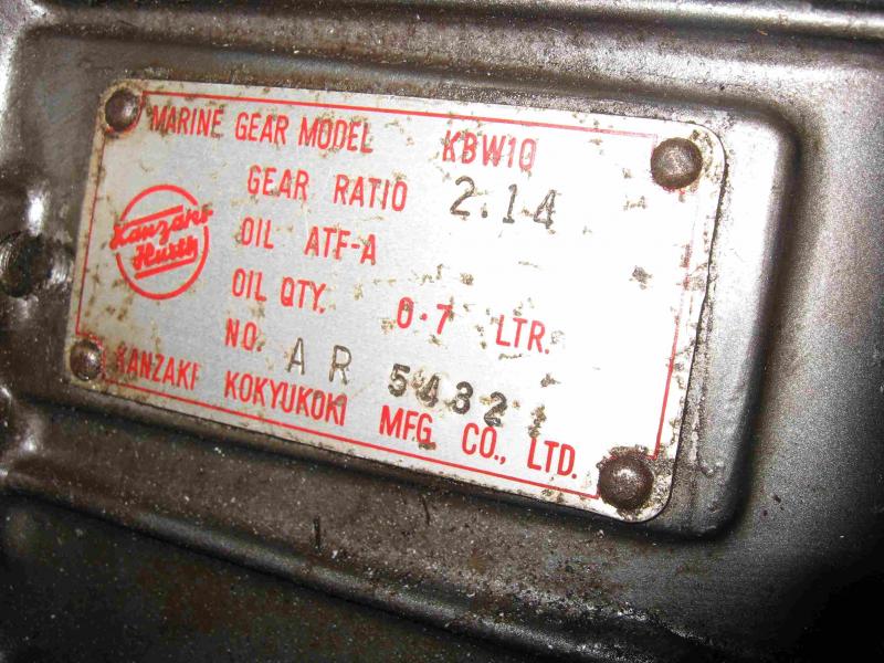

Good chance that name plate on the side of the transmission might also have the oil type specified.
For example here's a picture of the name plate for the transmission on my Yanmar 2QM20.

If you find that the transmission is a KBW10D, that one would require ATF.

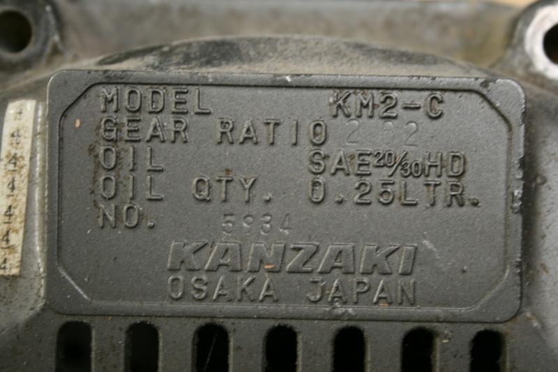

Looking from the rear....
.....this is what it looks like on my KM2-C that is mounted to my 2GM20F....
regards
woody
