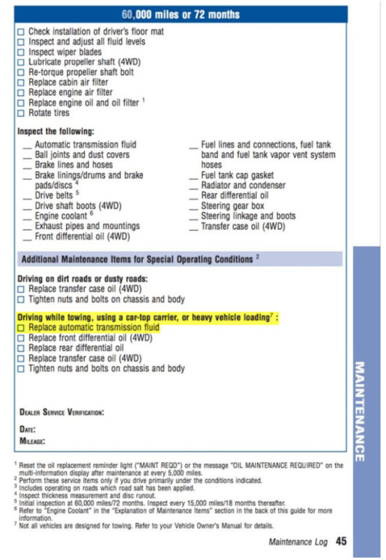

This is the 60K interval for my truck. Note the 60K interval just for adding a Thule type box. Lifetime....???
