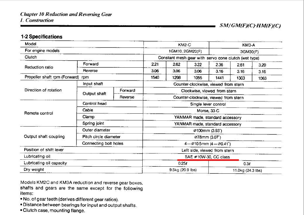

I have had everybody and their brother come in on what should be used as lubricant for the transmission some people say automatic transmission fluid Otherside 30 weight
When it comes to your engine, I think most people here agree .............. kick the know-it-alls to the curb and rely on the Yanmar manuals and advisories only.
Ensure your transmission is a Kanzaki and not something unusual.

suggest you do a search of the archives. There is a Yanmar service bulletin posted there in which Yanmar states that if you have the Kansaki transmission leave it in neutral and DO NOT sail in foreword or reverse. You will damage the transmission.
Now if you have a boat with a Hurst transmission they recommend reverse.
