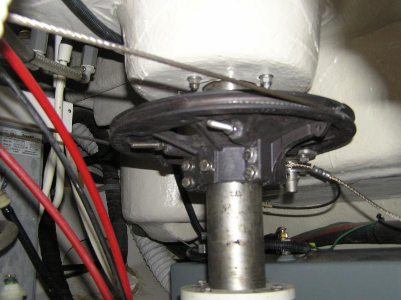

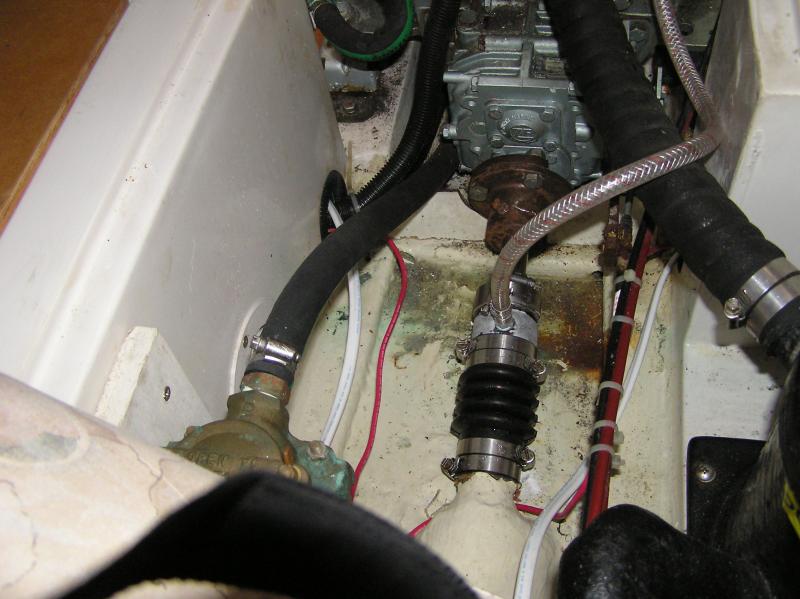

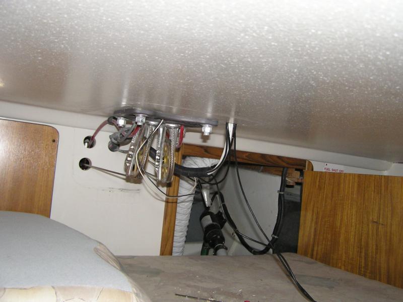

Cables drop down thru pedestal than...........follow the pictures

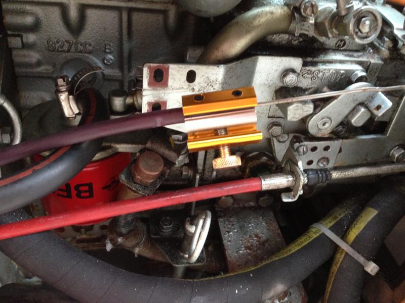

I haven't tried it on the shift or throttle cables but I did lube the shut off cable using a cable luber found at motorcycle shops. A sailor on the C30 Yahoo group suggested it and it worked better than I expected.

Another thing to check to the cable holder. In order for the cable to work correctly, the outer jacket of the cable is held in place with a "U" clamp (you can see it rusted on the 4th photo posted by paulj). If that clamp is broken or undone it will prevent the shift cable from working correctly. As paulj's photo shows, this area is kind of poorly placed on the C310s. It's right in the spray zone for the stuffing box so it gets quite rusted.
I had taken mine off when I repainted my engine. When I put it back on I must have forgotten the lock washers. On a trip up to Gloucester earlier this year I dropped/furled the sails and turned on the engine to get ready to go up the Blynnman Canal. When I went to put the boat in reverse while holding position waiting for the bridge to open, it wouldn't go into reverse. I had been having some problems with this when we left and figured I would check it out further once at the dock at Cape Ann. We skipped the bridge opening and went to grab a morning. I checked in out and the U clamp had fallen off. I replaced it and all worked fine.
