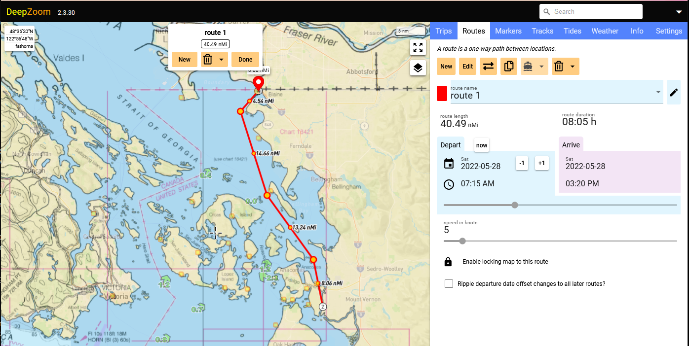

I just played with DeepZoom.com trip planner.
Inputting you leaving Blaine on the 28th at 07:15AM arriving in La Conner 15:20 (3:20PM) Currents mostly helping
I'd go down the Rosario Channel, west side of Lummi unless the weather was crap. The water is open and the tidal currents are helping till about 12:30 when you near Padilla Bay (on the East side of Guemes Isl.) Being well inside of Rosario at this point avoids all the significant tidal currents. Assuming you are averaging about 5 knots gets you to the north entrance of Swinomish Channel during the middle of the flood. Good news is the water will be plenty deep. The not so good news is the tide current will be against you.
I believe the current in the channel runs about 3 knots. This means your running in the channel to La Conner will be slowed. Unless you choose to sit out in Anacortes or run the channel later.
Personally I would chug along and reach your destination between 1500 and 1600 (3 and 4PM).
I would recommend calling ahead to the marina and securing your berth for the night on the inside of the dock. Traffic in the channel can run all night and an otside tie means you will be rocked a bit by vessels moving at greater than "No Wake" speeds.
Deepzoom allows you to plot a course and play with your time of travel showing you the tide/current changes as you transition down the route.

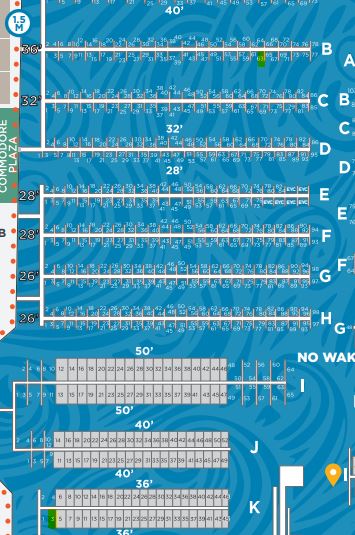

Next question - I have been offered B63 or K3 at Everett. K3 is a shorter walk and better for parking, but looks like a pain to get into and out of?
Both are starboard tie up which isn't ideal. I am leaning toward B63 as I am currently in a slip that is a pain to get out of similar to B3 in Blaine. Either way I will probably put in for a preference move.
May 7, 2012
1,623
Hunter e33 Maple Bay, BC
If it is like most marinas you will be charged the length of the slip or overall length of your boat whichever is greater. In this case you will save 1 boat unit/year if you go with K3. However it maybe a bit of a challenge to get in and out depending on the wind, current and your ability to maneuver your boat in tight spots.
