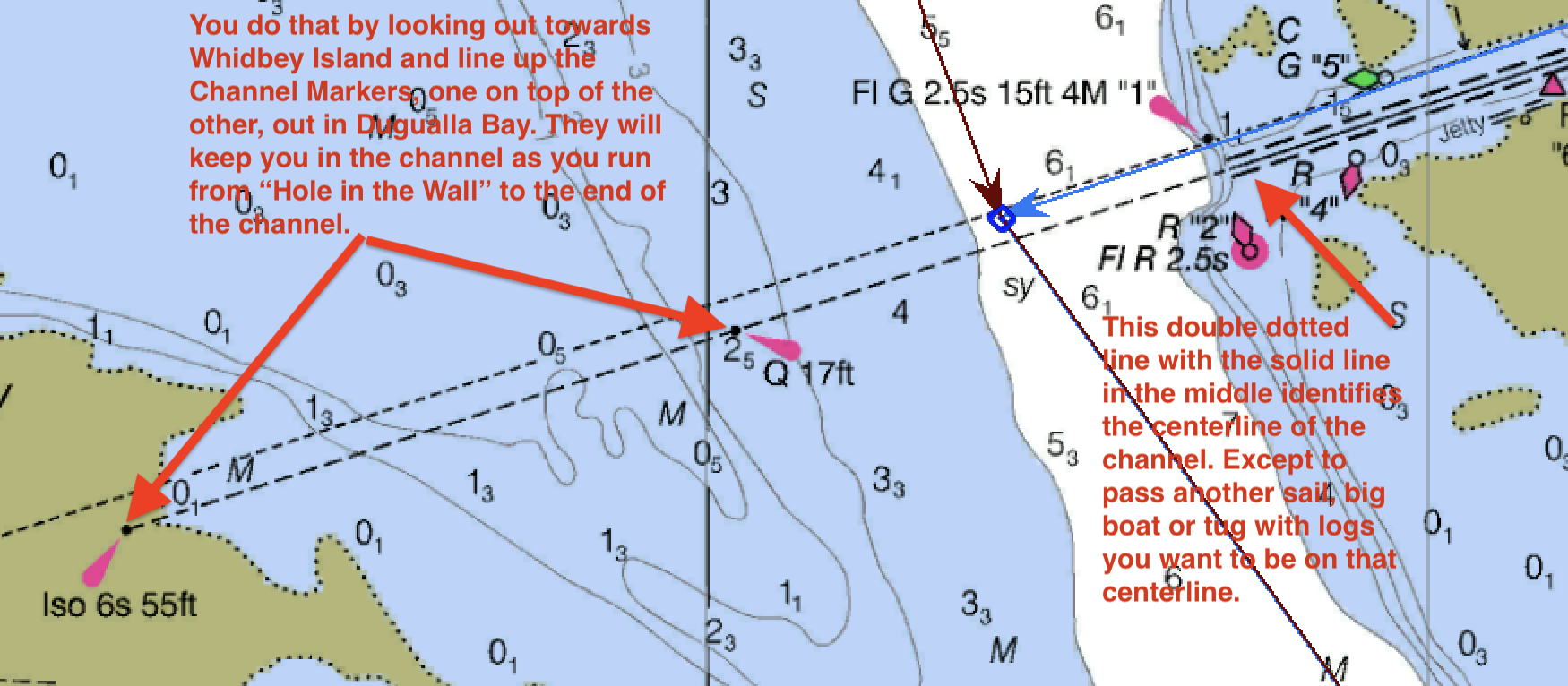

Here is a tidbit regarding the south end of the ditch. Captured on OpenCPN from my Mac laptop. Start on the Right side then progress to the left side of the map.
You do not turn out of the channel till you reach the water identified on the chart in "white". The blue area is shallow water. Mud that will grab your keel and hold on tighter than a pit bull. Don't go there even if it looks inviting and wide open. Others have tried with out success.

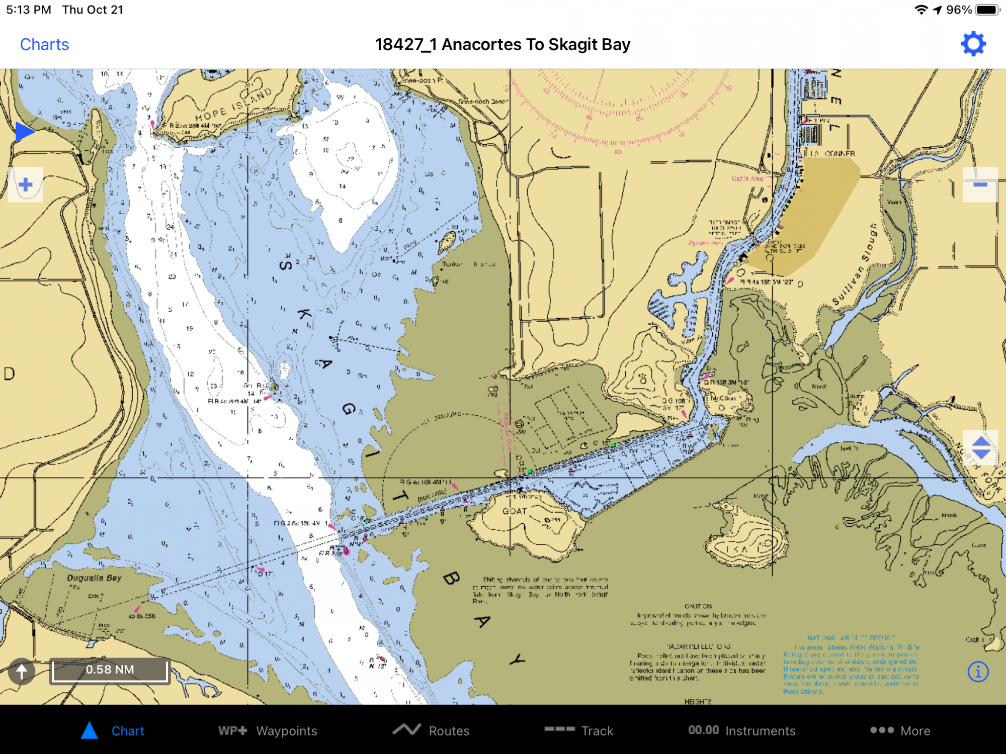

I there a charge for iNavX? I’ve had it for so long, it was GPSNavX for a Mac when I got it. I have it on my iPad, and use it for planning my travels using free NOAA raster charts that I downloaded. I had a subscription to Canadian charts, but I’ve let that expire until it’s time to plan for some longer cruises next year. Barbara and I might try to sneak across to Bedwell Harbor/Poet’s Cove for Thanksgiving, but we’ve been there before, have paper charts, and plenty of chart plotter coverage using our native B&G charts or Navionics. I just received my “Get back into the country” sticker from CBP this afternoon! :p
