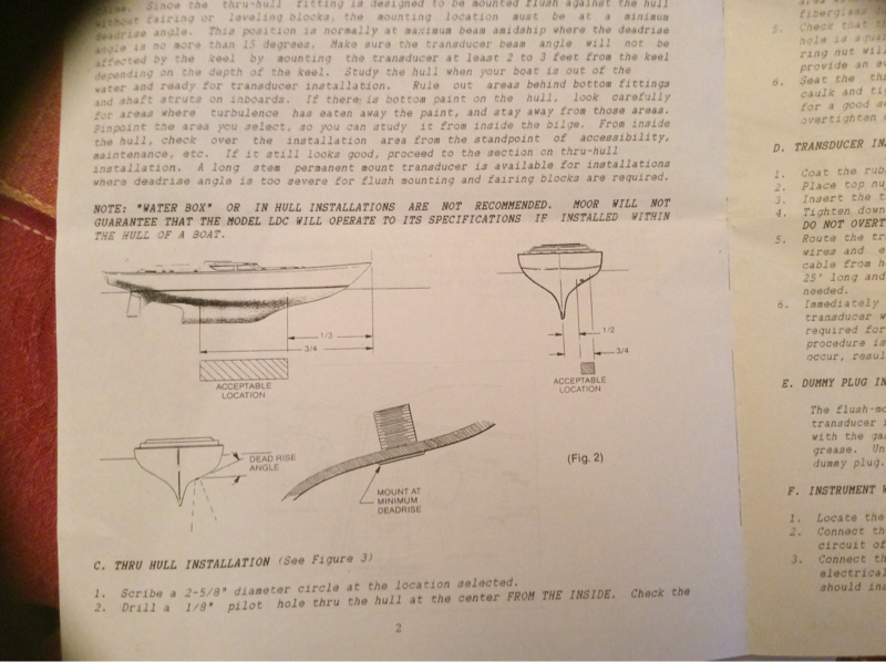

Just received my new transducer from Moor electronics and after reading about them I decided to just mount the transducer in the hull not thru it. However the instructions suggest not to use a water box or wax. Wonder why?
I currently have a thru hull (that is not working) that is the same size as the one I just received. The directions also say that they include a "dummy plug" so I can remove the transducer while the boat is "afloat" to clean it. My thought is, if that's the case, why not remove the old one and just stick in the new one...
I have also read about people using a plunger outside the hull during this process to keep water flow at a minimum...???
The boat was just launched a few months ago so it won't be out of the water for a while.
Suggestions or experience??
