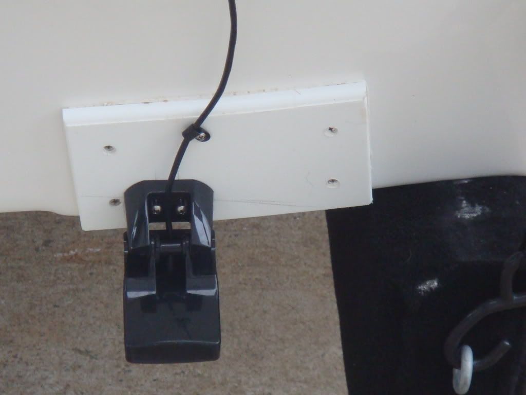

If you consider mounting on the transom; using a board for mounting is a good idea.

good idea about the board for the transom... I have a Carl Alberg design full keel boat... the transom doesn't even sit in the water.... it is above the water... I need a solution of where and how to install the transducer inside my boat far enough forward so the lead keel doesn't interfere with the transducer signal....
I have posted pictures of my boat, to give a better idea of what I am dealing with in my problem here...
like I said before, I use to have a Mac25, and it was easy to figure out and install.... under the V-berth, in the bow... easy and done.... this full keel boat doesn't have the opening under the V-berth.... under the V-berth is a built in fresh water tank... no place to put the transducer....
