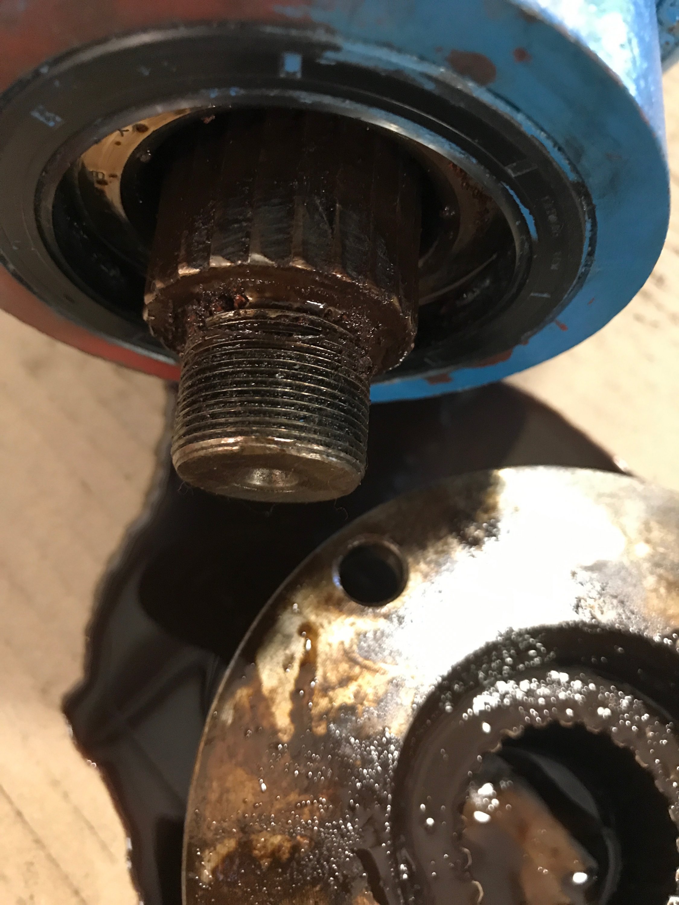

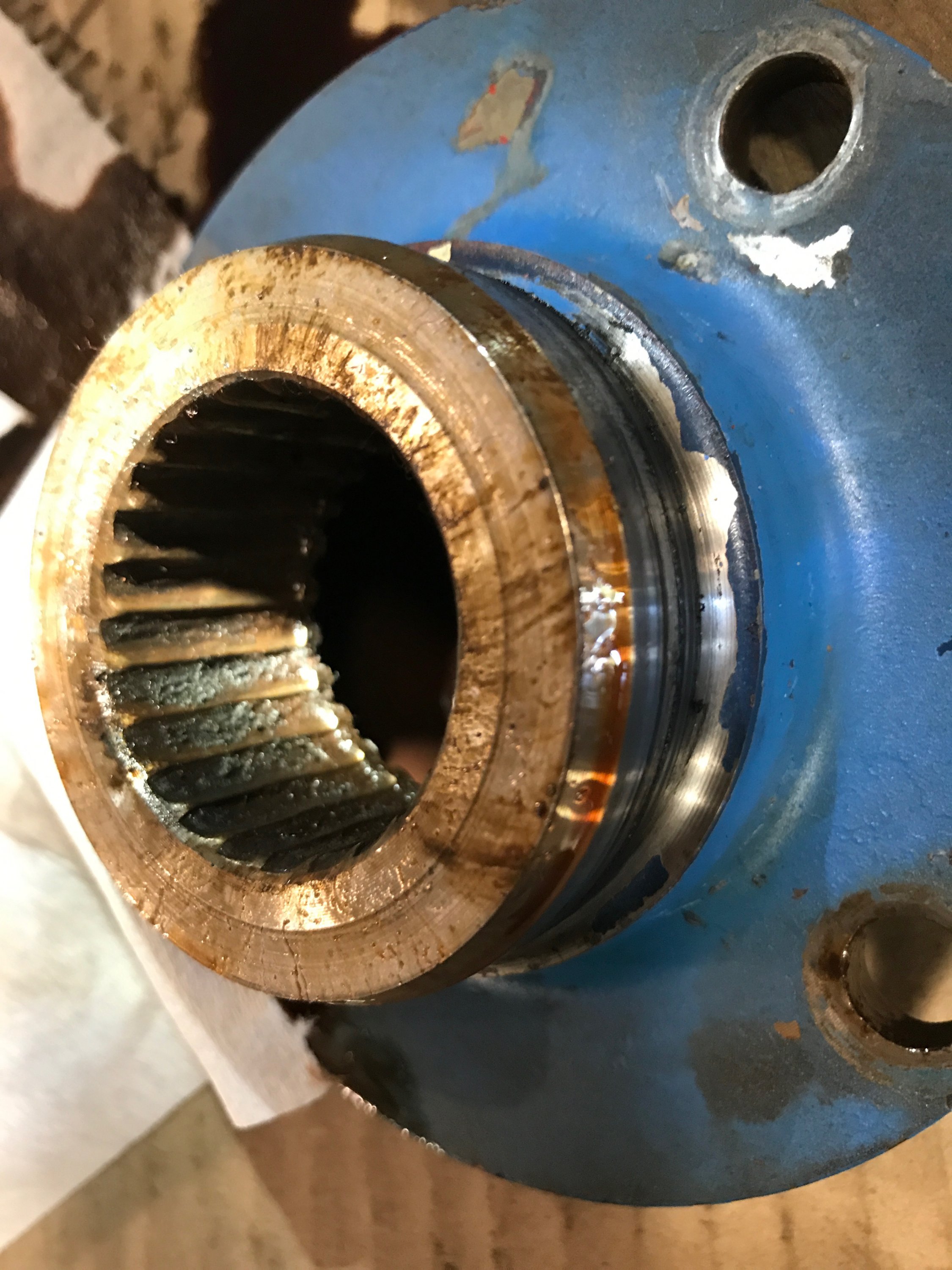

OK tranny out, diver had to pull fishing line from around the shaft to slide it back enough to pull the tranny. Nothing bent or broken below the waterline. However the splines seem to have broken off in the coupler causing the loss of power to the shaft. That was all new last summer so I'm not too happy.

I don't think the fishing line was enough to bind it, but sliding the shaft back it jammed against the strut. My guess is that last summer when I had a seal replaced, the new parts weren't particularly right or over torqued. Painful either way.

Ouch! I don't understand... is that the output shaft? Looks like a locking nut was holding them together? maybe loosened over time allowing spline to wear. Doesn't look like the splines have been sheared.
