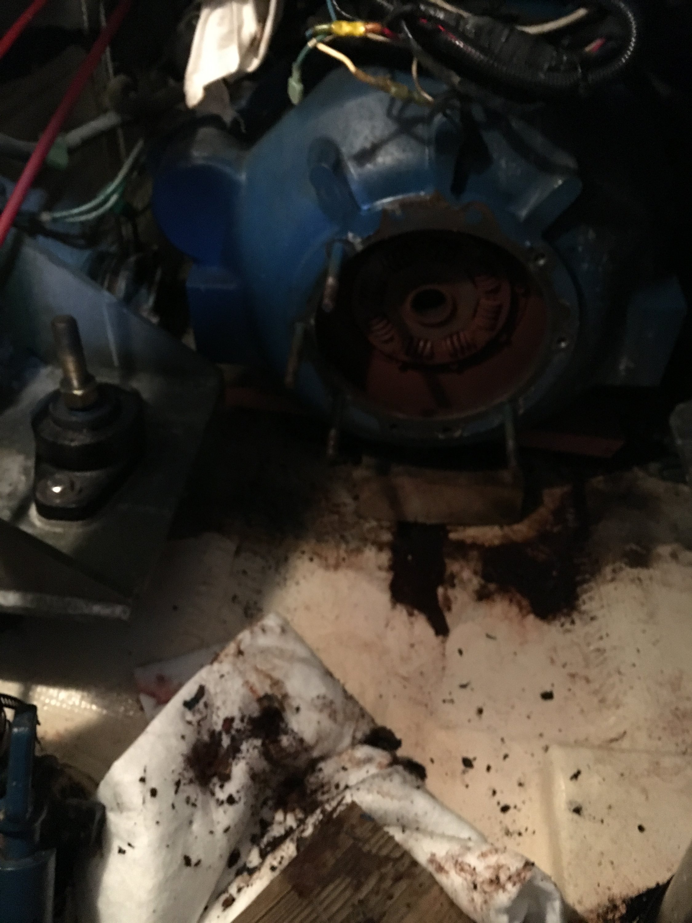

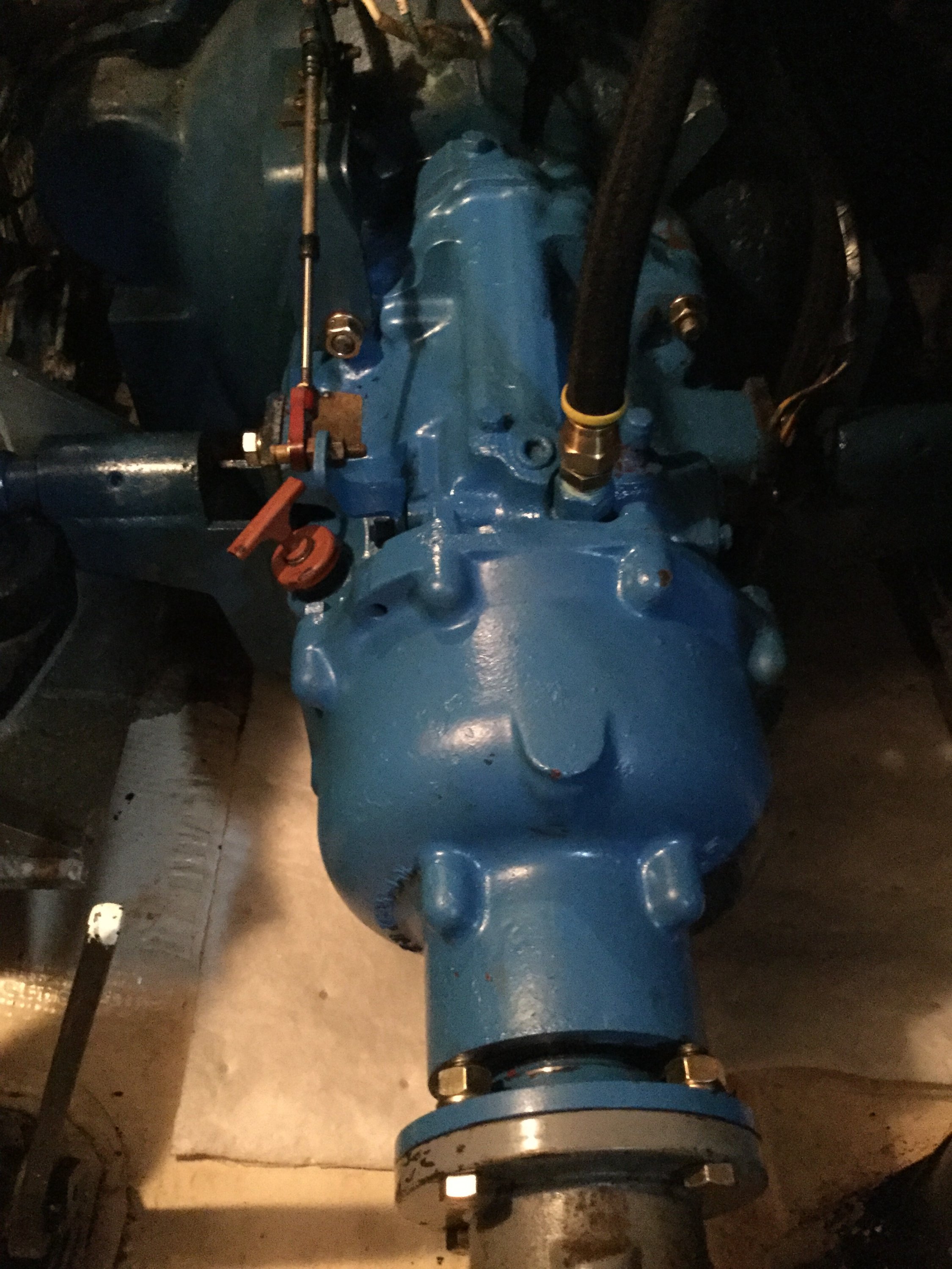

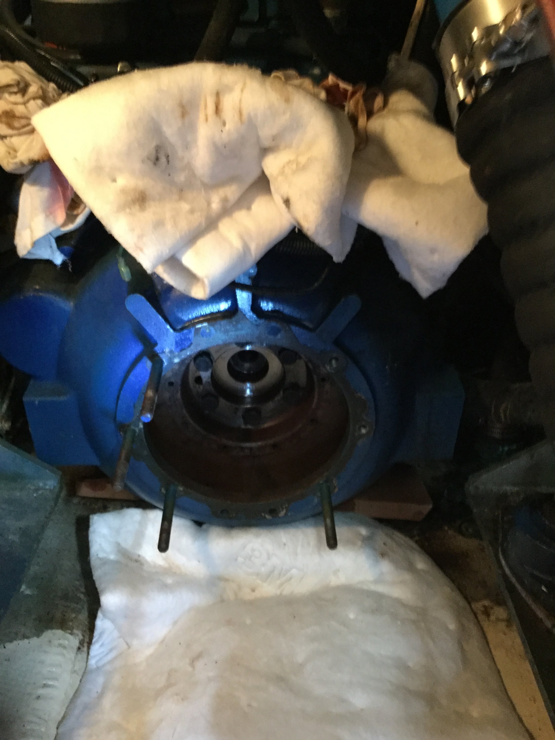

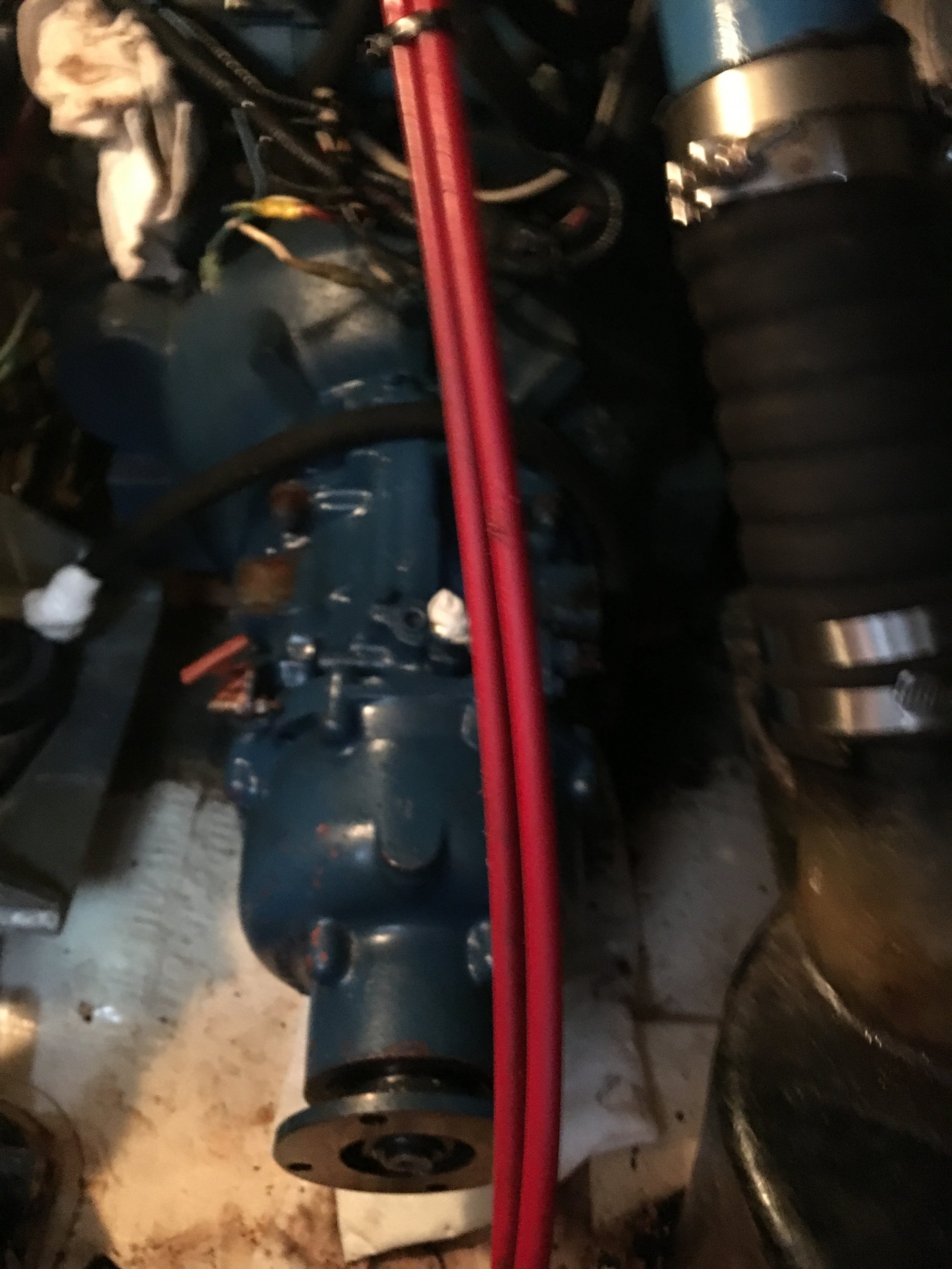

Tuesday we got the boat in to the dock and our mechanics got to work. There's always one rusty nut to slow the job down but they soon had it apart and wrestled out of the boat. Mini air bags under the motor would have helped lifting and blocking. Maybe a Mini engine hoist to slide it out of engine room. Can't believe I'd be the first to think of this. However with some extra help they were able to hand it, relay style, out of the boat. The dampener plates were also in need of attention so they got yanked also. Here are the pics.
