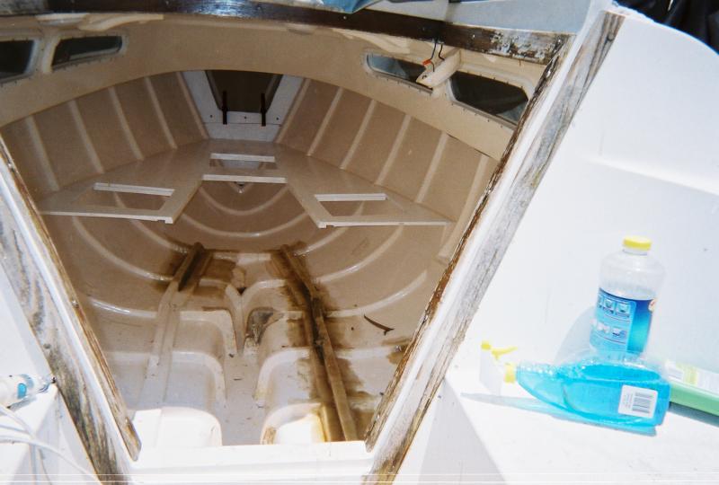

I used to own one of those.... They are a really nice boat. I gutted mine to bare hulll in and out so if you have questions about structural issues, I probably have a picture in my files.... ]
Install the bow eye with a large piece of trex or treated lumber as the backing plate ... this will disperse the strain. I'd recommend trex so you don't have issues with rot. Glass it into the groove in the stem (nose of the boat). Then drill the holes from the outside of the boat for the bow eye to slide into. Make the holes a little snug on the bow eye bolts. Squirt a little water in the holes and then cover the bolts with Gorilla Glue before you slide them in. Gorilla glue expands when activated by water and will make a water tight connection. Make sure you tighten up the bolts before the glue dries. Use some large stainless steel washers on the inside and you are done.
