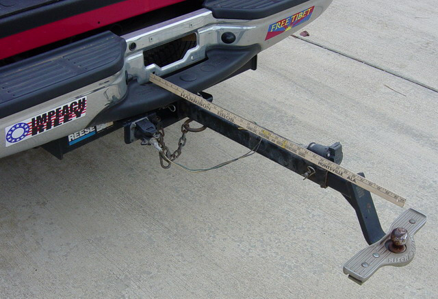

There are several tricks one can use to extend the trailer tongue
Do a google search
Here are a few ideas
Likes: SchuhFits

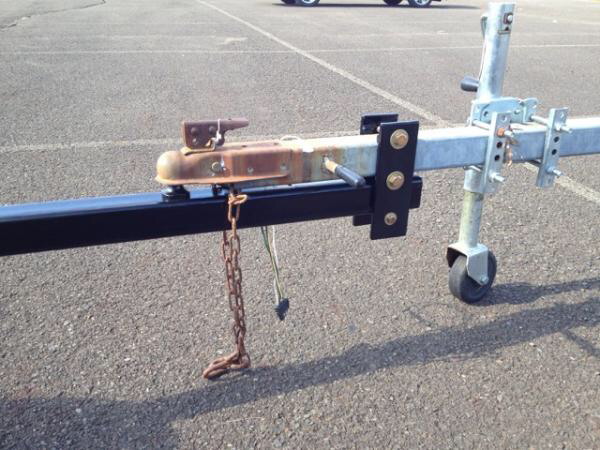

Ha! Rgranger's first picture of a tongue extension is from my trailer! :biggrin::biggrin::biggrin:

By the way, at our lake with a very nice, long, reasonably moderate slope concrete ramp, we routinely launch and retrieve 4.5' draft fin keels like Impulse 21, Santana 20, and J/24. This is usually done with a 25' tongue extension that is carried on the trailer and slides out. Most are actually alongside the regular tongue, with brackets attached to frame members such that the extension can slide out. Some people pull it in and out with the car, but I kinda like sliding it by hand if it's lined up well and smooth enough. A suitable jockey wheel is necessary - the bigger the wheel and softer the better. Eg. if it's a hard plastic wheel, bigger is better, or pneumatic wheel. The best jockey wheel I've seen was on a custom Triad trailer built for a Beneteau First 235 fin keel. It pivoted down, and was a nice sized pneumatic tire. Rolled nice and smooth... With a nice jockey wheel like that, strap launching is just about as easy. Nice and high keel guides REALLY help get everything in position.

Everyone looking for a tongue extension: If I did it over, I would use thinner wall thickness tubing, possibly even aluminum, and instead of the crazy bracket bolted to the tongue, I'd just have 2 tabs welded to the end of the extension with a normal trailer pin that goes between. This was my own design as realized by a friend, and it's unnecessarily heavy and complicated. :D

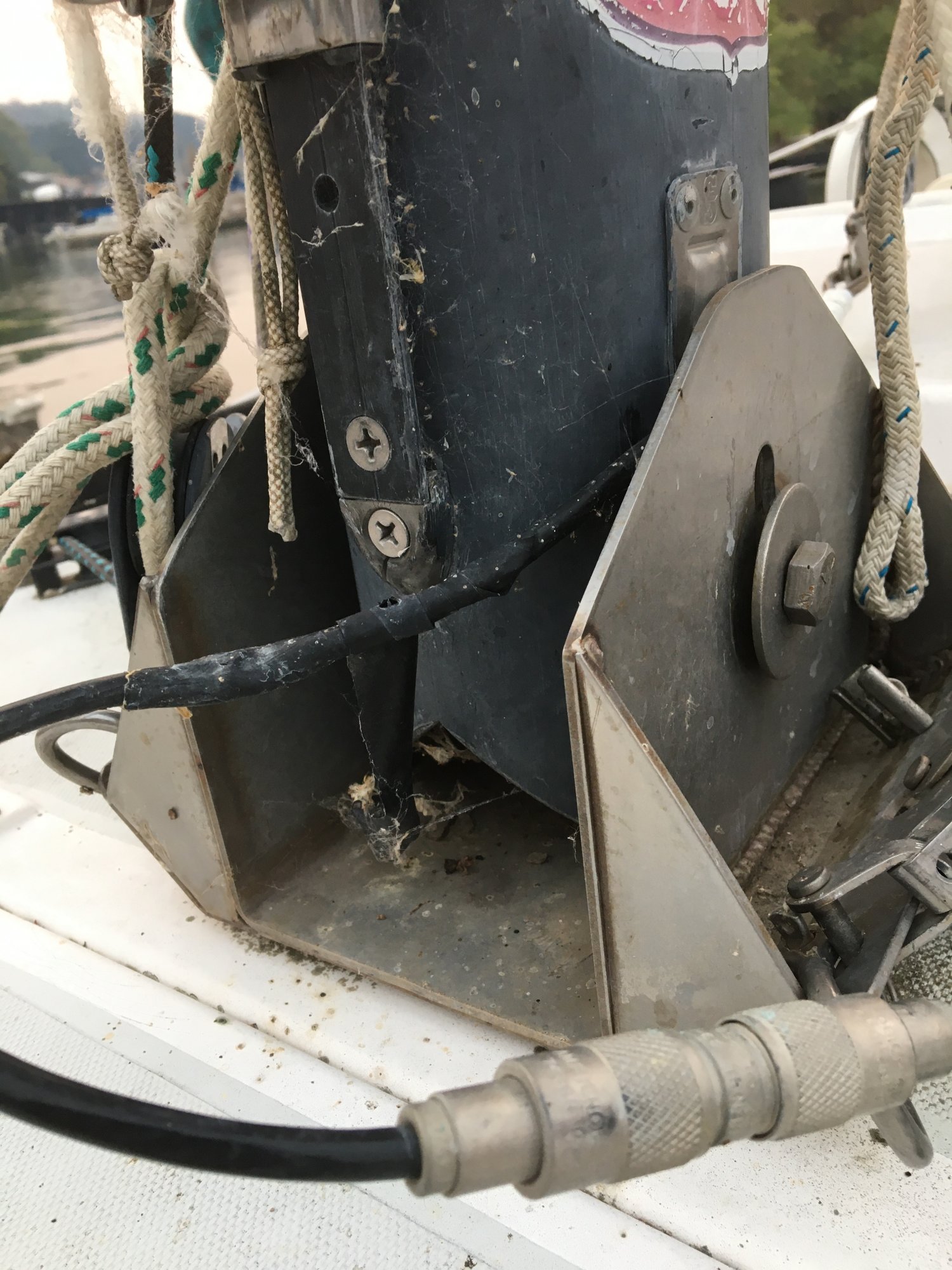

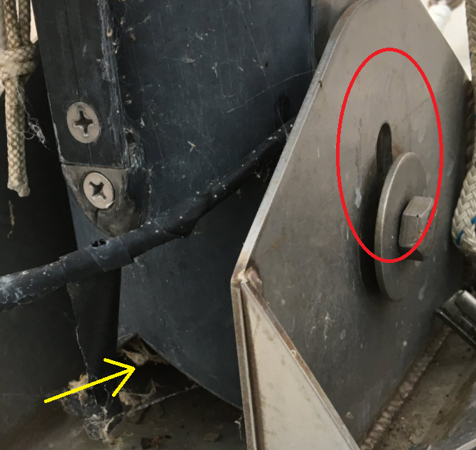

Thanks for your response. Here is a picture of the mast step which I believe is a tabernacle? It also looks like the mast would be lowered forward because the mast bottom is rounded on the forward end. The rear end of the mast bottom is square so I don't see how it can tilt backwards. Any thoughts?
13,096
You clearly have some play in your mast hinge (red oval) so I don't think you will have any trouble tilting her backwards. My guess is that the V-shaped cut away in the front (yellow arrow) is where the mast wiring was supposed to be routed.
