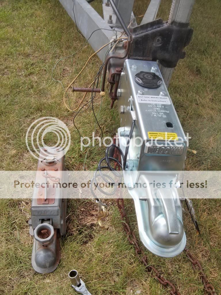

Well after further review I determined that the old brake actuator was junk. Bought a new one at Northern Tool of $149 and installed this weekend. Bled the brakes and kept my fingers crossed that the drums weren't seized. They worked like a dream!

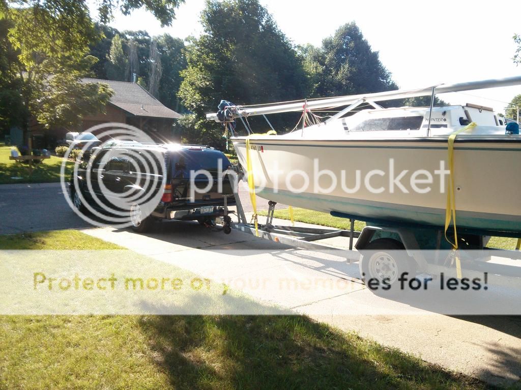

I also got new tires, leveled my ball, took the outboard off, and moved the boat further up on the trailer. The difference was night and day! Took the boat on a 35 mile trip (to Lake Minnetonka for you Minnesotans) and instead of a white-knuckled 50 mph trip that I had bringing the boat home, I had a worry free, 55 mph drive to the lake. Did 62 mph on the way back with no problems either. I'd say that my trailering concerns have been alleviated! Thanks for the help.
