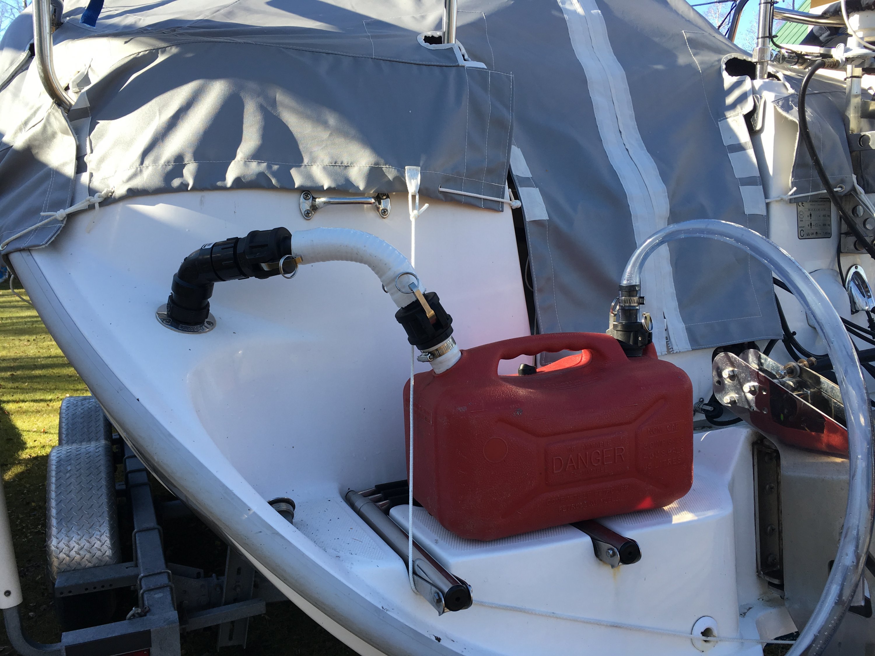

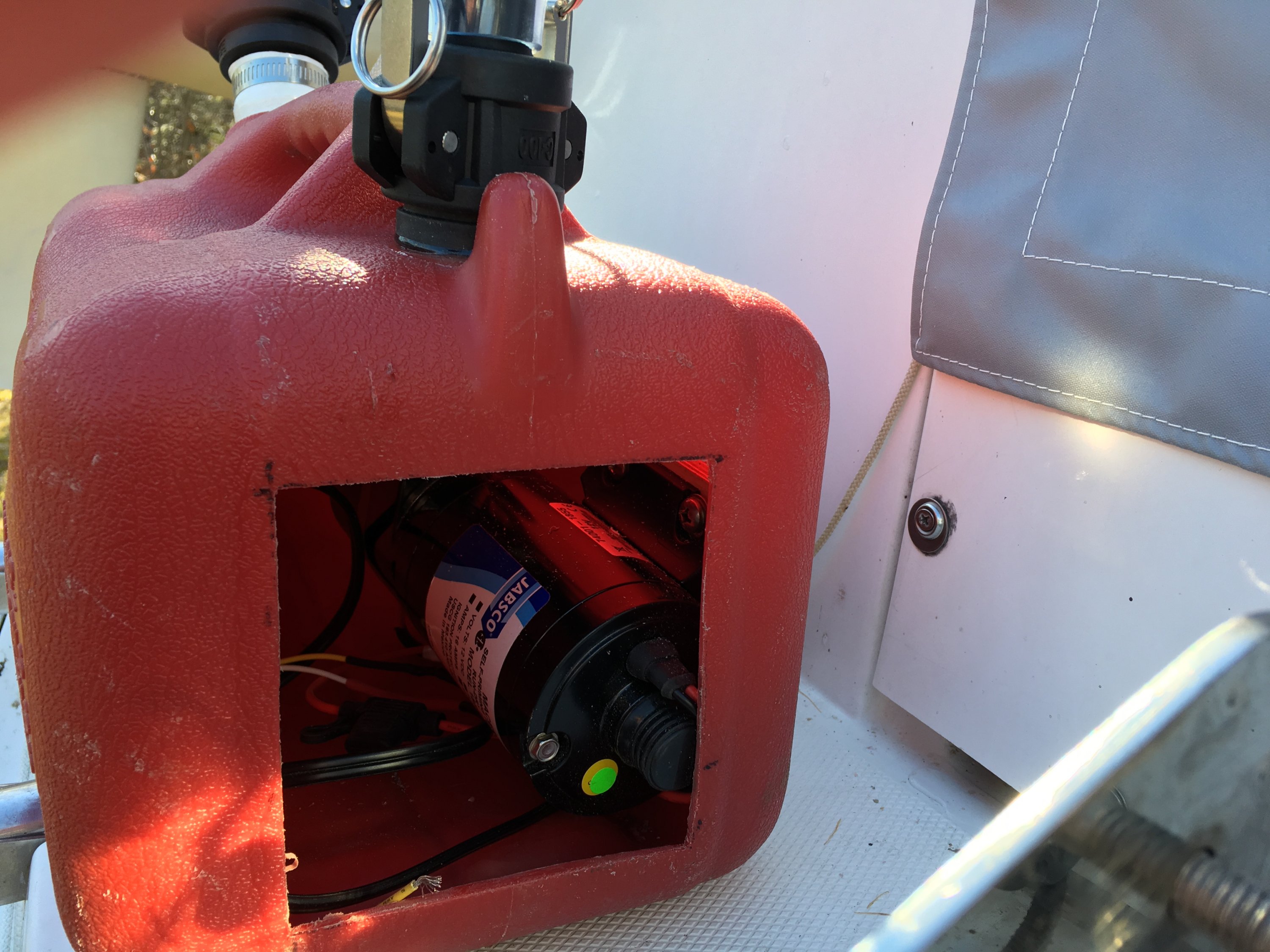

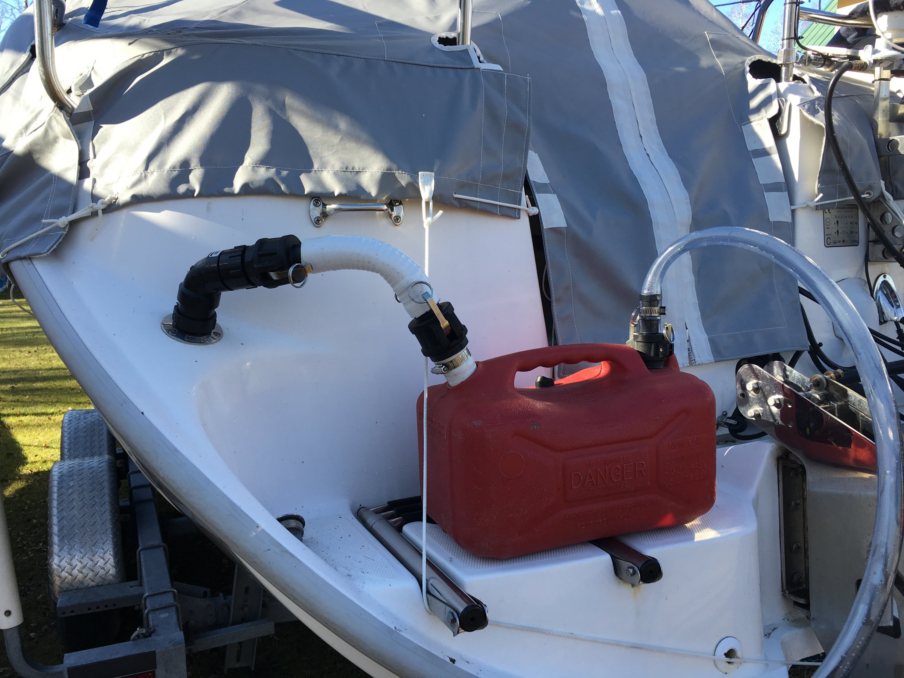

My Hunter 25 is a contender with an enclosed head and holding tank. However, it does not have a pump out. Built this unit designed to empty into a transfer tank for disposal. The marcerator pump inside the converted gas tank will lift up to 3 feet so has lots of power. The intake piping fits inside the gas tank through the back door.
It’s not a unit I will keep on board just use it when needed. Power will come from one of the two onboard batteries.

Clever. Where do you ‘drain’ that clear hose to?

These facilities do not exist on the lake. They did, but something happened.

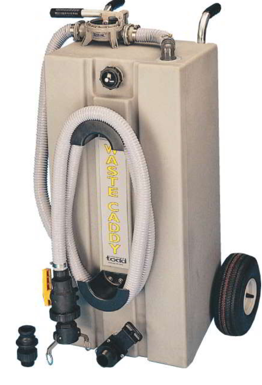

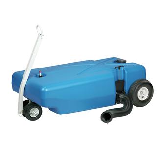

Neither of them floats. And that’s our problem, being on moorings and all. Docks are in short supply.

If it doesn't fit on board, you can float it behind. Charge other boaters for pump out service. Maybe it would pay for itself.

My little dingy will toss you in the lake for nothing more than. 2 second round of distraction. A 30 gallon tank is unfathomable.
