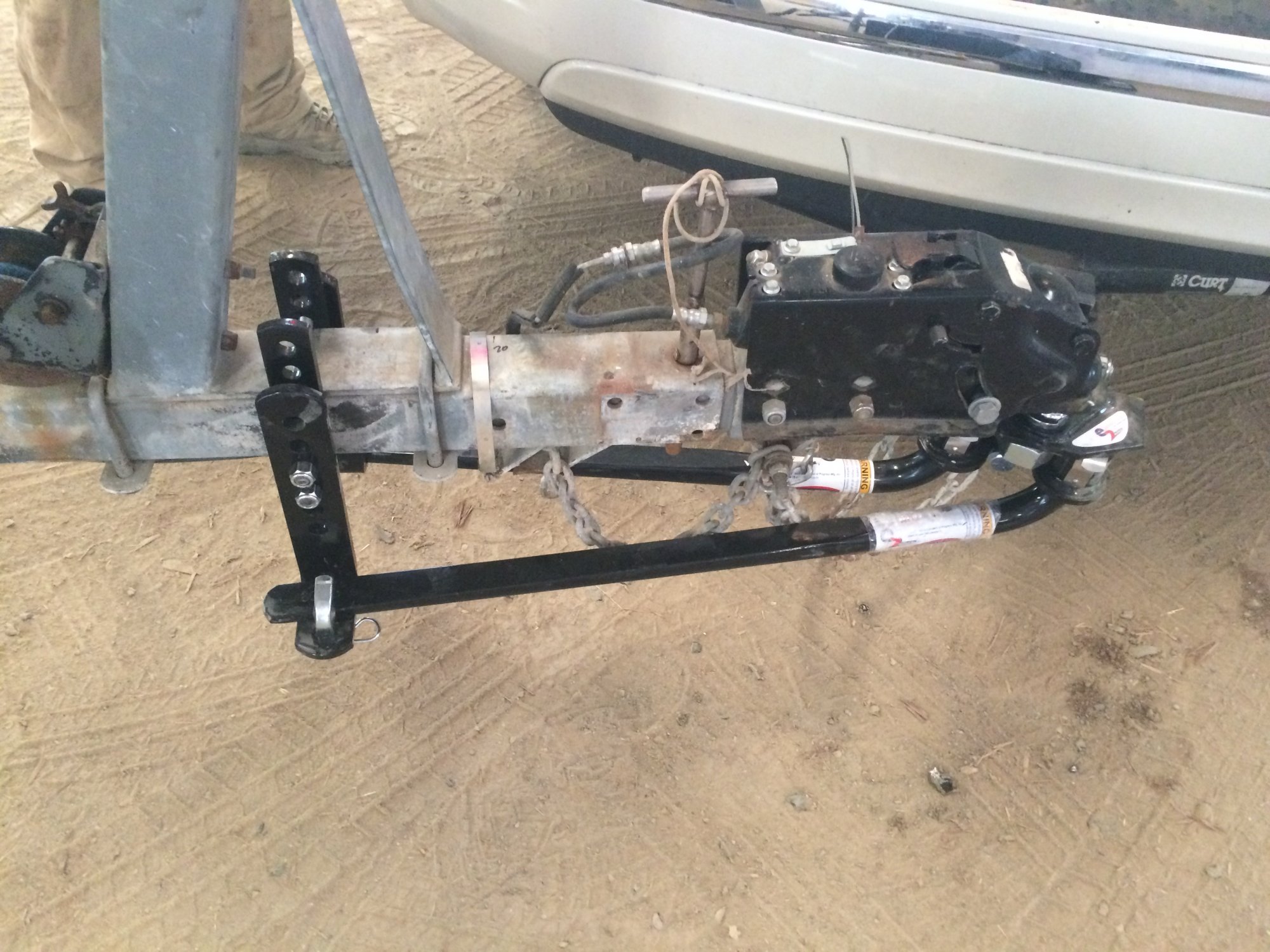

-So as a guesstimate, you can add 1200-1500 pounds to the published weight of the boat to get a "real" towing weight. Plus add the weight of extra gear and people in the car. Then check what the rear axle capacity is, so you don't overload it.
You may need to add a weight distribution hitch with anti sway bars for safety. You can get one made for use with surge brakes. Take a look at this 6000 pound WD hitch for boats and surge brakes. It's by Fastway, which is a subsidiary of Equalizer. You'll need a pole-tonge adaptor for the boat trailer ini addition to the weight distribution hitch.

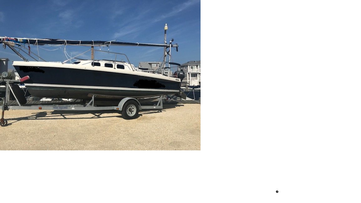

After viewing various boats, and after much thought and consideration of the suggestions from this thread, I settled on the Rhodes 22. I looked a few R22's, that pretty much spanned the range from project boat to like new.
Though it required expanding my target budget very considerably, I went with a marina-maintained, one-owner, newer (2012) R22 in outstanding condition. The boat comes with a number of attractive extras such as solar panels, dual swivel seats, life rails (vs life lines) and cockpit instrumentation (depth, wind direction & speed) and is on a custom galvanized trailer.
The biggest negative is that since it's November and I'm in the NE, she'll need to sit for a few months. That will drive me crazy and I'll have to content myself by doing a bit of cleaning and polishing with the big winter project being stripping and varnishing the tiller arm. Luckily, my sailing jonesing will also be temporarily interrupted by a couple of weeks of late winter skiing in the Wasatch.
Again, thanks to all for the advice and suggestions.

Ninety posts in this thread, and no pics of the new boat??? :mad:

Thanks man, now we can all bask in the warm glow of new boat ownership. She looks very nice
