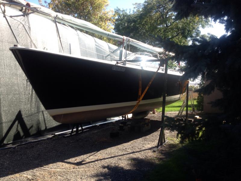

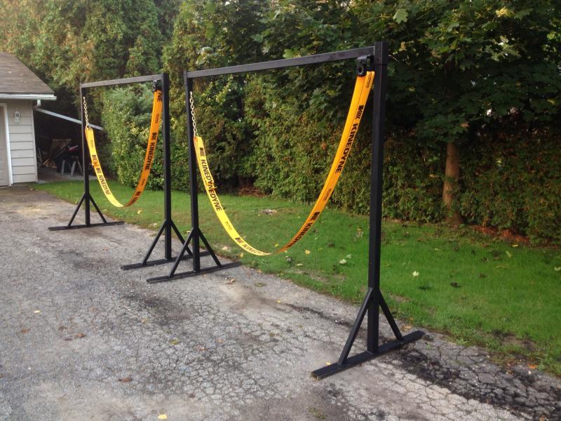

Oct 6, 2013
11
C&C 30 Lake Erie
Support the back of the boat, build an "A" frame setup to lift the front and roll the trailer under. Just make sure you make the "A" wide enough for the trailer to fit in between.
Made a system that's a little easier to use. About an hour to load or unload.
Boat is just about 5000lbs.
