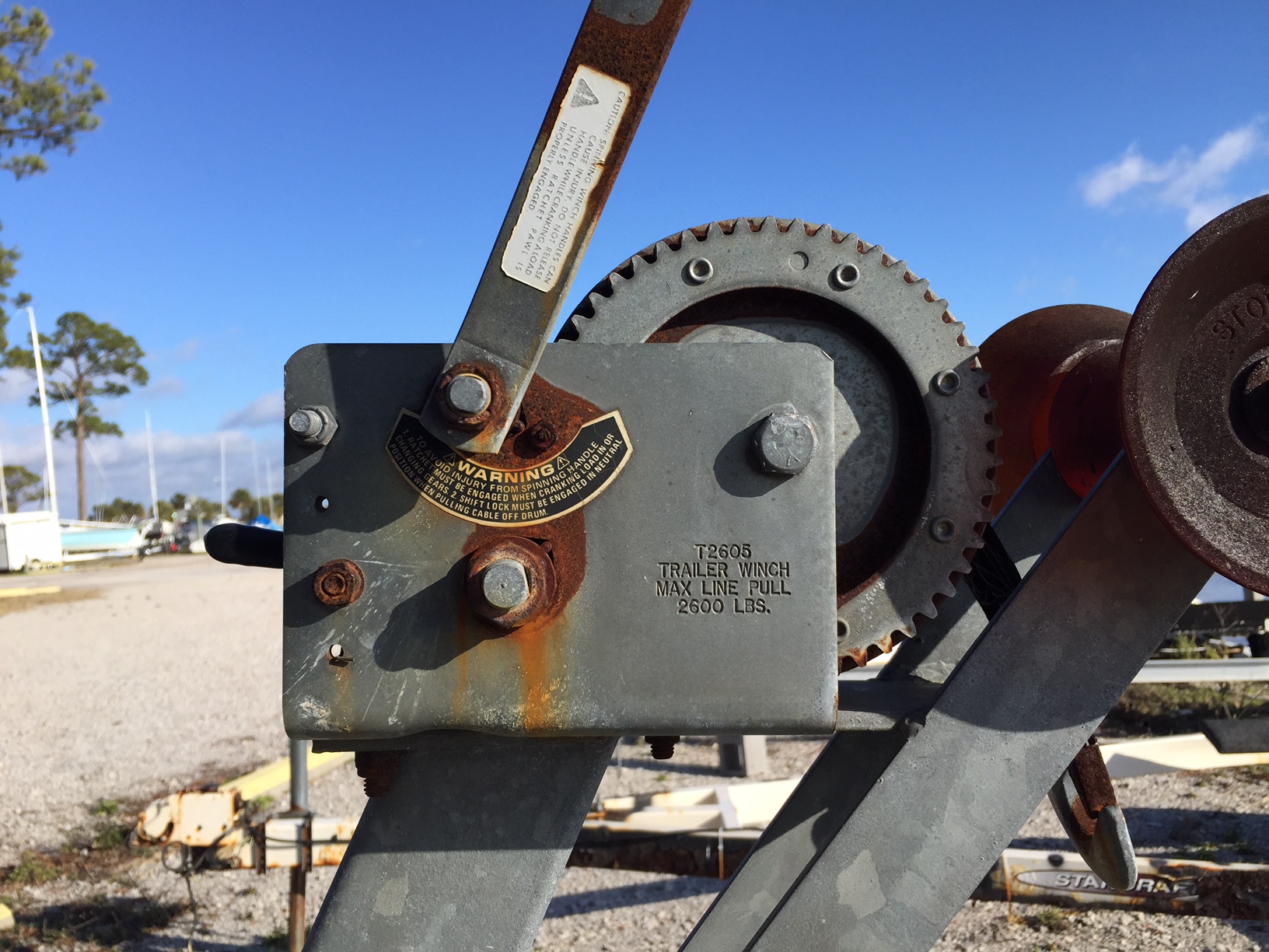

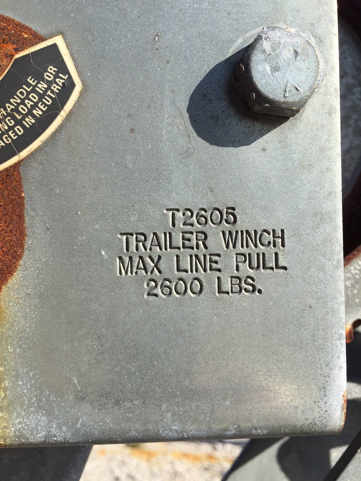

Was able to get down to the boat this weekend and I am pretty sure this is the original winch.
The winch is a T2625 two speed Trailer winch made by Fulton with a max line pull of 2600lbs
Now hopefully i can get some parts and rebuild it. Thanks for everyone's help. Chris
