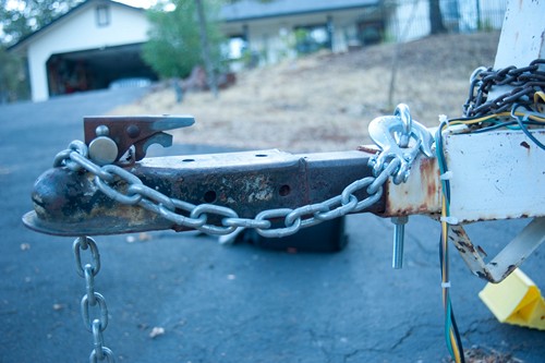

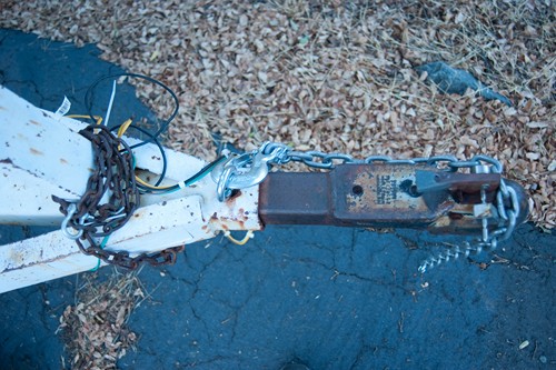

So, to be able to sleep at night, I figured I needed to modify the safety chain to allow it to be in place when the tongue is extended. I bought a 1/2" eye bolt, a big shackle and 3' of galvanized chain from a local Ace Hardware. I replaced the forward locking pin on the trailer with the eye bolt and fastened it with 2 nuts and a lock washer. I attached the shackle to one end of the chain, then snapped it on the eye bolt. When hitching up, I attach the other end of the safety chain to the truck hitch.
When I want to extend the tongue, I unbolt the eye bolt and the rear pin, extend the tongue, then bolt the eye bolt back onto the forward pin hole. A bit more hassle at the ramp, but I feel much more secure now.
