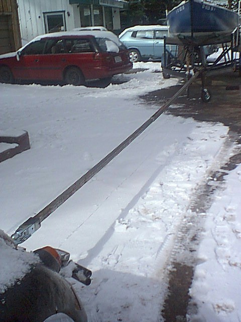

I thing Richie's idea is also viable. It would be simple to extend the handle as long as you need it. Attach a coupler to it an attach it to your hitch ball. The extension doesn't have to be that big. 1 1/2" square tubing would work. The load is under tension and that should be strong enough. It would be steerable and should support the tongue just fine.

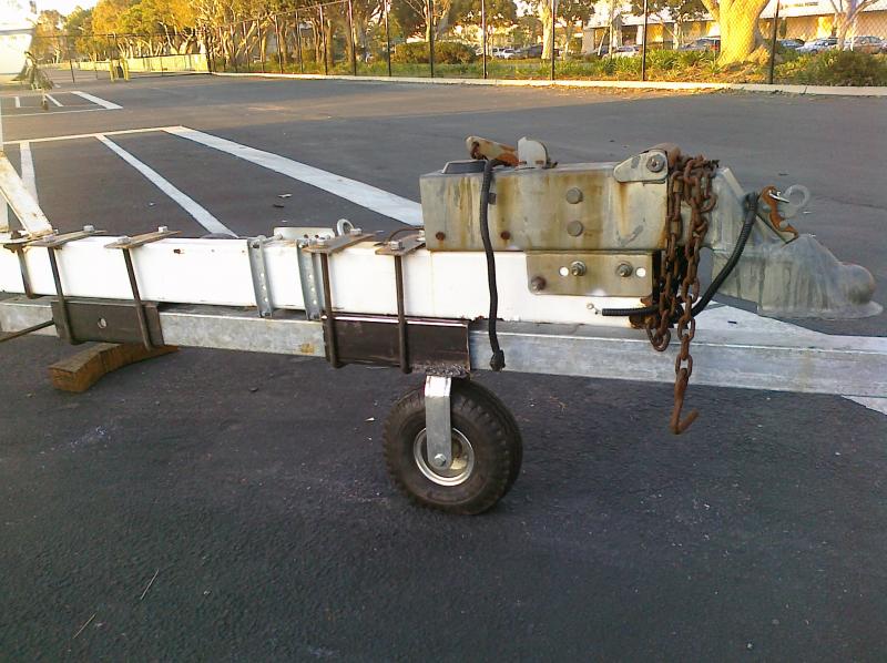

I would have gone that route if I had thought of it, but went with a retractable extender 12' that fits under the towing tongue. I do have a 6" swivel wheel welded under the receiver tube on the trailer tongue. The picture shows a 12" wheel that doesn't swivel. The original intent was to use that to back straight down the ramp. The 6" swivel wheel allows me to tow back to the storage with the extender out. I've got it down so that I can hook up and launch in about 10 minutes. At the bow the water is about 4' deep.
My ramp has a 6:1 slope. With the 12' extension and 18' from hitch to axle. The axle is 30' down the ramp making it about 5' deep.
With this set up I can launch easily with little hassle. I only tow about 100 yds so I leave the extension out when towing. I use to block the wheels and pull the extension out at the ramp but that was too much work. I decided one day to see if I could park it in mast up with the extension out and found I could. Saves me a lot of time and jumping in and out of the truck.
