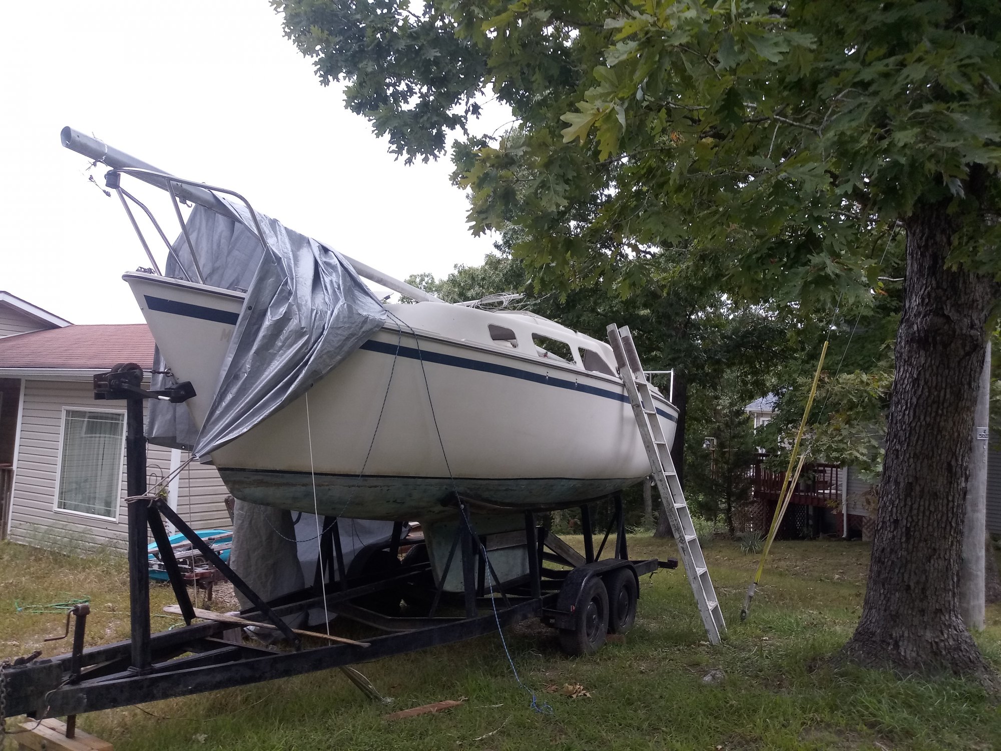

I don't have a better pic of the trailer, but here it is. It will be May before I can float this one off and start doing any work on the trailer. I am just trying to get a plan together.
Both boats are the same length. Similar beam, and within 600lbs of each other. Hull shape is similar.
If I don't end up doing pads, I may raise the bunks about 10" and bring extra 2x6's to shim the difference. (Stack on top of the bunks)
I have a feeling this is going to take a couple times of floating the boat on and off and seeing how things fit.

The easiest solution is to make the stands adjustable. Welding the top of the jack stands to the existing supports would probably work.
If you have access to a marina with a travel lift to pick the boat up, adjusting it would be very easy. If not, a tall helper and a good set of waders will be necessary.

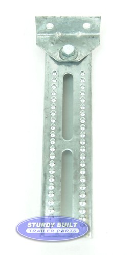

I stayed with 2"X6" bunk runners just like the picture you posted. I fabricated adjustable bunk board brackets out of channel and some angle. Similar to attached but longer. I found a publication from my boat manufacturer giving me the support locations and dimensions for the curvature. I didn't mill out slots but just drilled holes to mount the brackets to the trailer using U-bolts at the correct dimensions. Worked very slick but I wouldn't want to try that without the dimensions given or a travel lift to hold the boat while I took dimensions and drilled the mounting holes.
I also welded/bolted a front to back and side to side support to the brackets so I didn't have to worry about the brackets bending in a panic brake situation or a panic turn.
