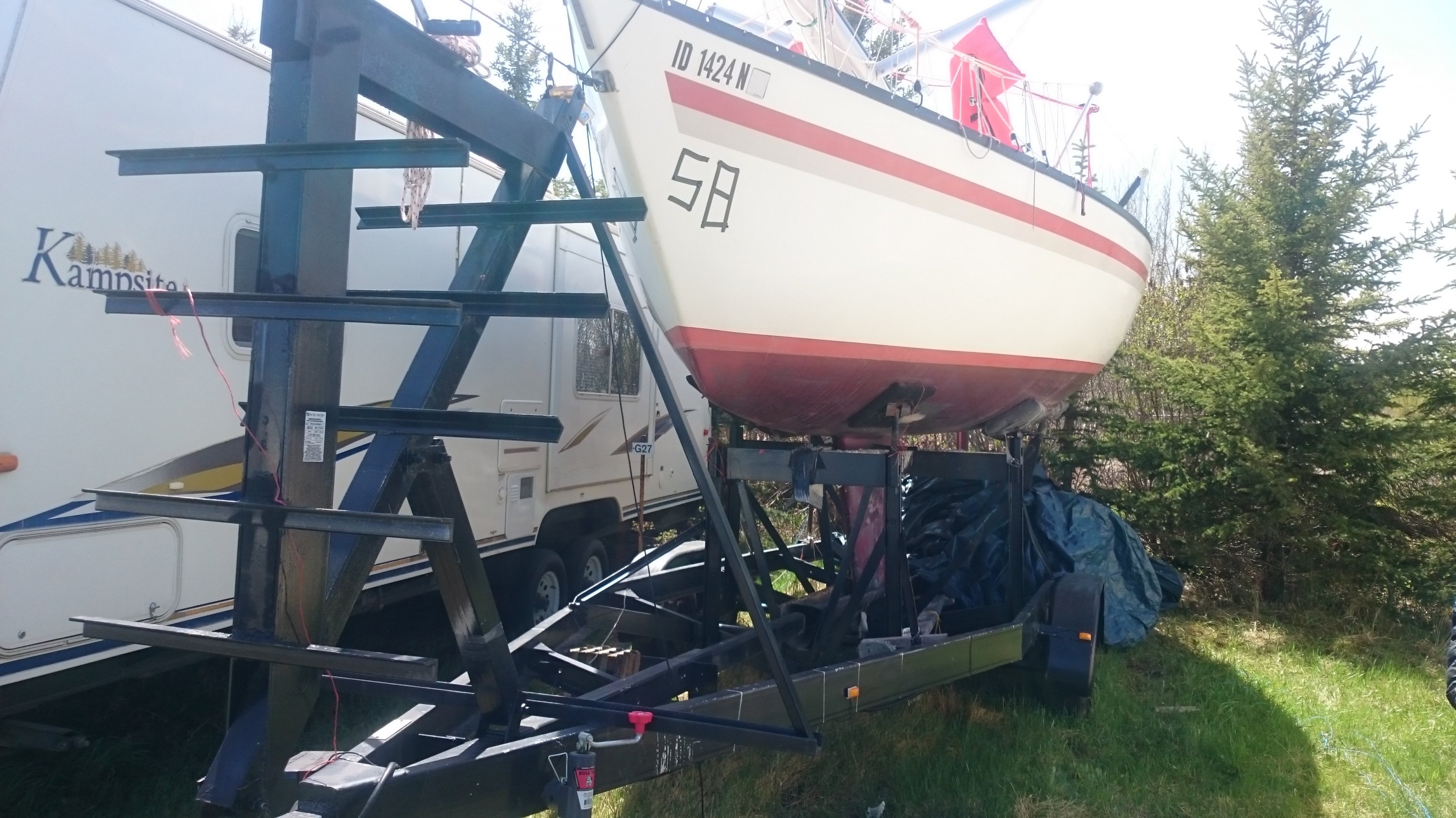

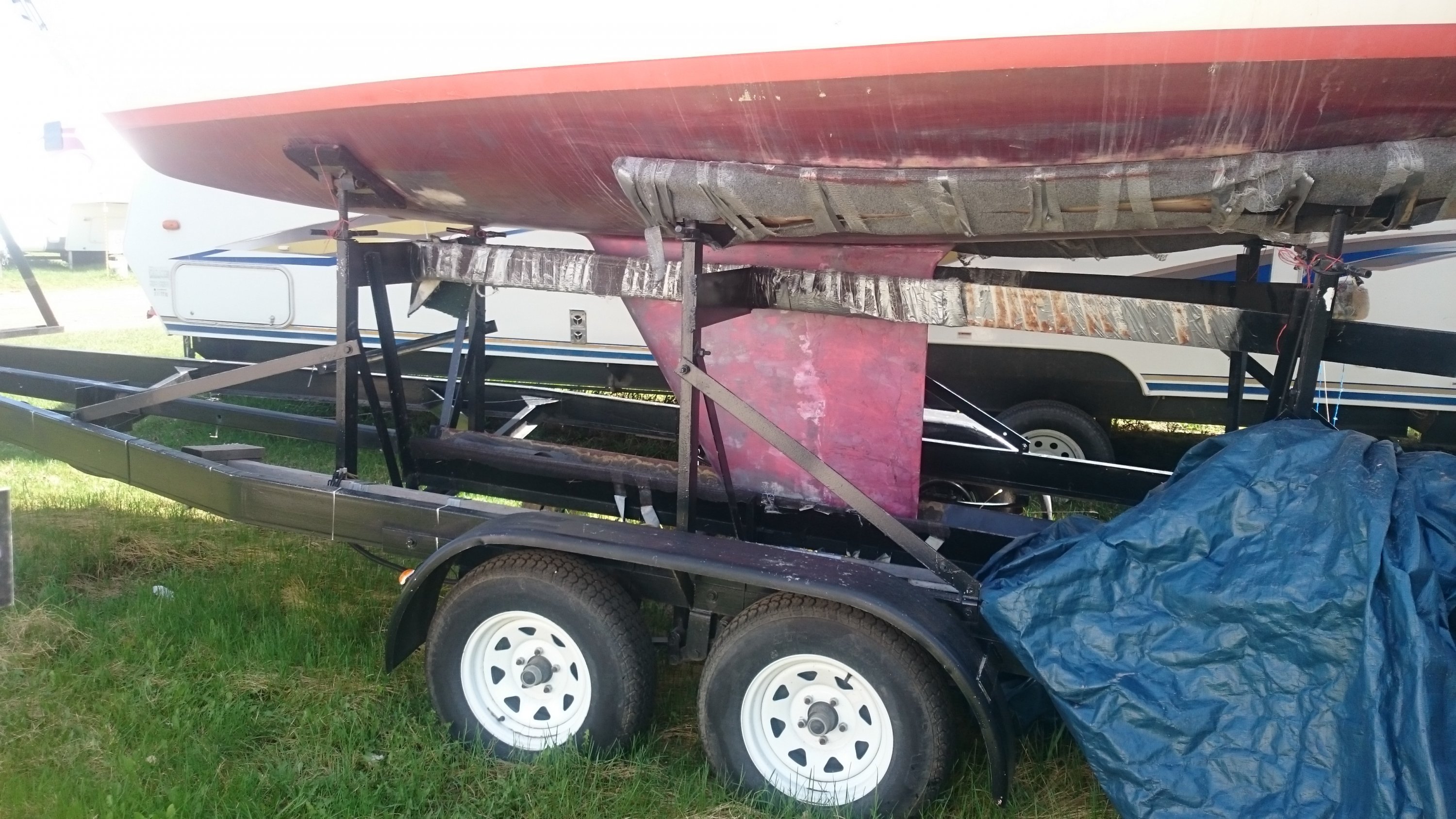

I probably would not do that with a Seaward 25. The point load on those aft rollers has got to be very high. They needed someone in the water at the large rollers videoing the hull deflection. Another method I've seen in Europe to keep the wheels out of the water used a cradle that rolled off the back of the trailer that had 10" rollers on it. The way they load big garbage dumpsters. The keel was about 2" off the concrete. You could design it where the aft rollers were adjustable to ramp angle and put the cradle/boat in level with the water. I looked at a lot of ideas, including the one in the video, before I built my pivoting keel tray/bow stop trailer. Still have to get the wheels wet but I would still check bearings on any trailer anyway.
