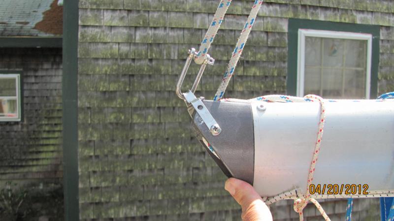

You can use quick release shackles at both ends of your Main sheet and boom vang.
It may be possible to stow your boom inside your cabin and if so, you could keep your Mainsail on the boom with sail ties and a mainsail cover. I'm using this system on my boom:
http://www.cncphotoalbum.com/doityourself/sailties/sailties.htm
I'm not sure about how your topping lift is configured. My topping lift comes down from the top of the mast. If you have a similar set up, you could attach the topping lift to the back of the boom after the mast is up, and lead it right out of the cabin. It's like having a second pair of hands and you can stow it back in the cabin the same way when you get ready to break it down.
The boom's goose neck can have a rigging pin with a large cotter ring that is easy to put on, or you may be able to use a press button quick release pin. Don't use a "Fast Pin". Once you get your boom attached to the goose neck, you only need to get the sail slides in the mast and hook up you main halyard shackle which should have a quick release shackle also.

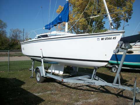

Sounds like you might of already committed to this boat, but if not I'd think real hard about it. They sound like nice boats, but maybe not a great boat if you want to trailer a lot and it doesn't even sound like it is your first choice for a boat, but that you think it is a deal that you can turn into money.
There might be a reason that it is a deal either something with the boat or just the fact that there are a lot of deals out there right now. I've found that estimating costs for a boat or like fixing something on the house and that it usually ends up about twice what I thought it would at first. If you think you can find a buyer even at twice what you bought it for but the fix up costs are twice what you thought they would be then you might not be very far ahead. If it takes some time to fix it and to then find the new buyer that will pay top dollar and you don't really have the boat that is best for you..........take it from there............

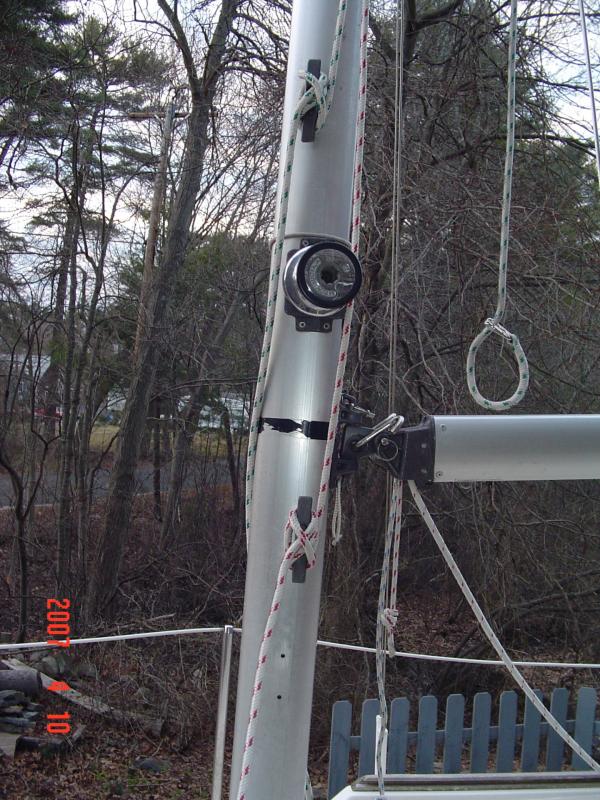

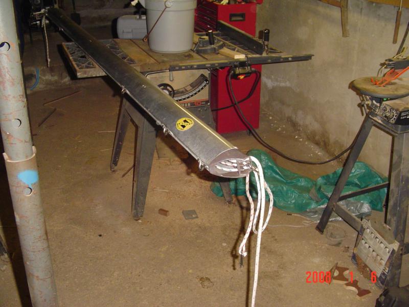

My O'Day 222 has a topping lift that comes down from the top of the mast and it hangs just short of the end of the boom with a single sheave attached to the end.
My boom has three internal control lines inside which come through near the goose neck fitting with three cam cleats. One the line is for the clew outhaul, the other is for the reefing, and the third one is for the topping lift which exits the back of the boom and through the topping lift sheave and to the back of the boom via a quick shackle.
This makes it easy to connect and disconnect the topping lift.

After I get the mast up with my Gin pole and boom vang to raise and lower the mast, I attach the topping lift control line which exits out the end of my boom, through the sheave at the end of my topping lift. Then I let the topping lift support the back of my boom while I lead the boom out of the cabin where I generally keep it stored with the sail and the cover on it. It's like having an extra pair of hands in getting the boom connected to the gooseneck.
I just want to point out that my boat is rigged a little different than the Hunter 23 and this is how I rig mine. You may want to experiment and try other ways to rig your boat. Whatever way is the easiest way is the best way for you to go.
