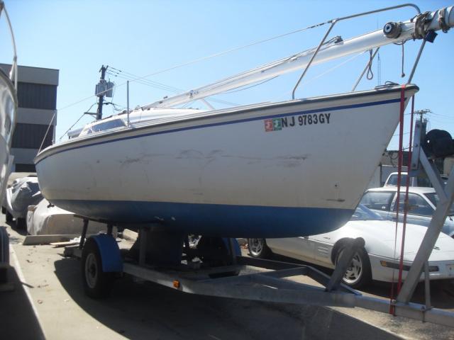

I am picking up a Hunter 23 today and when I looked at it yesterday I noticed it was about 1 foot back on the trailer. I just thought the owner was lazy or didnt know what he was doing but I have see other web pics of Hunters sitting the same way. Its the same trailer I am 98% sure its original but is there a reason they are sitting so far back? Are they difficult to load or do they need the weight back on the trailer?
Also there is what appears to be plywood under the keel. Is there suppose to be any weight on the keel when trailering?

Keel should bear some of the weight, sitting on that plywood base. Prob has a set of stops that the front of the keel should more or less be up against. Bunks on side should keep the boat vertical. What do you mean "1 foot back" - from what? Do you mean the bow is not up against the trailer bow roller, with a 1 ft gap? I'd be sure the keel is well supported and the bunks are flush on the hull. My bow ends up about 4 inches from the trailer bow roller, however I think the position of that roller can be adjusted, so that may not be a valid "test".

Picture on trailer
Looking at it again it does appear its closer to 4-6" from where it should be but the bunks are flush with the hull. If you look close you may be able to see that the keel is not far up enough to the bumper.

Nose weight for towing? On a two wheel trailer this needs to be "Not too much and not too little" and the boat's position is the means of achieving this.
Will also be influenced by whether an outboard motor is present.

From what I've read there should be about 200 lbs of tongue weight on the hitch. Try lifting the trailer at horizontal. You can also actually weigh it with a scale. I have read many posts that say people put their outboards and other equipment/supplies in the v-berth to increase the tongue weight of the H23.
So, if the tongue weight is around 200 lbs then the boat is where it should be on the trailer.

That is what the owner said, the tide was not cooperating and that was as far as he could get it. I picked the boat up tonight and I did notice that the front felt light. I actually thought about moving the outboard further forward but just wanted to get home so I settled at driving 50-55mph.

The boat sits on the bunks and not on the trailer rails so these do not need to extend all the way back. The weight of the boat needs to balanced so that the trailer sits horizontally leveled and proper tongue weight is applied to the hitch. This weight adjustment is performed by moving the trailer axle back or forward until proper balance is attained. The bunks should be adjusted forward or aft so that the hull seats comfortably while maintaining the weight distribution. They can be raised or lowered to distribute the weight between the bunks and the keel. The bow stop should then be adjusted to the bow of the boat in that position. Remember a sailboat is floated on to its trailer and not winched up like flat bottomed powerboats. Sometimes due to tides or the stepness of the ramp it is not possible to bring the bow tight to its stop so don't despair just tighten the winch strap and the transom ties. A couple of inches will not make a big difference.
