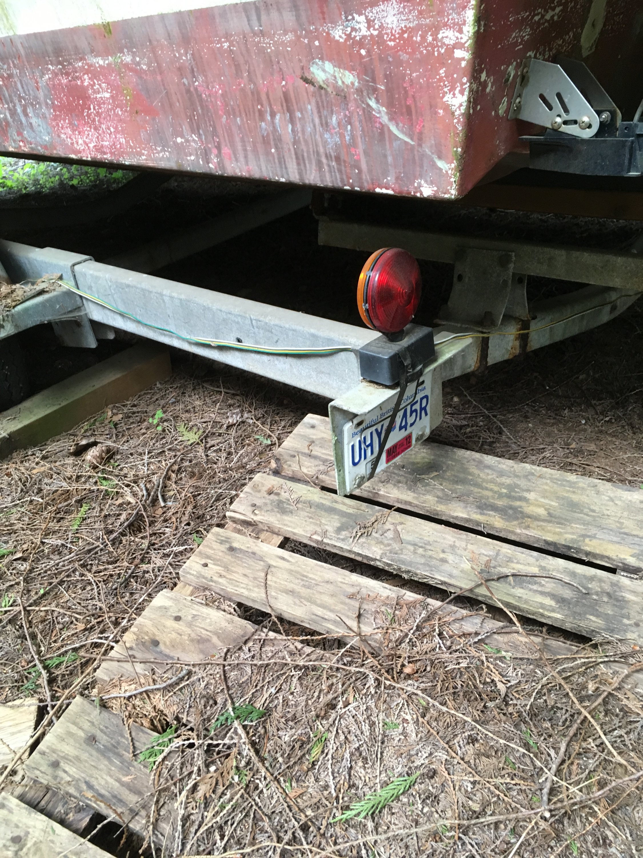

Mar 15, 2013
197
Islander 32 mkll Comox Hrb.
I got sick and tired of fixing trailer lights years ago. I've been using magnetic ones. One set works on all my trailers, they cost about $35.00 and have worked flawlessly for fifteen years! You just chuck them in the box of the truck before you back down the ramp.IMG_1024.JPG

I got sick and tired of fixing trailer lights years ago. I've been using magnetic ones. One set works on all my trailers, they cost about $35.00 and have worked flawlessly for fifteen years! You just chuck them in the box of the truck before you back down the ramp.View attachment 137191
Listen to SCOTTY! He's in the right track.. Take them OFF and down you go! Also when you need lights to tow anything.. you have them. You also have lights even for road emergency's, such changing tires on the side of road when your trailer BLOWs one. I too have used them for my P18 and even the led's will have problems. Any bulb's or wire that is in any water will degrade it in short time.
