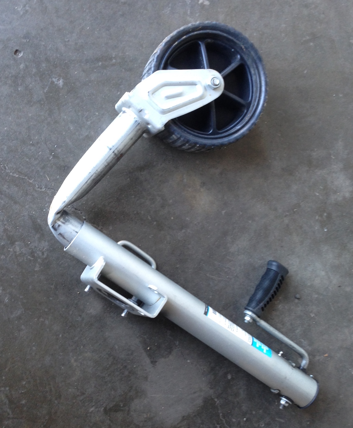

I forgot to flip up my trailer jack and as you can imagine some interesting things happened. Luckily what was left of it served its purpose for haul out. My boat is approximately 5500lbs. The boat has been moved forward on the trailer for more tongue weight and as a result the jack is 3-4' aft of the hitch. The trailer is pretty heavy duty so it's not light either. What rating would you recommend for this trailer this application?

Is there any validity in thinking that one (e.g. 1000lb) jack is stronger than another? While my old jack might have supported 1000lbs in the vertical, the side to side movement made me nervous so I replaced it and moved the old one to the rear. The old one has a wheel. The new one has a plate.
Aug 1, 2011
3,972
Side to side? Just depends on the amount of tension and the failure point, and other critical engineering data, none of which we would ever have access to, but we do get to see the end result. :)
Field testing at its best!
I think I'll pick up a 1500lbs dual wheel jack from harbor freight for $30. I doubt the last one was rated for more than 1000lbs. It held up well until it hit a pothole
Aug 1, 2011
3,972
Few, if any will survive a pothole. Mine went head to head with a concrete slab about the size of a curbstone. Its a jack, not a dolly - that task takes something more robust.
