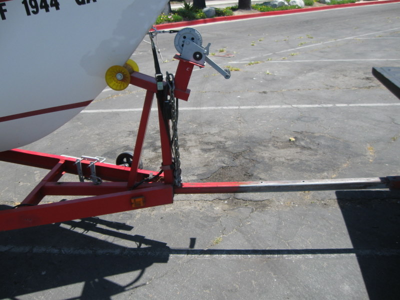

I have trailer extensions on my O'Day 26 trailer and on my Amphibi-Con trailer. I installed both myself as well as building the AC trailer. The extensions are essentially a 20 foot steel box tube 3 by 3 with a 1/4 inch wall. On the end I welded a trailer coupler to take the ball on my truck. The extension in both cases rides next to the trailer tongue and is contained by two larger box tubing sections about 4 inches in length. One welded near the winch bracket and the other back on the framework. I drilled a half inch hole through these containing sections and through the extension bolting them together with a class 5 - 1/2 inch bolt. Pulling out to the max. length I then drilled a hole for the bolt to hold the extension in place when fully extended. My boats weigh 5100 and 4900 pounds respectively so you might get by with smaller tubes of the weight is less. My Class E Scow has a 1-1/2 inch round extension on its trailer. I think the extensions/couplers/larger tubing cost me about $135.00 total. It is a great help in the heartland when the reservoirs are low and the ramps don't drop off as they do during higher water. I get about a 12 - 13 foot extension this way. Different trailers will give you different dimensions. Good luck. If you, want email me off list and I'll send you pictures of the set up if this description if too confusing.

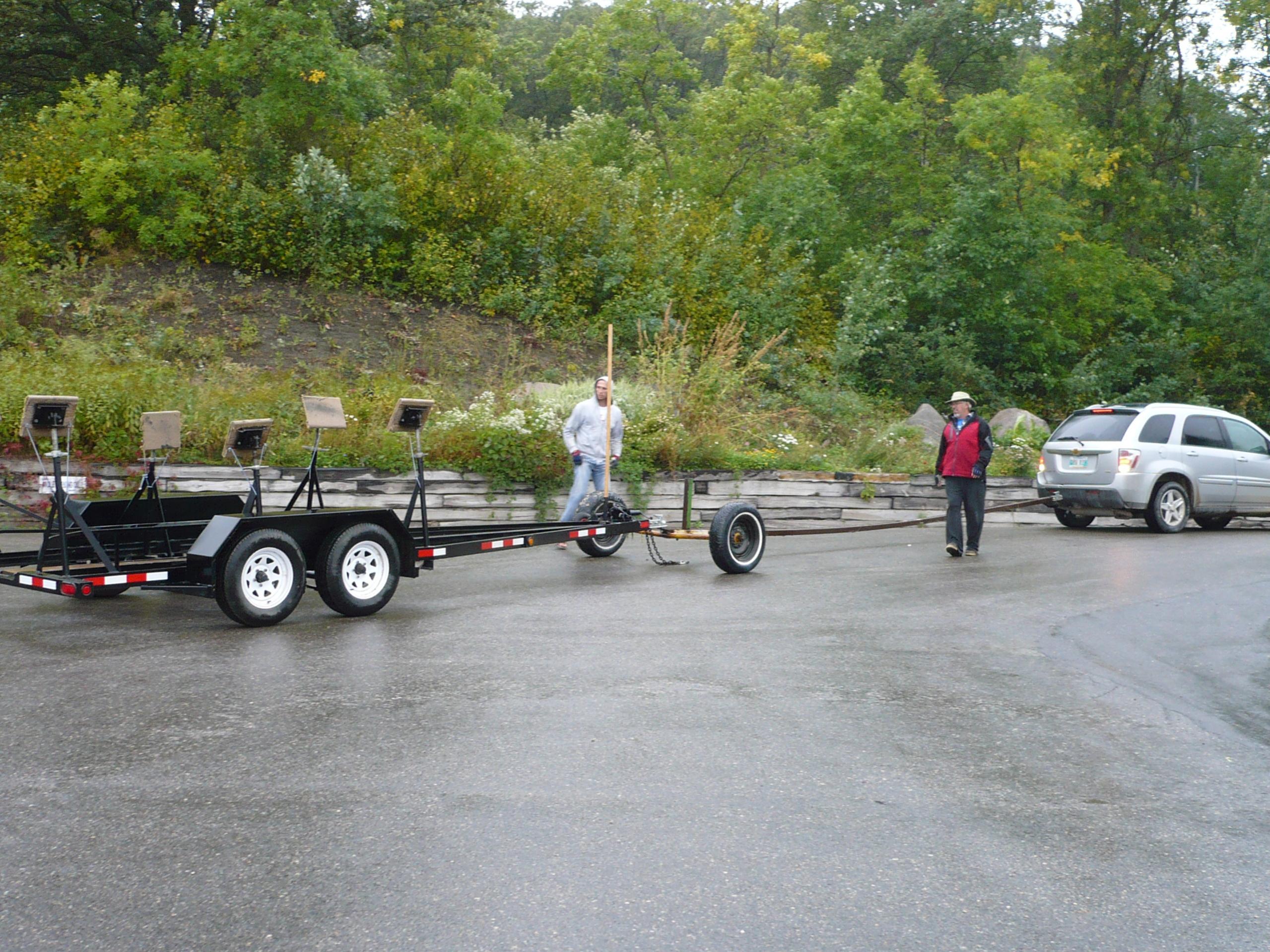

If you belong to a yacht club or marina, suggest a wheeled extender

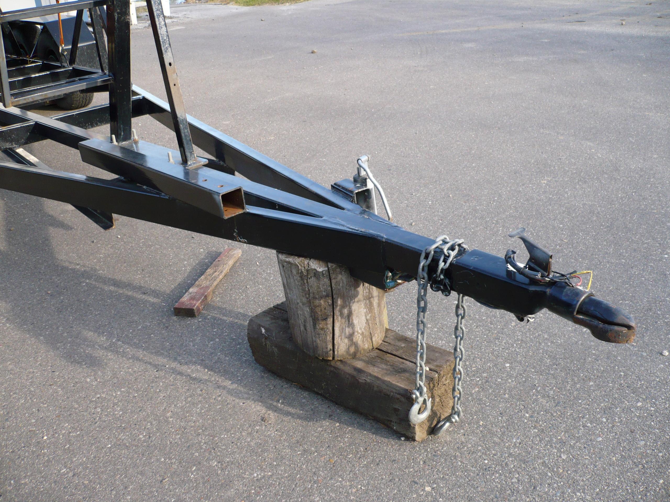

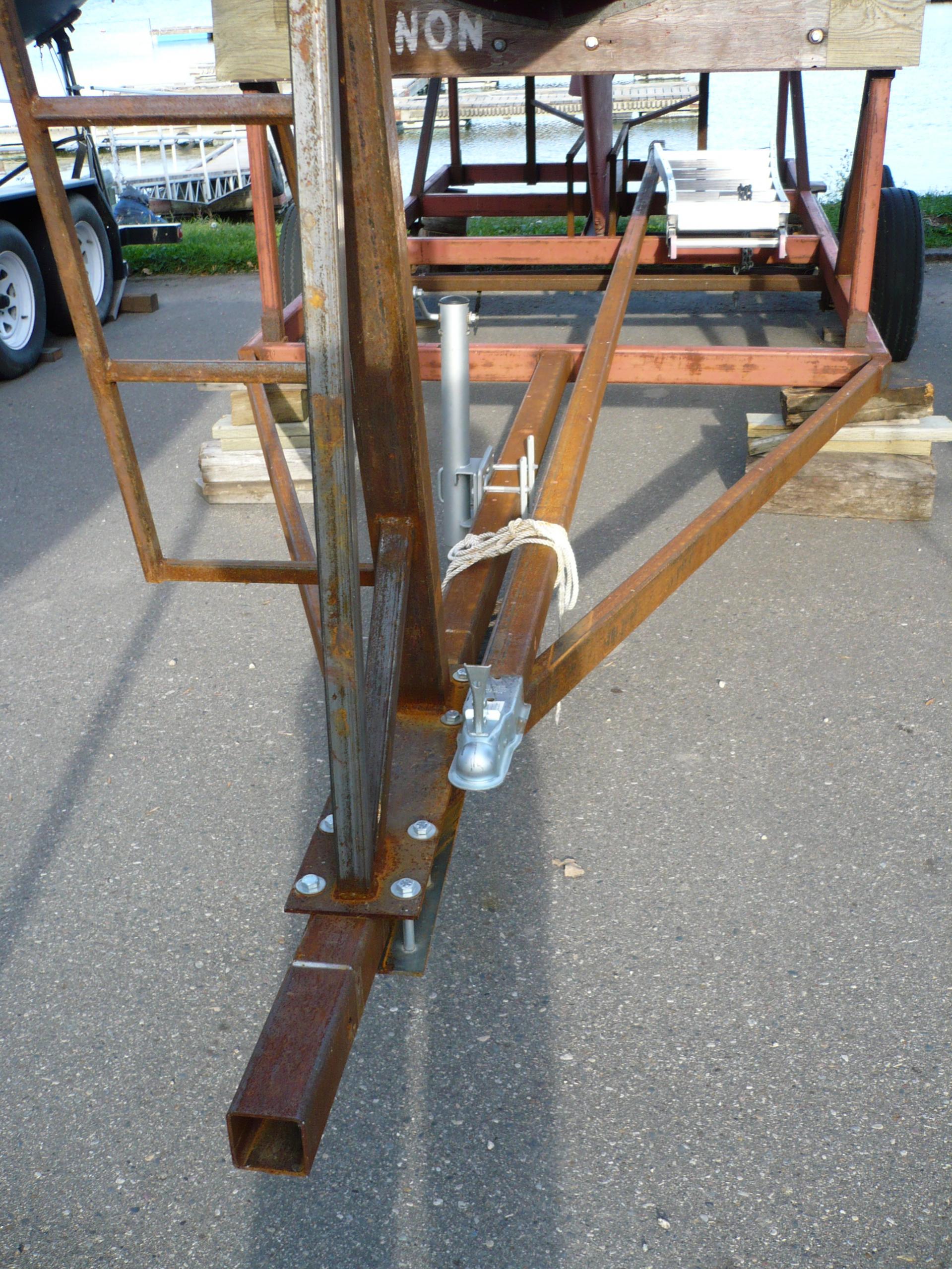

At our yacht club the water levels drop in the fall. That coupled with owners who have boats deeper than the ramp accommodates for regular launching has led to the creation of a wheeled tongue extender. It puts the trailer way out there for launching. Attached is a picture. I have also attached a picture of my sliding extension. It slides out about another 7 feet from this length.

There is a drop pin that locks the extension in, or out. Another version is a similar square tubing that simply folds alongside the tongue. Still another version just uses square U bolts to clamp to the underside of the existing tongue. There are lots of variation on the design depending on how much money you want to spend on labor welding, parts etc. The chapest is likely a box steel tube, with a ball coupler and a couple of square U bolts. It would be more labor intensive each time however, and if you are using the 'field and launc' method each time you go sailing throughout the season, this may get tedious. I think it cost me $75 to have a slide in tongue extender, and locking pin mechanism manufactured. That included the cost of the parts, excluding the ball coupler that was simply moved to the extension. Attached is another picture of the pin mechanism. That's a wheel jack and spare tire on the right. Pin is held in place by an upright tube so that the mecanism can be extended without the help of a second person. The pin is pulled up and rotated a 1/4 turn so that the flat steel seen rests on top of the tongue. The tongue extension is pulled out slightly, and the pin rotated back so that the handle is off to the side of the tongue. The extension is then pulled slowly out the rest of the way, and when the hole lines up with the pin, ... plunk... gravity drops the pin into the hole and locks the extension in place. When shortening the extension, the same procedure is used. The trailer wheels need to be blocked if you are using your vehicle to extend or retract the extension, but it can also be done by hand. I credit my welder with this design; I only thought of the upright tube to hold the pin in place. The chain simply keeps the pin from taking a walk. For highway trailing, I have a hole through the pin under the tongue that accepts a scissor clip so that the pin does not jump out at highway speeds.

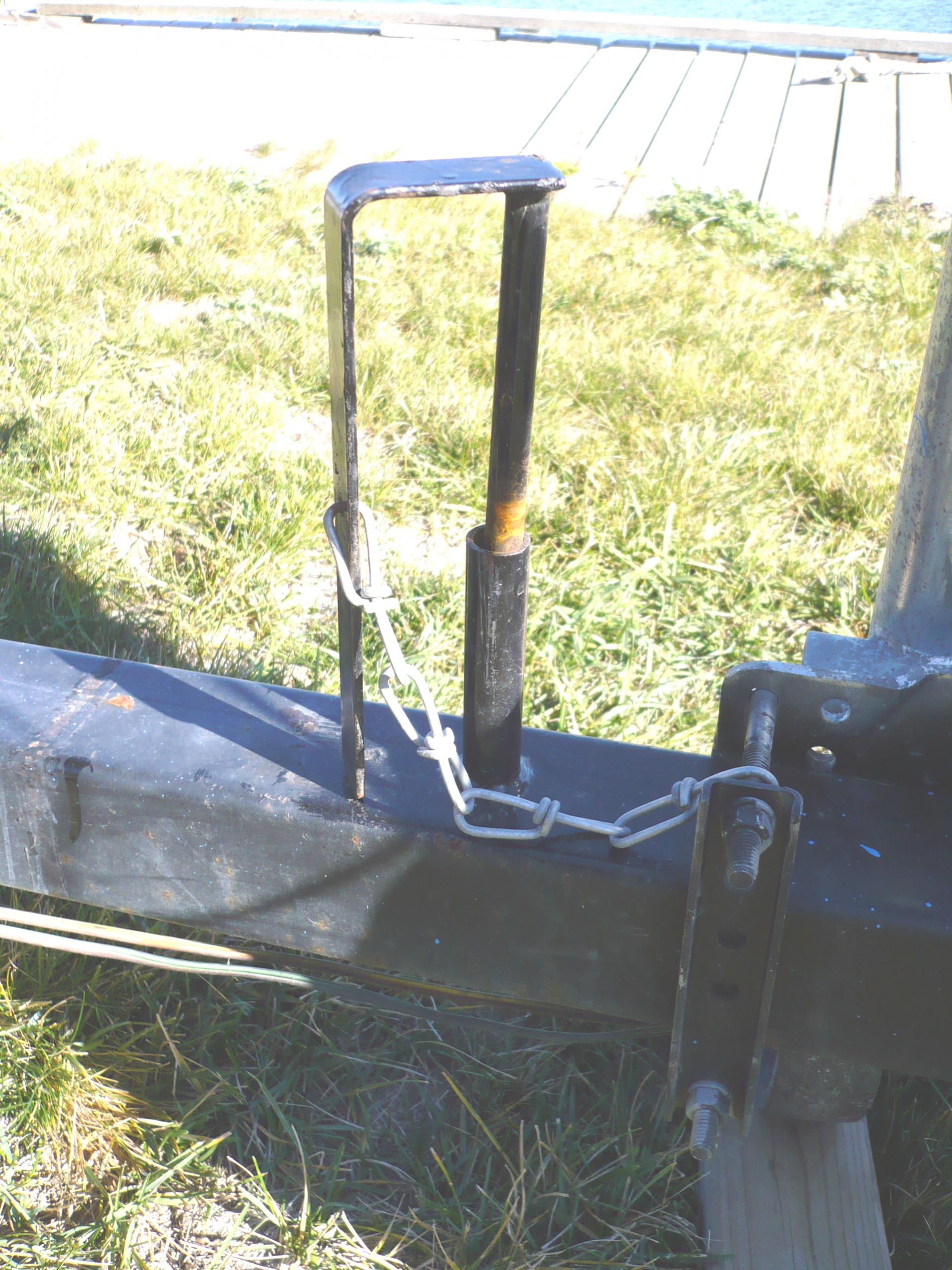

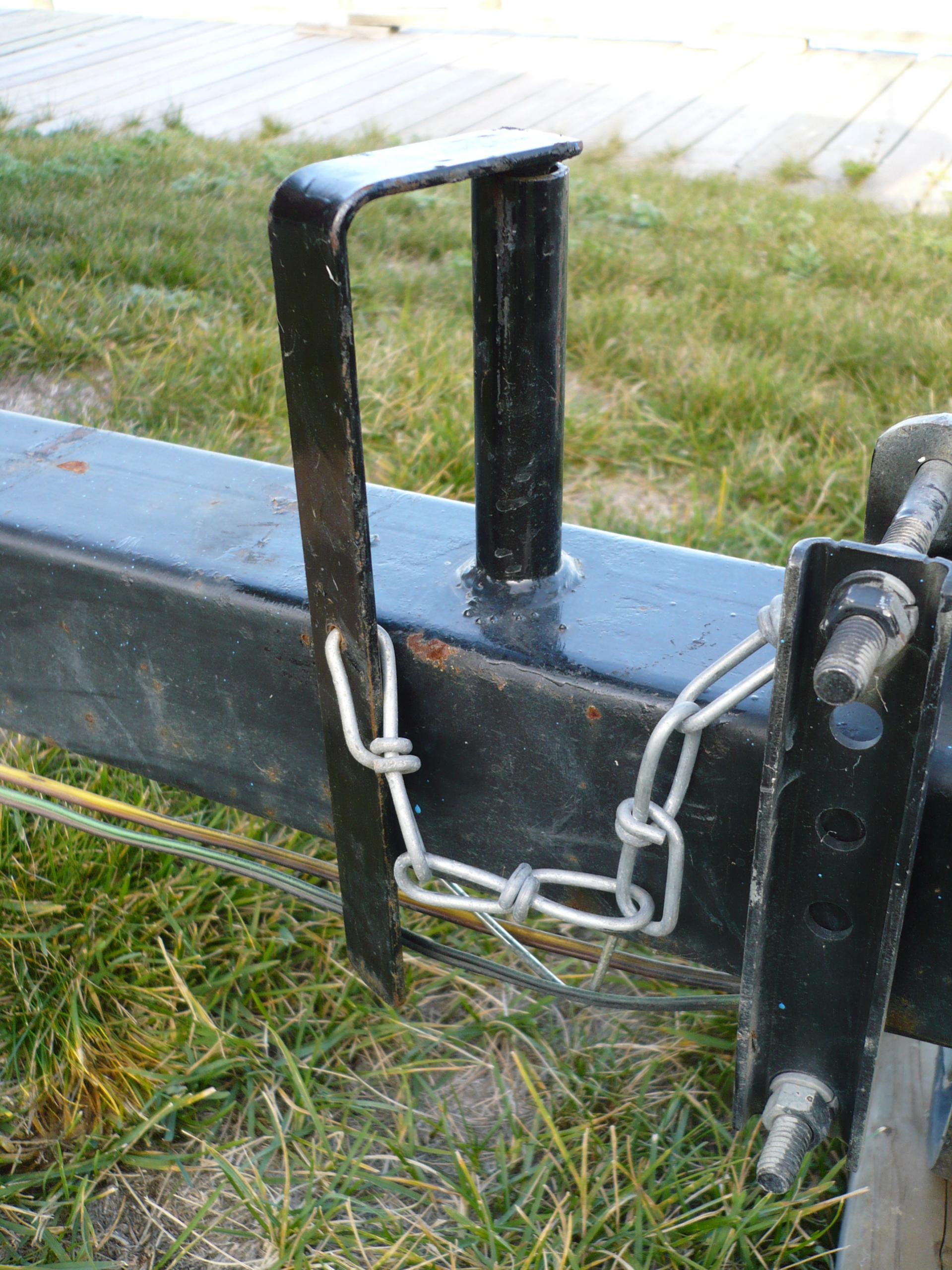

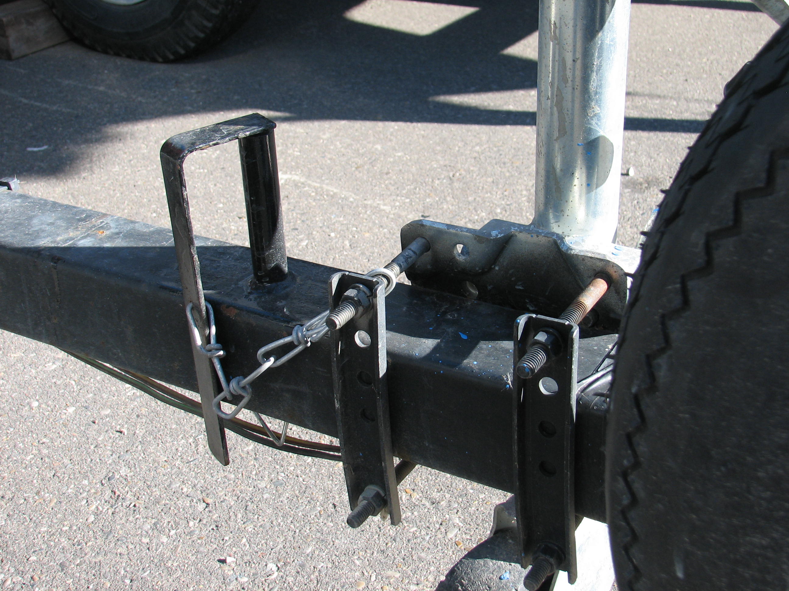

Oldies... the pin is down. When up, the flat iron looking strap is turned a quarter turn to have the lower tip of the handle rest on the top of the tongue. This lifts the pin inside the upright aligning tube and disengages it from the tongue extension. Hope that answers your question. I was down there yesterday and took a few more pictures that hopefully are a bit clearer.

Aha! the pin is part of the assembly(for some reason I thought what I was looking at was a type of guide for the pin). I had a bit of time today to look at the front of my trailer and found that there is no square tubing already running back from the reciever to run the extension tube through. Would I then need to first have an outside tube constructed with proper tolerances to allow the smaller tubing to run through(there is about 10 ft between the hitch and the bow edge but it's all open until the front keel rest)?

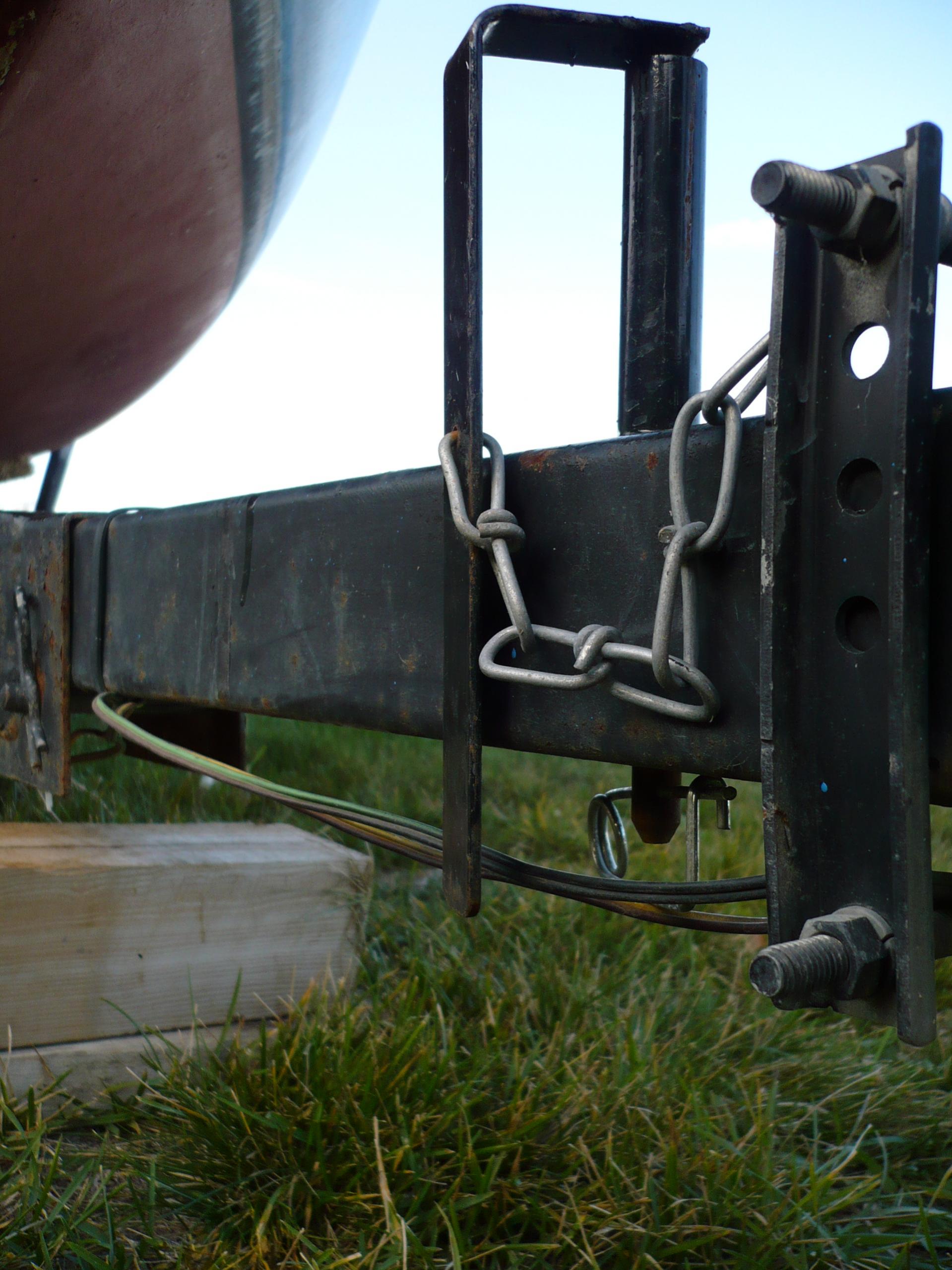

This was from a neighbours boat. I did a bit of a walk around of the marina to see how others extended their hitches. It really does not matter how it looks, as long as it functions to place the trailer in deeper water without soaking the tow vehicle.
519
Sundance Sundance 20 Weekender Ninette, Manitoba, Canada
In this position the pin is not engaged in the inner sliding extension which allows it to be slid in or out. Moving the extension a few inches, then rotating the pin so that the handle is no longer supported on the outer frame allows the pin to sit on the inner extension ready to fall into the hole when the extension slides into position.
The only drawback is sliding the extension too fast so that the pin accidently 'skips' over the hole. This happened this fall when retrieving the boat, and the pin had dropped behind the extension tube. When I went to pull the boat and trailer out of the water, all that came was the extension. Thank goodness it was only knee deep, and we were able to pull the trailer, replace the tongue, and try again.:doh:
