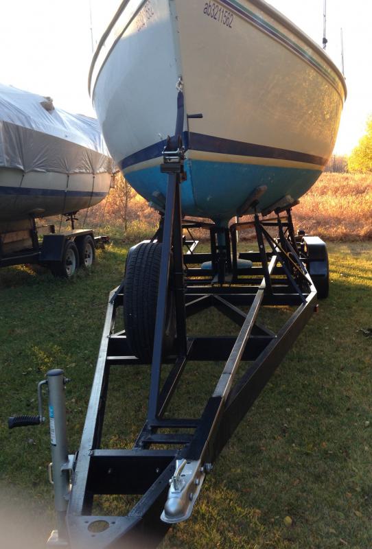

Interestingly, the new trailer I'm having built actually has two tongues, like this one here:
Apr 19, 2015
13
catalina 22 Roosevelt lakre
Do seem to make it easy do they. So u still have to unhook. I made a wooden chock to put under one wheel when Dennis pulls the truck forward. Same for backing up

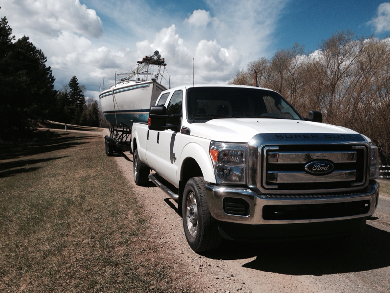

I used a 15 foot 2x2 aluminum bar, that has a 5/16 wall for a pushbar. What you can't really see from the picture is the front of the assembly that has a pivoting attachment point, so that the bar can pivot in the vertical plane to accommodate the changing angles of the ramp. There is a retractable assembly for the spare, which doubles as a dolly wheel. The winch strap is used to raise and lower the wheel. It works slick, and with the keel guides makes getting the 270 on and off the trailer really nice.
Apr 19, 2015
13
Honestly I'd be a little scare getting up on a boat that high. Now I see why you have such a long extension to get it in the water. You must be a super backer upper.
Aug 1, 2011
3,972
It's actually a royal pain backing up with the 350 as its a long wheelbase, but with the triple axle setup, it rides just beautifully and the 6.7 gets pretty decent mileage.
