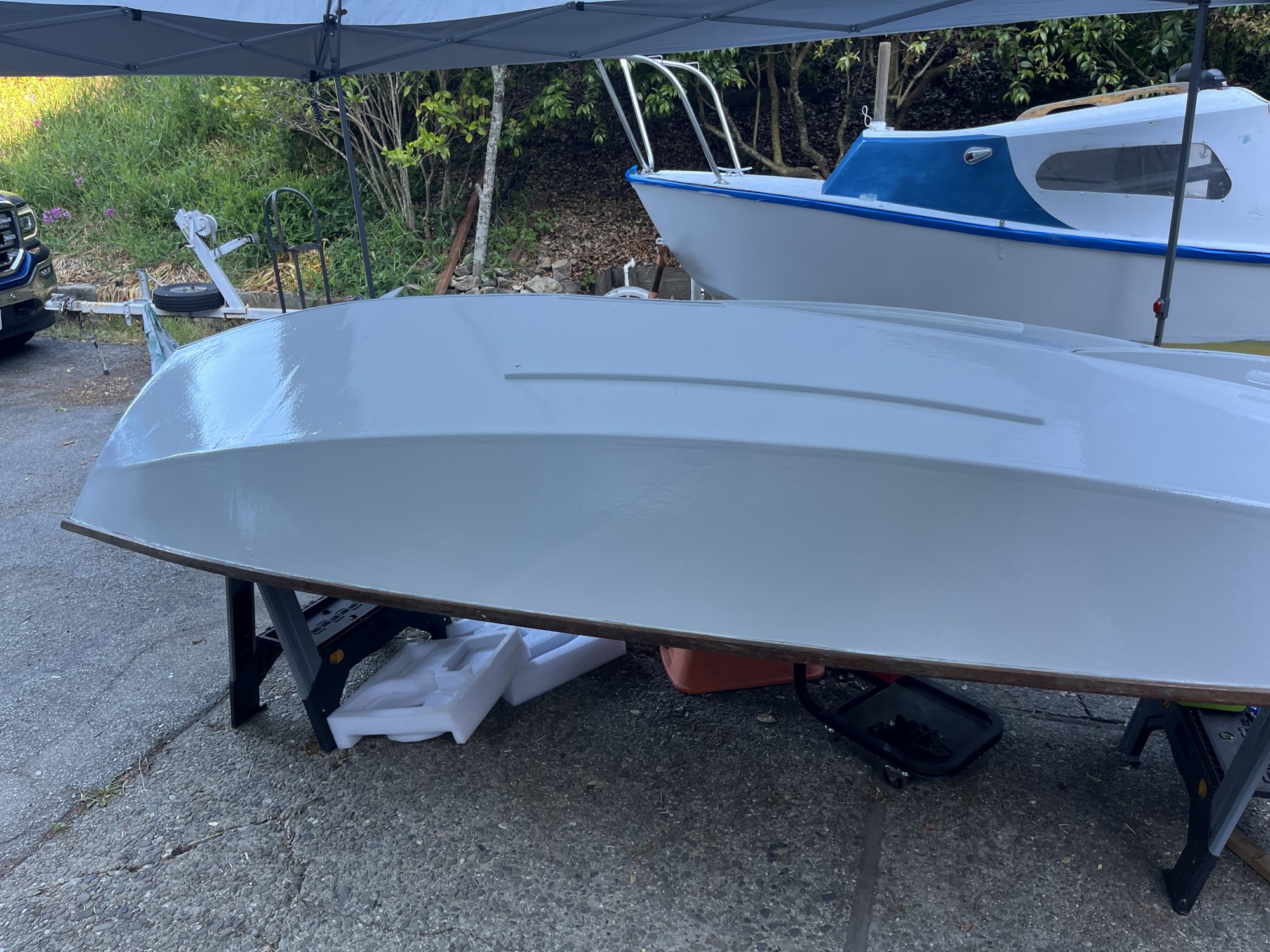

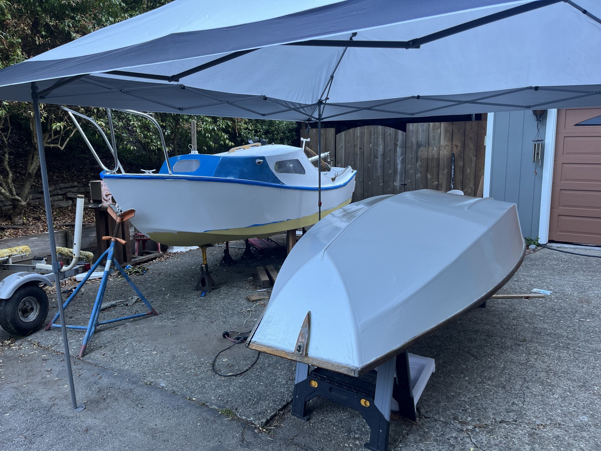

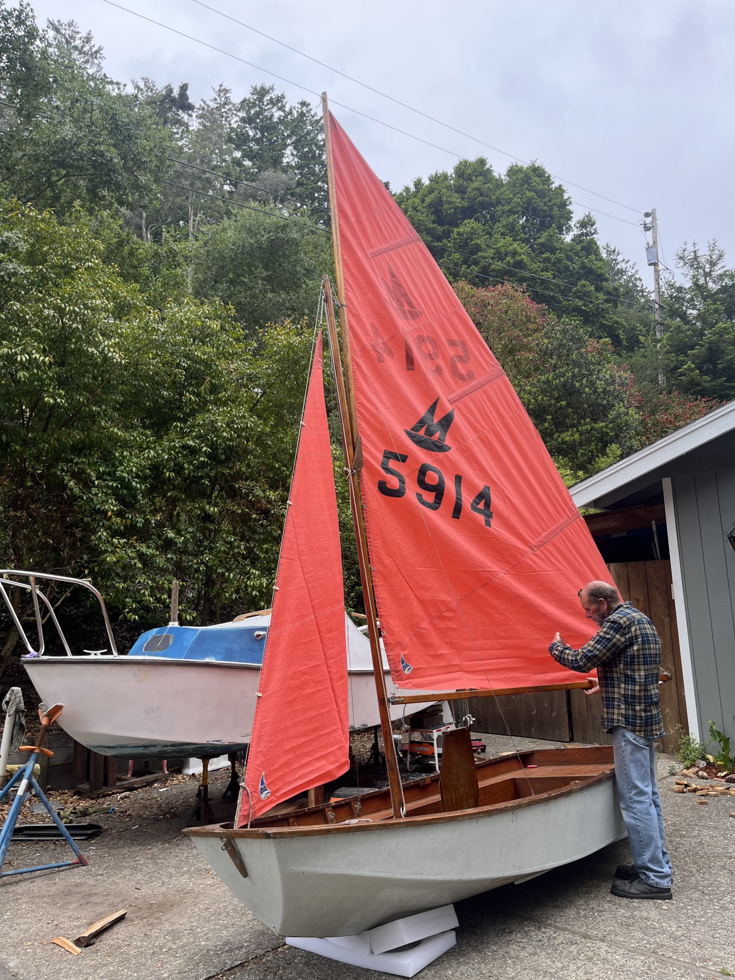

Just for fun, here are my two boats I'm currently working on. My 1968 West Wight Potter 14 and my 1966(?) Mirror Dinghy.

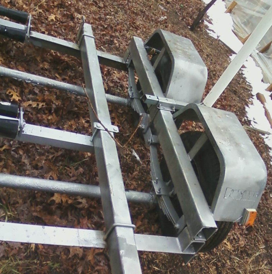

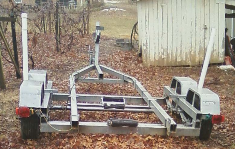

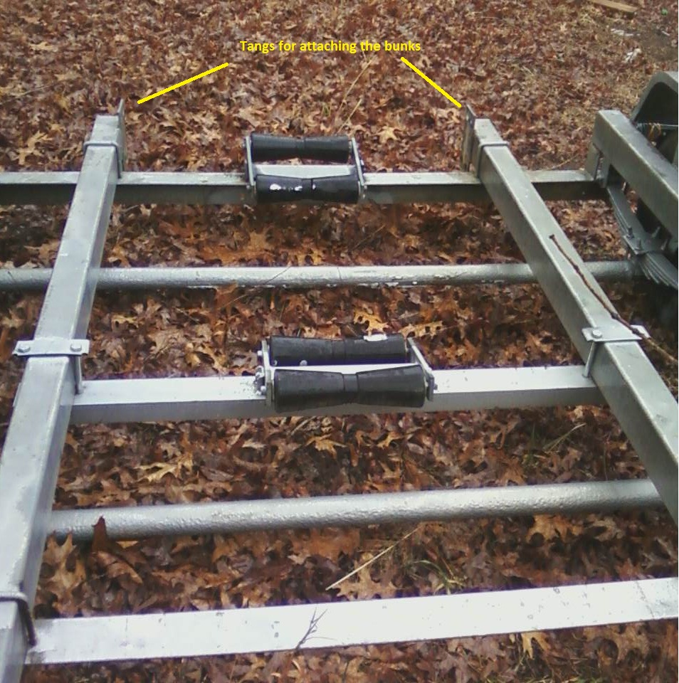

I've done this twice! Here is some pics of a trailer I got with a 19' seacraft with a blown Mercruiser for $400. I stripped off several cleats, a compas, a motor mount for a kicker etc.... then sold the hull for $100 to a grandpa who wanted a project to work on with his grandson. I had to knock some rust off the trailer and then painted it with cold galvanizing compound (Rustoleum), added a new winch and strap and new lights. I had to also remove the bunk mounts and then added new ones to fit my boat.
When you take what I originally paid plus materials to fit it to my needs , less what I recovered off the boat and the $100 for the sale of the hull. I'd say I got this trailer for about $200 and some sweat equity.
Alternatively you might want to think about using some cold galvanizing compound on your existing trailer and or add some zincs to the trailer to slow its degredation.

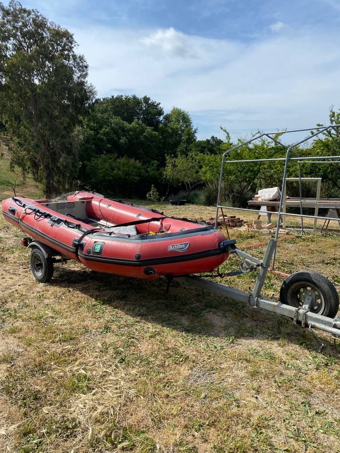

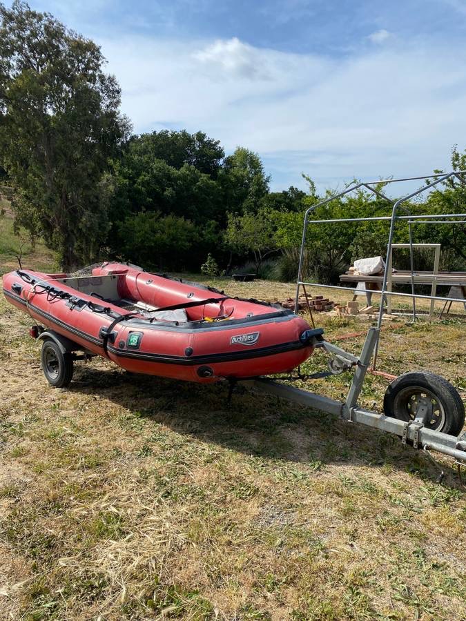

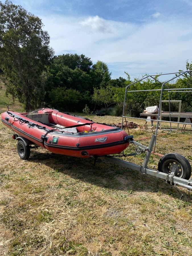

Not that any of you were on the edge of your seats on this one, but I figured I'd close the loop here as I ended up finding a solution this weekend.
I found this galvanized Pacific G14-1000 with a 1000lb capacity that I THINK will work. I need to buy another keel roller and a new bow stop before I can test it, plus I'm still waiting for some paint to dry. But, to the point of this thread, sure enough it ended up being cheaper to find one with a boat already on it. Luckily, said boat is a 14 foot Achilles RIB which I think I'll get some real use out of. Heading out from the Santa Cruz Harbor and getting a bit of near-shore fishing in sounds like a good way to spend a few hours. I'm a bit bummed not to have ended up with a Hobie, but I already have two small sailboats and really couldn't justify a third.
All in, this trailer/RIB was about $400 less than trailer-only options I was finding. The guy selling it didn't mention the fact that it was on a Galvanized trailer in the ad, and I'm convinced that is why no one snagged it before me.

My thought/hope is to repurpose my original Potter trailer for the RIB and my Mirror Dinghy. These are both relatively easily moved by hand (about 200-250 lbs) so swapping them is significantly easier than the Potter, which I hope to keep permanently on the galvanized trailer. The Mirror won't often go in salt water and the RIB can be launched without fully dunking the trailer. Also, since I can more easily keep the boats off the trailer, I should be able to maintain it more easily and keep it coated in the cold galvanizing paint from Rustoleum.
Or...I could go buy the 14' lightweight galvanized trailer and 12' Aluminum boat down the street for $500, then sell the aluminum boat on my old Potter trailer and keep the galvanized trailer for the RIB and Mirror. But I think that might be pushing my wife's patience :)
