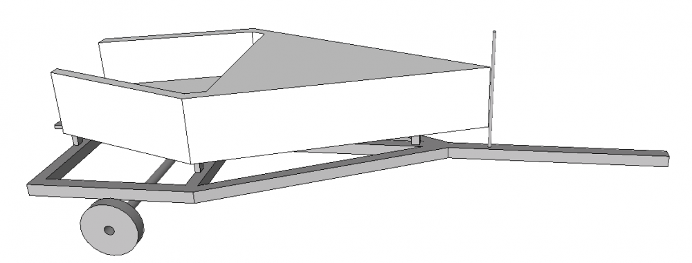

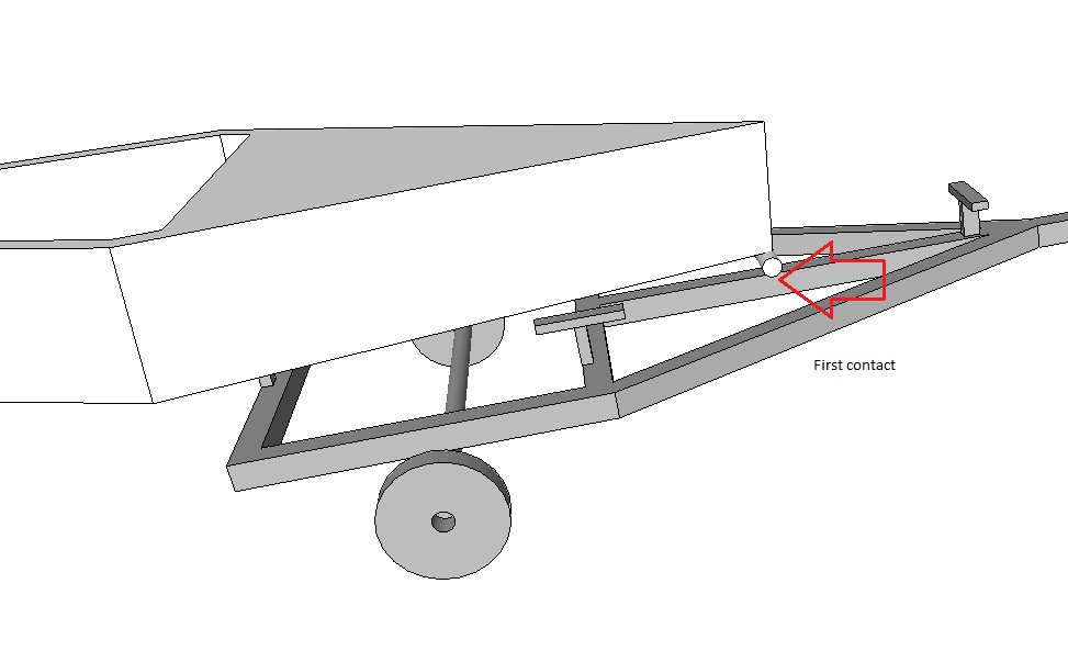

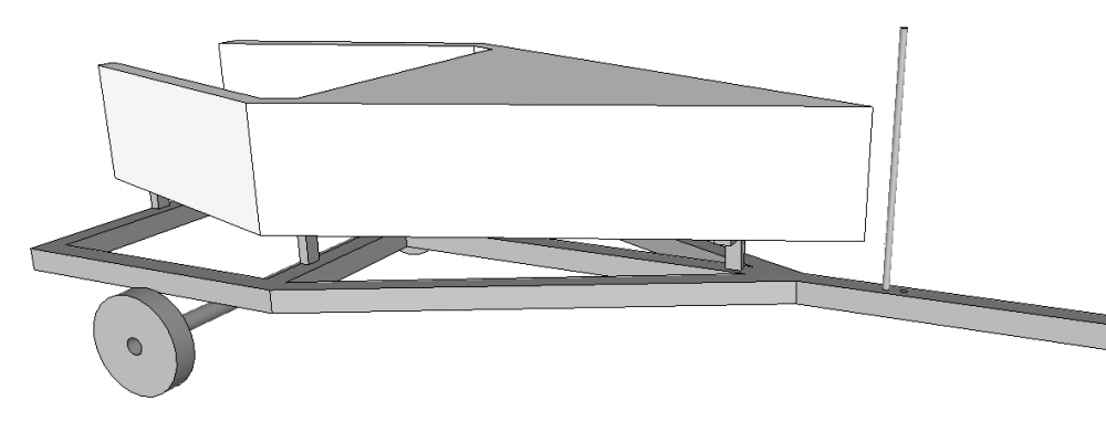

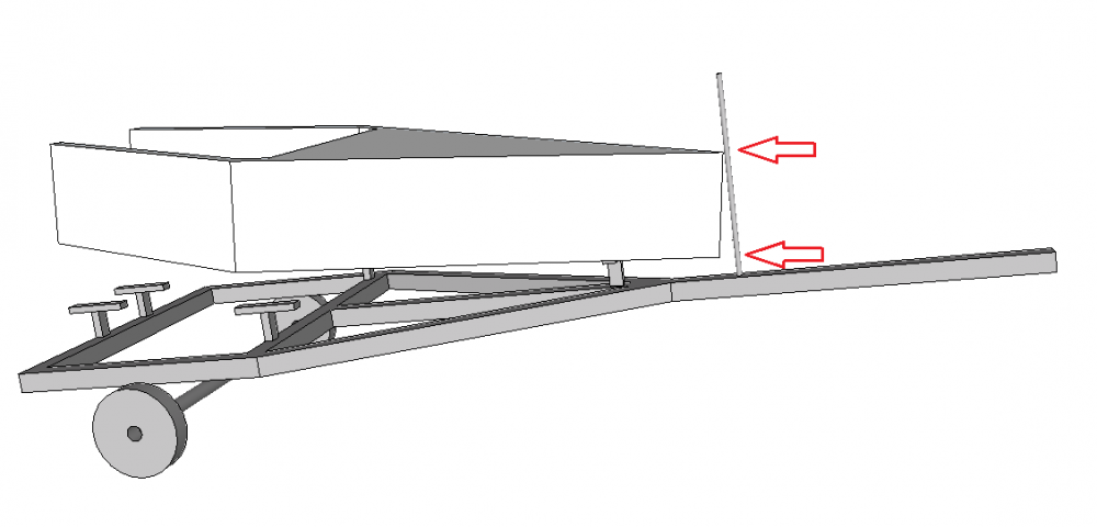

This is what's going on, no?
You bring home from store and the boat fits perfect against the stop.
At the boat ramp the level boat is making contact with trailer stop at ramp angle.
You pull the boat out of the ramp and there is a gap. The top part of bow rotates away from the stop.
This is an exaggerated example, but this happens to me all the time too. The best solution for a boat without a keel is to barely soak the aft bunks, then pull the boat out of the water unto the dry bunks bunk, like a powerboat. By the time the boat is at the bow stop it should be just floating at the rear bunks or not at all floating.
Here's the rub. The bow and a couple feet back is going to have to drag on the front dry bunk(s) for a long distance. That's a lot of distance to have sand or mangrove seeds rolling between the bunks and hull.
I think the solution is some combination of
1) Raise rear bunks, lower front bunks
2) Place a keel roller where the bow would contact the trailer when loading, then a keel roller (instead of a carpet) for the bow near the bow stop.
This would let you back up the trailer to wet the rear bunks, pull boat to winch. When the bow makes contact with the front bow roller or bunk it will lift off the secondary keel roller. By the time the boat is at the winch it would be the same angle as the trailer.

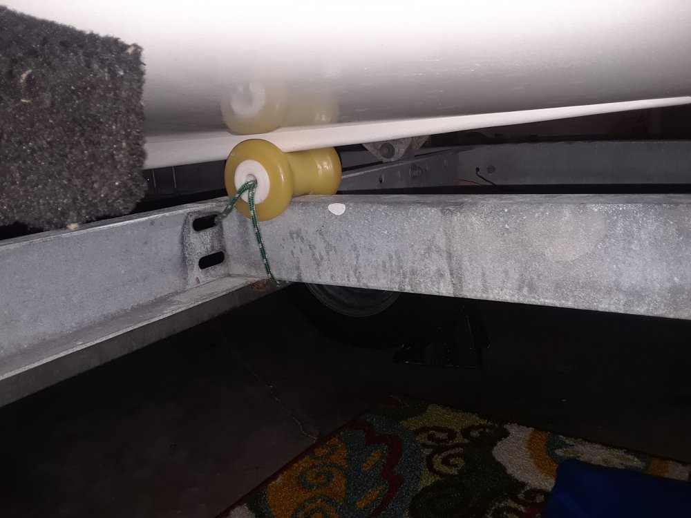

Speaking of that...
The 170 i have has a wieghted centerboard. I didnt like the idea of the rigging holding that suspended while bouncing all over the road.
I used to have 4 inch keel roller under the bow repkacing the carpet bunk. When i didnt like it there i instead repurposed it to a centerboad rest. This also lets me remove the centerboard without damaging the leading edge on the horizontal cross-member.
It does not roll, but that is ok. The rope is redneck. I check that often and ontend to find a perm solution.
