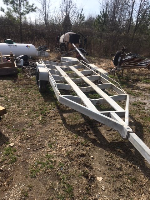

i finally settled on buying a used trailer and modifing it. this made me feel a little more optimistic about the outcome, but did nothing to solve my upright placement issue. i thought maybe if i could get a lines plan for the hull, i might be able to use it to loft full scale templates of hull sections.

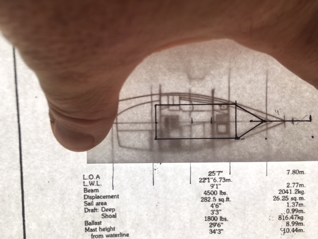

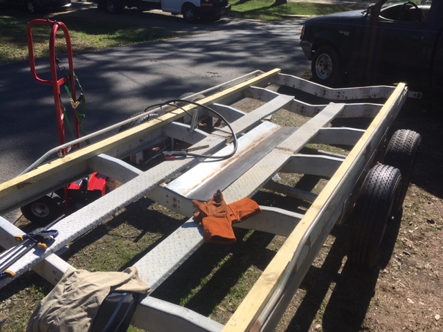

so the trailer is 21' x 6'. i printed the spec sheet on the hunter model, and used it to make a scaled version of my trailer, that I drew on a small piece of paper and then superimposed it over the hunter spec sheet, to figure where to place my axles and the keel cradle. i wanted the keel to sit directly over the axles.

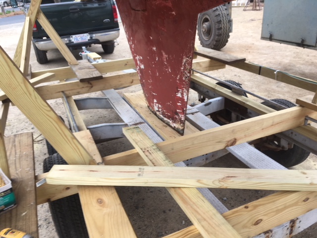

after getting my axles moved, i then welded two 1/4" x 6" flat stock pieces directy to the frame, spaning three cross members. it was 54" long. i then drilled six holes in the two pieces and bolted treated 2 x 6s to them.

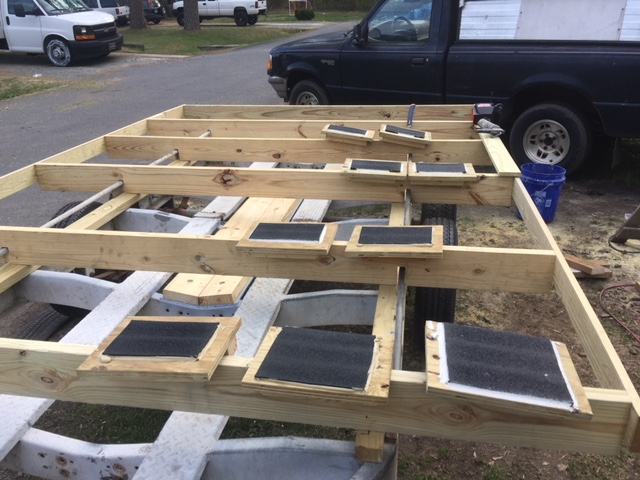

i drilled several holes in the top portion of the longitudinals of the trailer frame and bolted a 2" x 4" flat to it. i used it like a sill plate to build a 2" x 6" frame from. similar to building a deck.
i replaced the coupler and lights, and then scheduled the big lift.

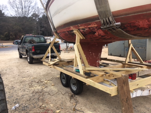

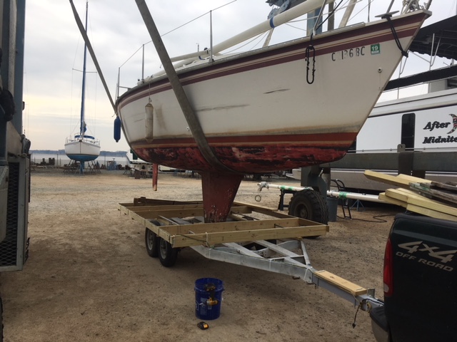

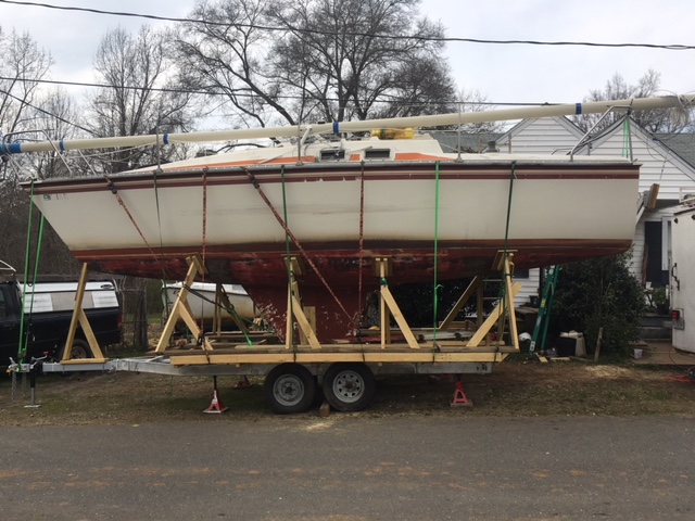

it was lifted out and set on the keel cradle. the lift operator leveled it and left it to me. i used scrap wood to "deck" a few areas where i need my uprights to go or their braces. i used treated 2" x 4" for uprights and bracing, and pads i had made earlier.

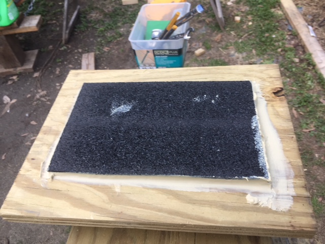

the pads were made from 3/4" treated plywood with pieces of rubber door mat glued to it. the porous texture of the door mat top adhered perfectly with adhesive and the bottom of the door mat held fast to the hull. on the bottom side of the pad, i fastened two strips of scrap wood spaced just wider than a 2 x 4.
it worked well. I made it the 18 miles from the marina to my house and the boat is still standing now.

what I didn't plan on was the boat weighing 6000lbs. I guess the extra weight came from gear, which wasn't much, and osmotic water intrusion. the bottom is covering with blisters.
so know I'm at approximately 7500, which was not cool. I didn't realize how bad it was until I got on the road. it was awful. I couldn't go over 30. anything faster than that, and it would start snaking violently.
so if that wasn't bad enough, the weight distribution is to far aft, also. again I didn't realize this till later, when I went to decouple at home. fortunately, I left the safety chains hooked up when I did this, because the front of the trailer rose. not gently either. the chains stopped the trailer back from bottoming out completely. it has negative tongue weight. I have to jack the back of the trailer to get the front to lower on my ball.

Honestly, looking at the photos, I think you got lucky. I would not trust that structure to go bouncing down the road with that much weight on it for any distance at all. It should be steel and, really, the weight is not supposed to be a point load. A "real" trailer is designed so that you can float the boat onto it. In other words, the keel does not touch at the bottom.
