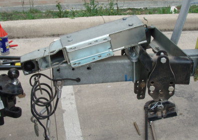

Drazlou,
If you look at the video when I am checking the fluid level you can see my coupler (surge box). Also in the photo below. The parts that move in and out to actuate the system are inside a box and held in place by 4 metal dowel pins with snap rings on each side. You can see them below. There is no way to tighten them and prevent movement.
The bolts that mount the system to the tong of the trailer are under the box. There are no bolts that can be tightened that could limit the movement of the surge mechanism.
