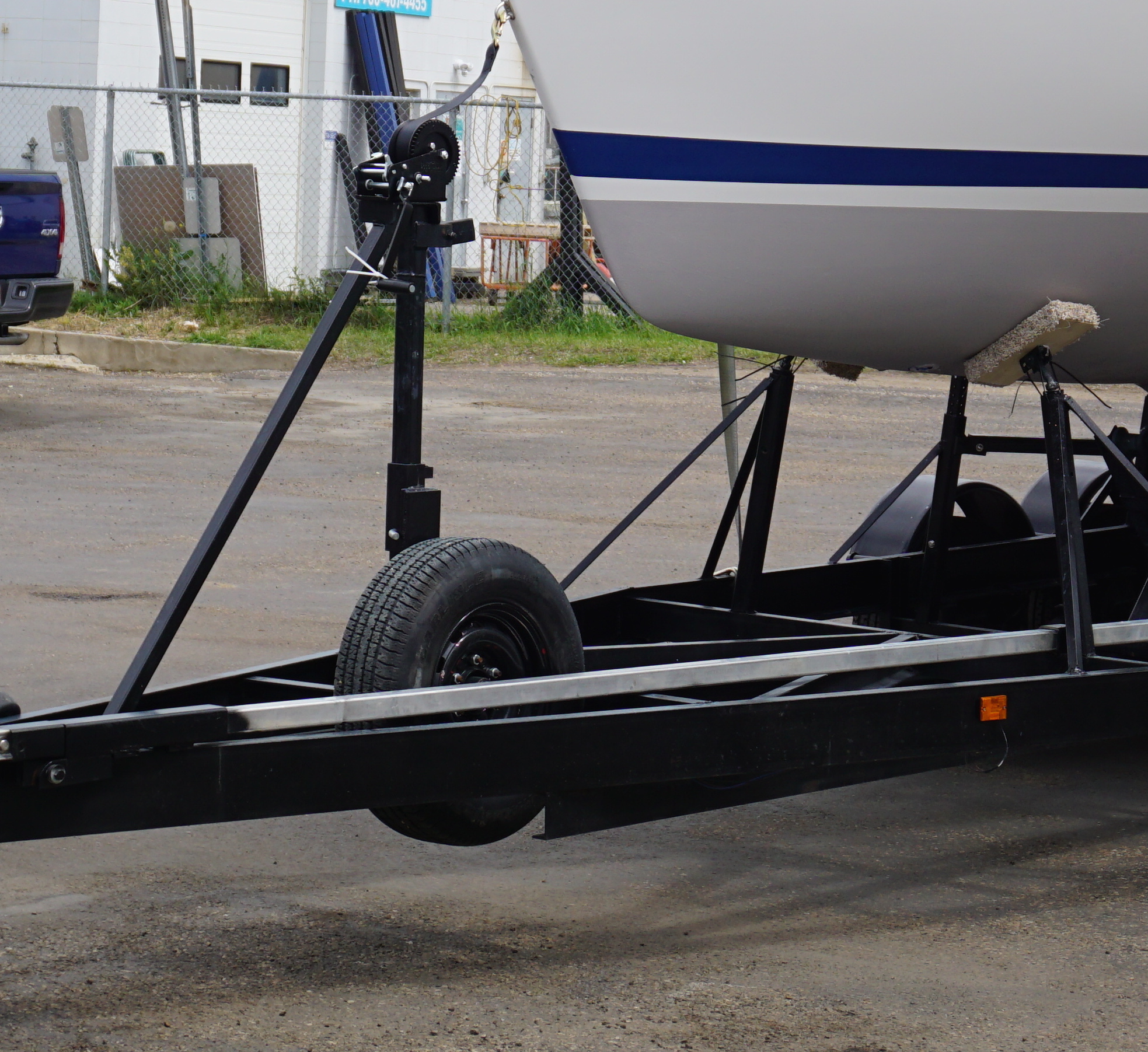

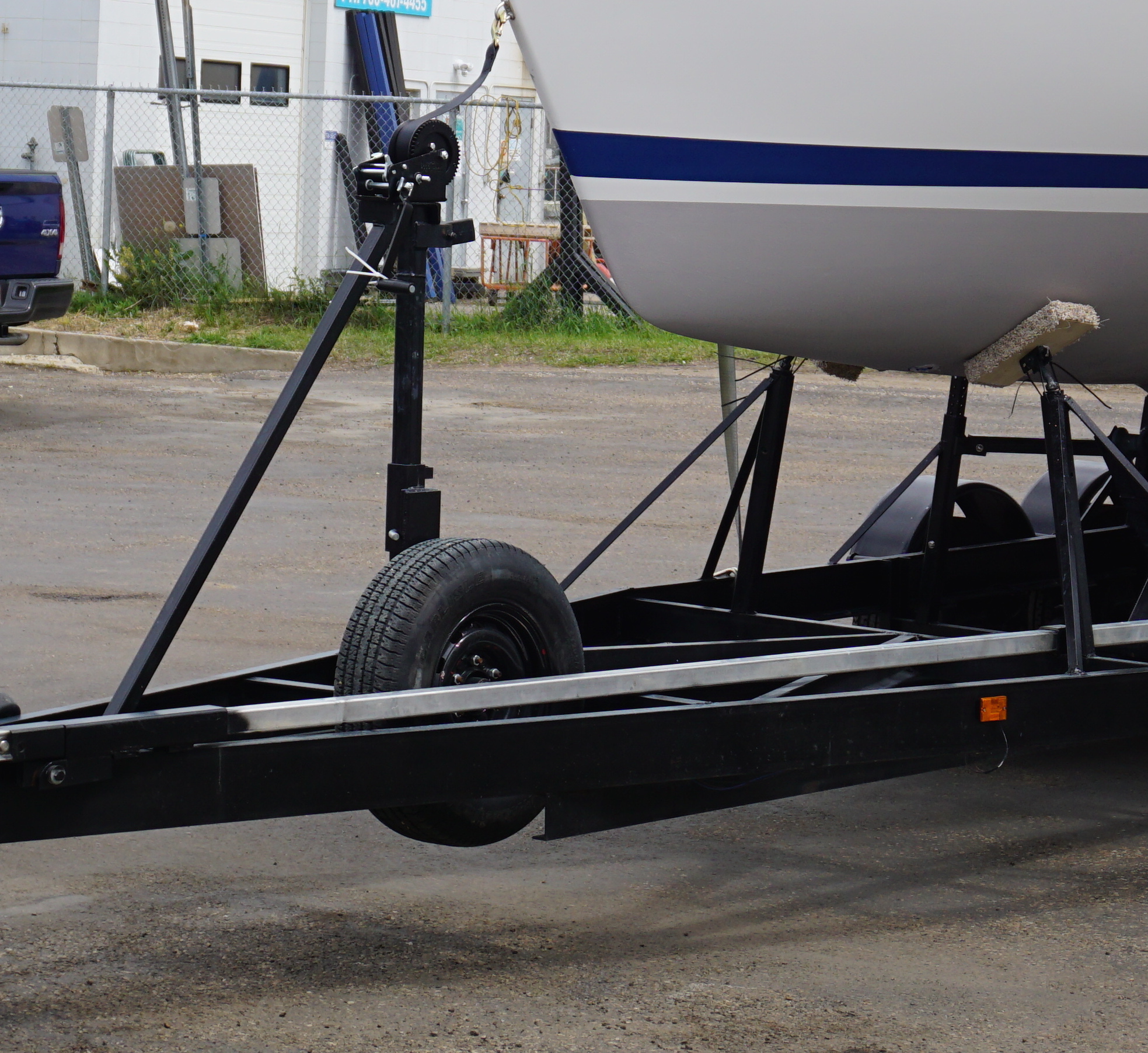

Here's an alternative, the "spare" is also the dolly wheel. There's a collar that allows it to slide up and down the post, and there's two hitch pin holes that hold it either up or down. The winch is used to raise and lower it.
Quite simple and it works well.
