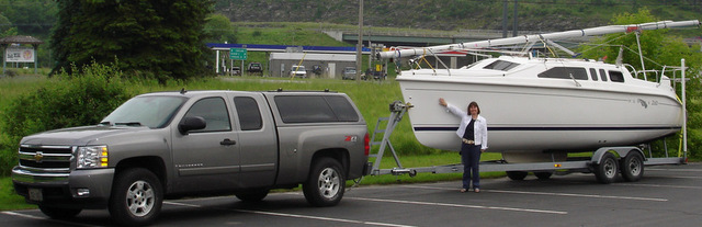

I have towed our 260 through the Rockies, across the prairies and around the Great Lakes with a 1/2ton rated to tow 8800lbs. It really worked hard through the mountains, but even with smaller hillls, with family and gear I wouldn't have wanted to have much less capability. I also have surge brakes on both axles.
