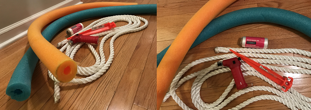

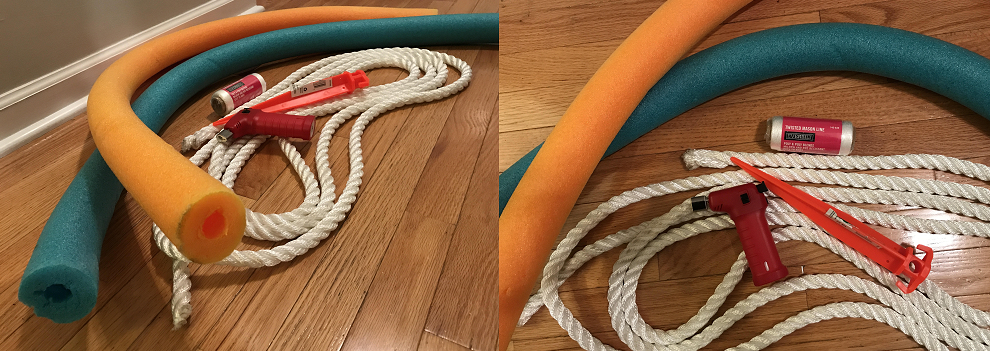

I don't think it will be hard to scale up. I just went to Home Despot and got some 3/4" nylon twist and some small stuff for siezing. I also picked up a plastic stake to use as a marlin spike. I also got my swim noogles out of the storage locker and plan to cut them to about 2'.
I don't know if I will get to it tonight but when I do, I'll take measurements and post the results here.

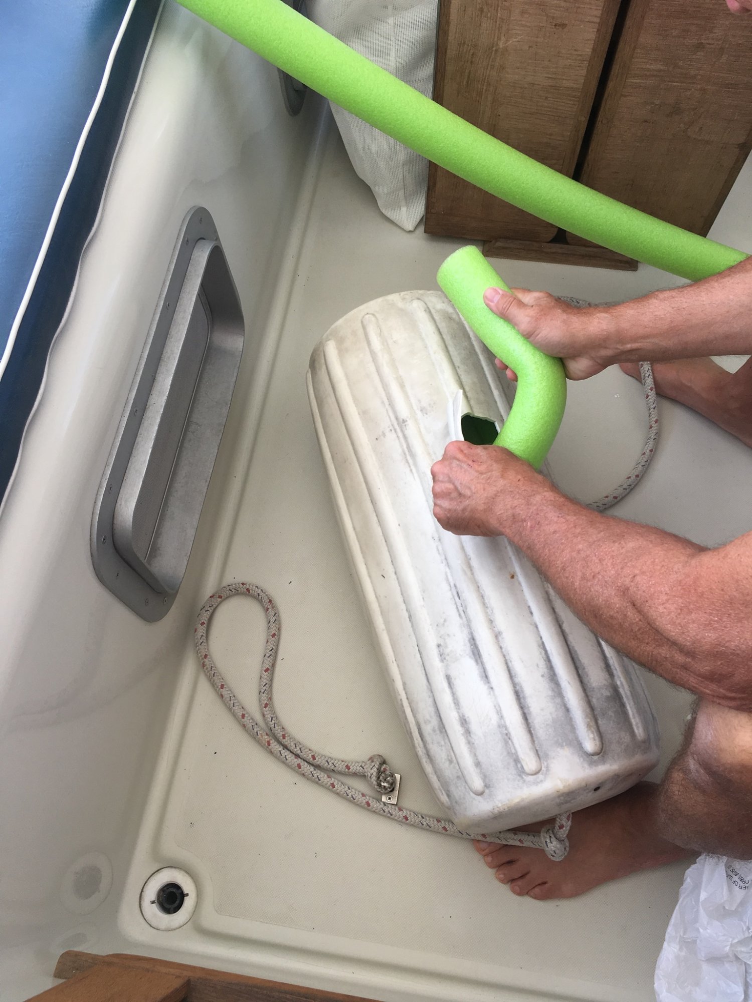

Years ago I filled an old fender with noodles and had used it for certain docks. It seemed to compress during high winds a bit more than I thought I liked, but the flat side helped hold it in place. I still keep it for pilings that are a bit rough. I’ve also added another noodle inside for more rigidity.
