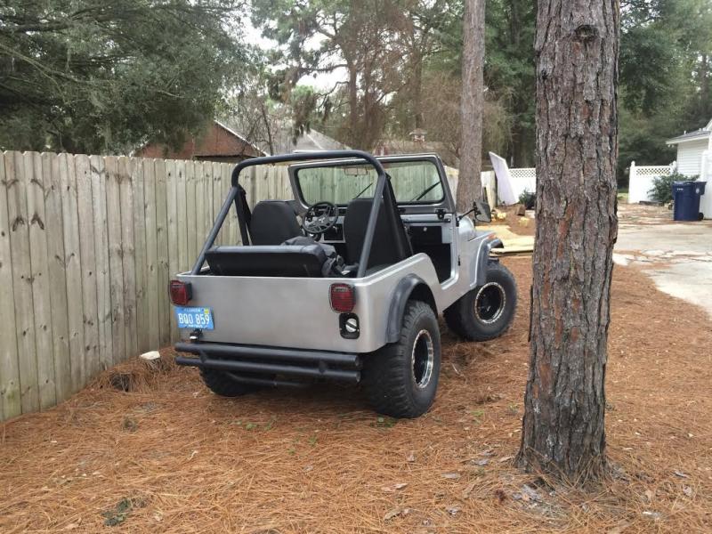

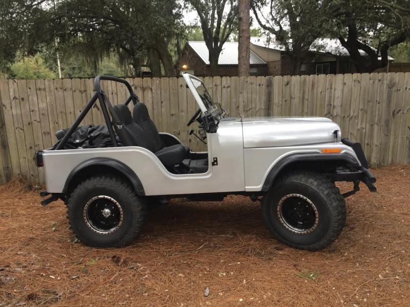

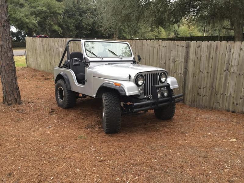

I've attached a few pictures of my jeep just for fun.
