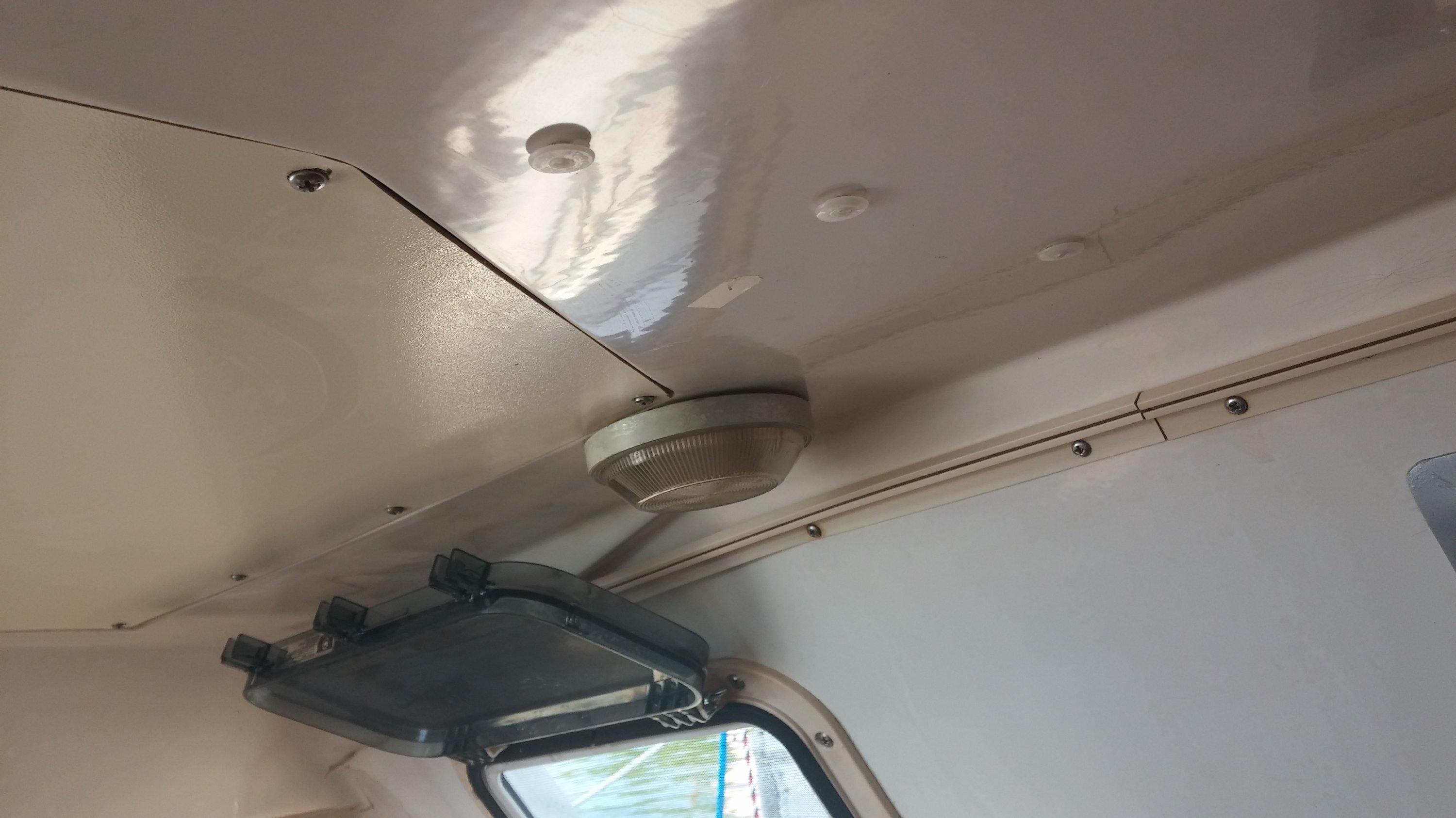

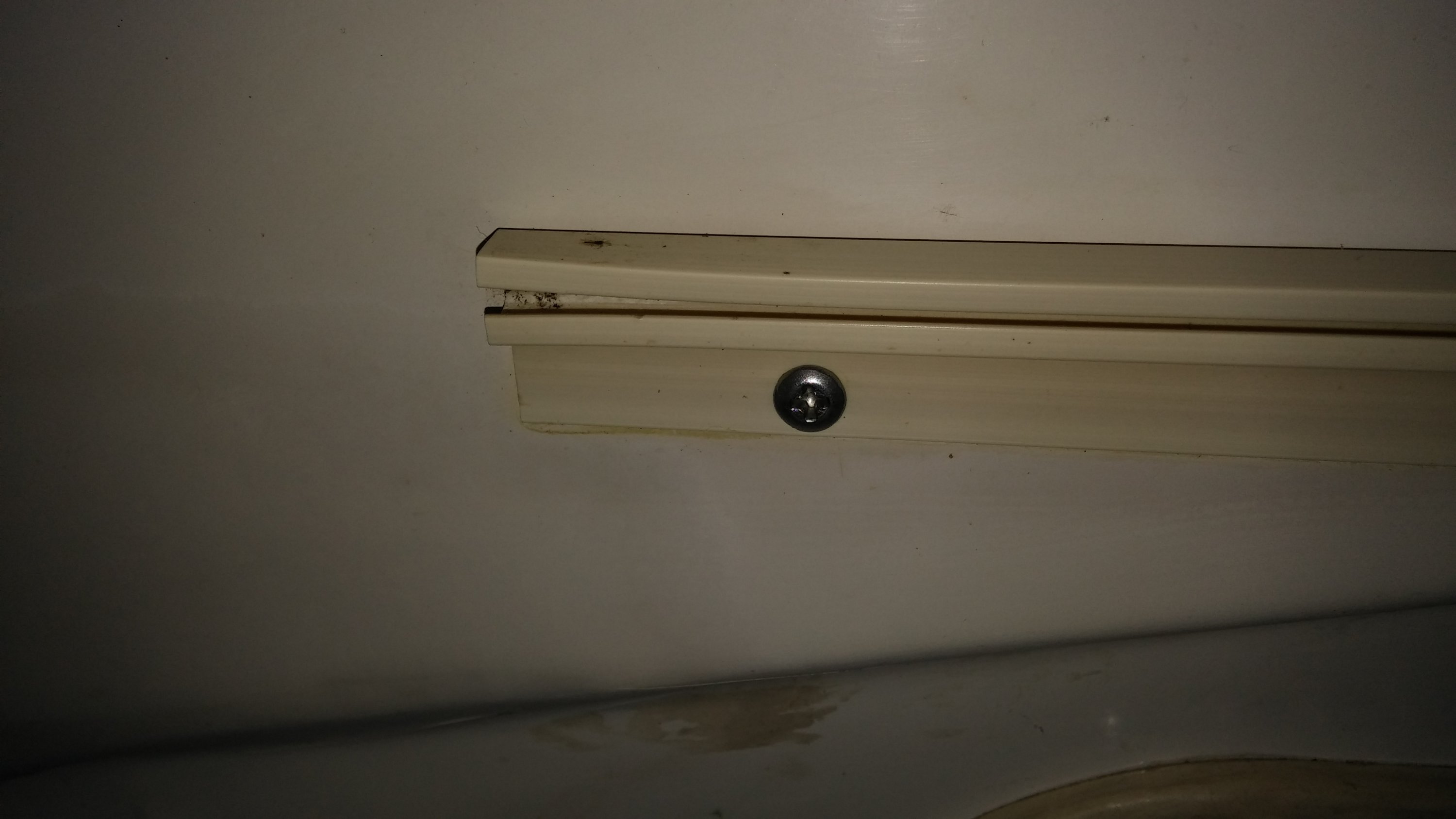

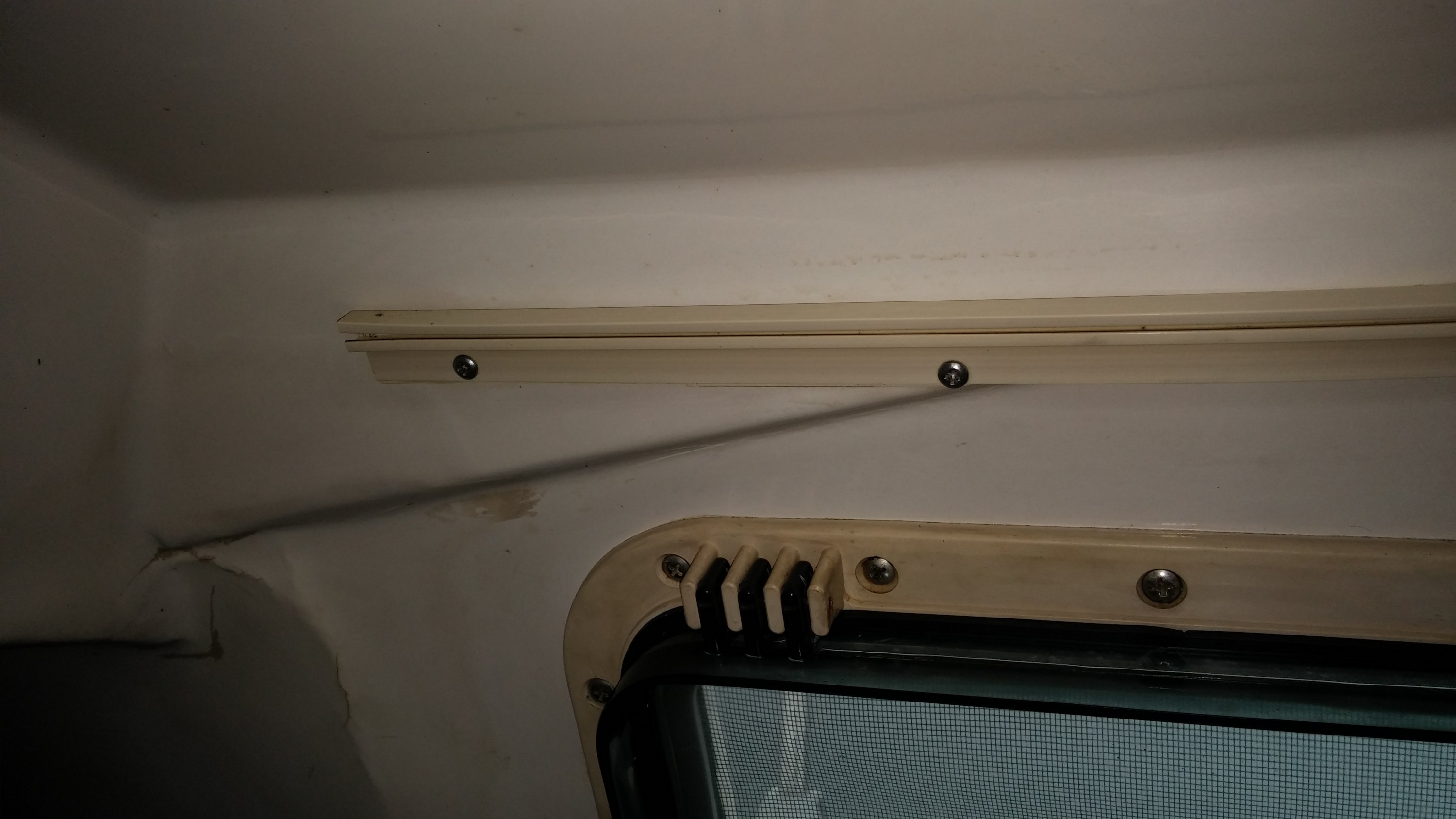

I have these tracks (pictured) that run the length of my main salon (1983 H31) above the windows. Am I correct in assuming they hold some kind of sliding hardware that is used to hold up curtains for the portlights?
If so, where do I get the sliding hanger hardware? The admiral want her curtains up.
If these tracks are not for curtain hangers, what are they for?

Those are definitely curtain slides. I remember installing some like that in 1979 inside my Spirit 23 sailboat. The slider looks like a mini-sail slug.. a little loop sticks through the slot. Ya sew the curtain to the loop.. I don't know if they are still available, but search around Sailrite and ya might find something.. There really needs to be a bottom set as well, otherwise the curtains hang vertically away from the slanted cabin sides and look kinda strange.
EDIT: I think these are the ones.. http://www.easternmarine.com/sliding-eye-curtain-carrier-type-c-14-pack-81305

Our C22 has tracks very similar to those. The Albin Vega has skinny little aluminum rods (for which I will soon need new mounts).
Not sure where to buy these things, but I have a feeling an RV supply website might be where I'd look first.

I looked at the sailrite site, and got excited about a particular item, but the part that goes into the slide is 0.2 inches in one dimension, which is about 5 mm. That looks huge (on a ruler) compared to the gap in the slide. I'll call tomorrow to ask about whether that section of the part is round, or slimmer in another dimension.

go to any RV sales/parts store.. they will have the sliders, or will be able to get the size/style you need.

Ray, those are indeed curtain tracks. I have them on my '83, the ones posted by Kloudie look like the ones I have. My boat is at the yard getting a botttom job right now, but I can send pictures next week if that's helpful.
